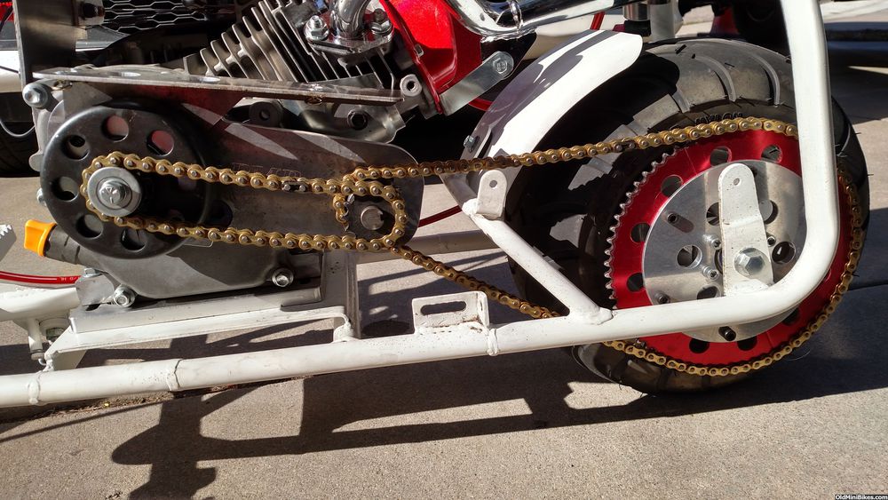

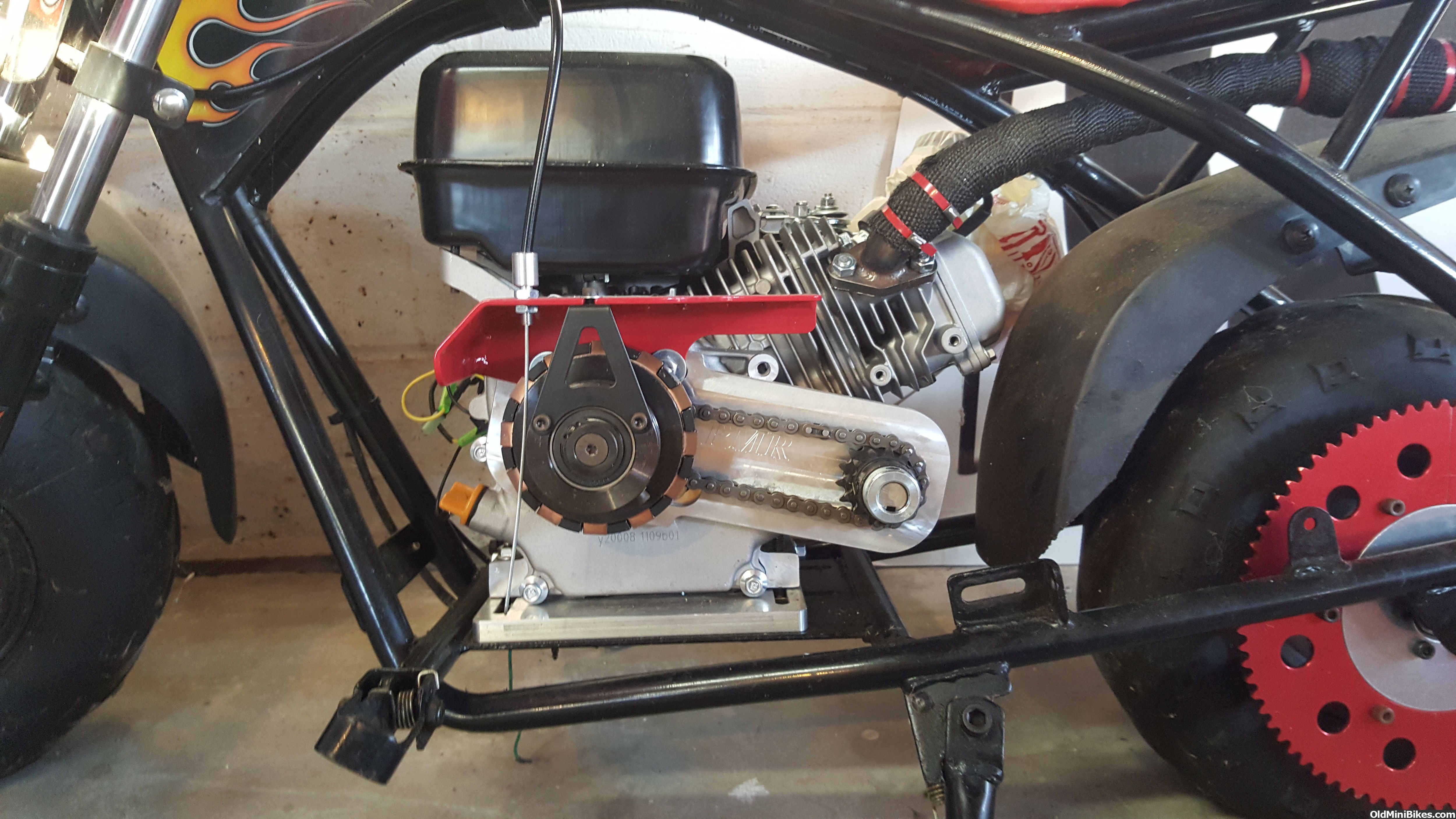

I may be wrong, but, the only purpose I see for the PMR jackshaft is when your desired ratio can not be achieved with two sprockets. For example, you have a small engine with insufficient power but your rear sprocket is as large as you can run without grounding it and your clutch sprocket is the smallest available. Since the jackshaft cost as much as a 212 Predator, the jackshaft doesn't make sense for that scenario, IMO; just swap the engine. The only other scenario I can imagine would be if you were going for more top speed and your clutch sprocket is the largest available and the rear sprocket is the smallest available. I've seen 19t clutch sprockets and 53t (#35) split wheel sprockets (a combination that would result in a 2.789:1 ratio) so I can't imagine that being a need. I may be missing something; I'm sure someone will inform me if there are other purposes for the jackshaft.
