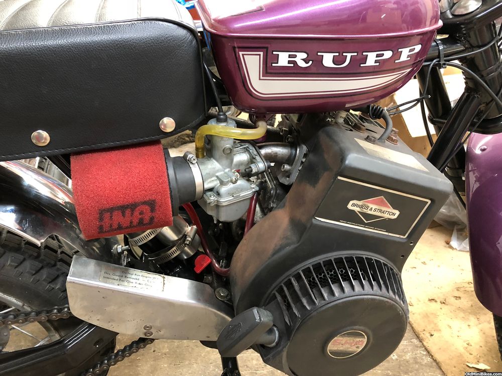

You will probably have make an intake like the one pictured here. Rupp's have angled engine mounting plates and didn't with Briggs engines on this type of frame. There just isn't room to mount a Briggs gas tank and carb.
Here is a 22 Mikuni, on a old 5 hp Briggs, on a Rupp. Something you won't see every day :)

Here is a picture of the Rupp, I finally found a way to post it.
I was "told" the intake was bought from a place in Dearborn Heights Michigan called Studz Hardware, but can't be sure. It is specifically made for a Briggs on a Rupp with a slanted engine and a Mikuni carb. It fits well.
