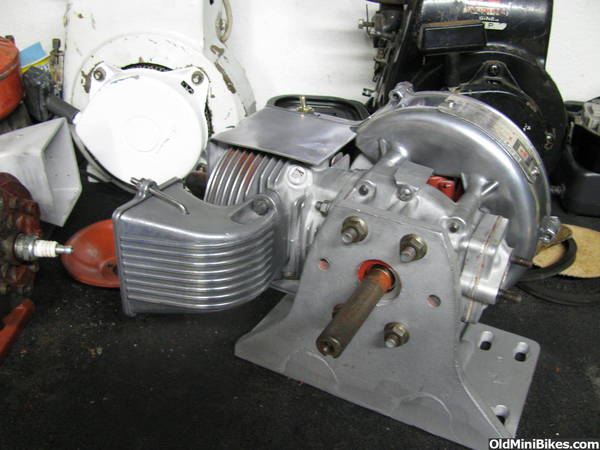

Picked up a pair of Tec/PP AH61's today. I thought they may have been off a twin kart but they are both the same clockwise rotation (they are mounted differently on the mounts is all) I would guess that maybe one was a backup/spare or something to that effect.
They both have great compression and smooth rotation, and both have spark :thumbsup: Feel a lot lighter than my west bends as well.
Dunno much about them other than they are 6.1 c.i.d, I would like to find some seals and gaskets if I can if anyone knows of parts listing or supplier than may have anything :shrug:maybe see if one will fit on my Mystery bike that has the west bend on it right now.

Oh well, they are cleaning up nice though, I glass beaded the exhausts along with some other parts. Got both of them tore down to longblocks to inspect and clean up, I dont want to split them open till I can find some gaskets though! They both look good thankfully, and there was not heavy/sticky buildup so I think they are runable as is....well when I put them back together :laugh:

Shined one up a little :pimp:
The tilly is in the carb cleaner, It actually was clean and not gummed up but since I had it apart.... I have to dig out some gasket material tommorow and try to make one for the reed plate to block and one for the header, I also have to load the pull start. If all that goes well maybe I can try to start it tommorow :thumbsup:

hey, It actually runs :thumbsup: I obliterated a cork gasket I made for the muff right off the bat so there is really nothing there in the video (Its all I had for gasket material). strill needs a few tweaks on the screws but its gettin' there!
