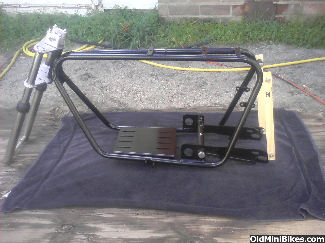

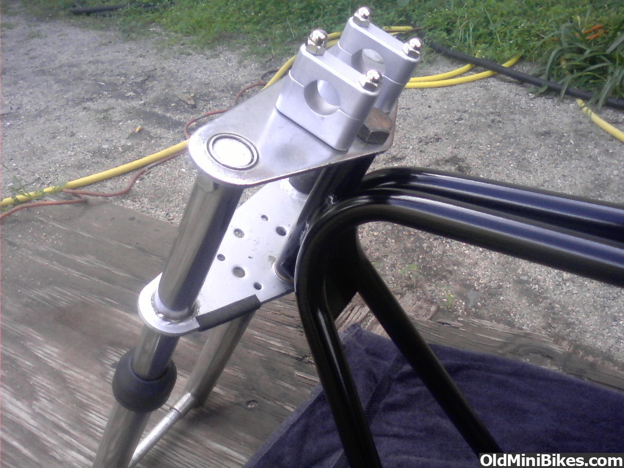

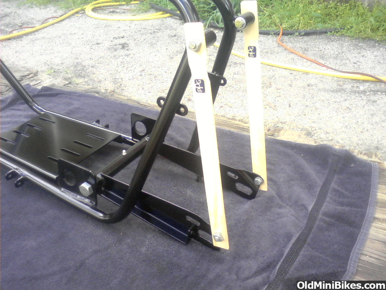

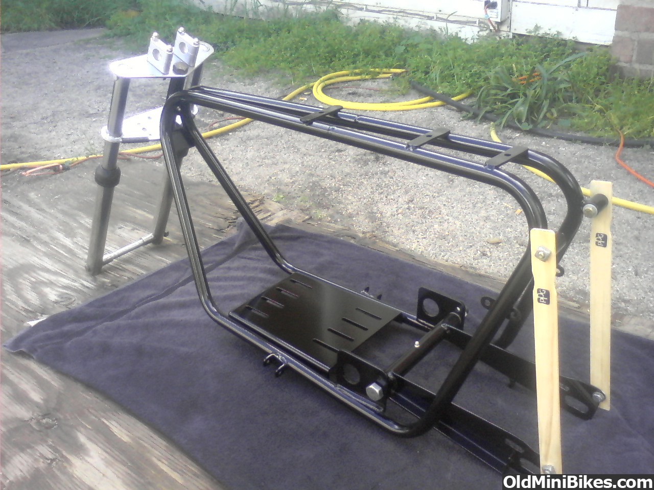

Started with a frame that needed some work. Needed the neck cut off and a new motor plate was added. The frame is painted Satin Black. I had a swing arm but it was the wrong one for the bike so I modified it to fit. New zerk fittings were installed. The proper swing arm shaft will replace the bolt that is in the pics. More pics of some progress soon.

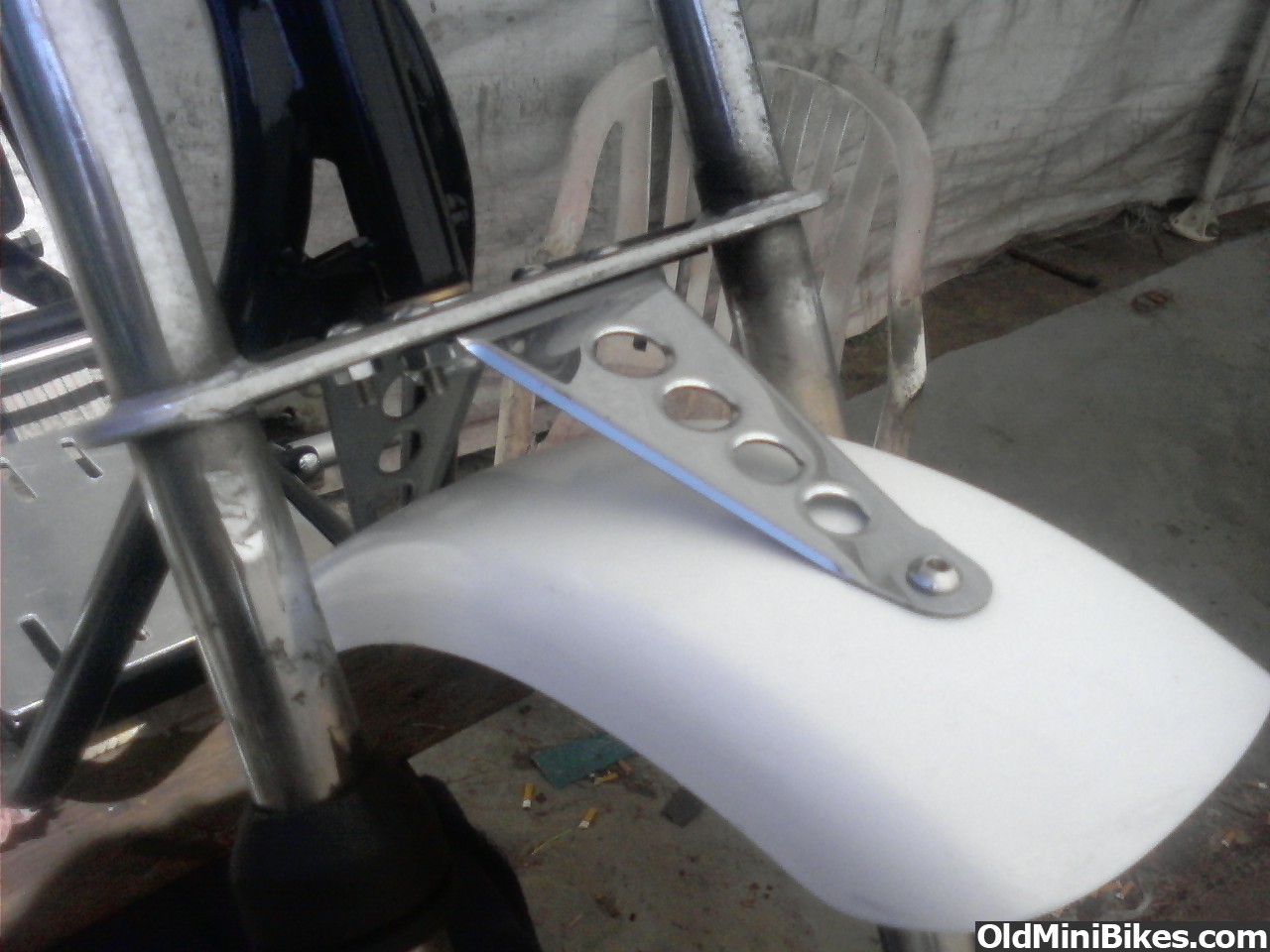

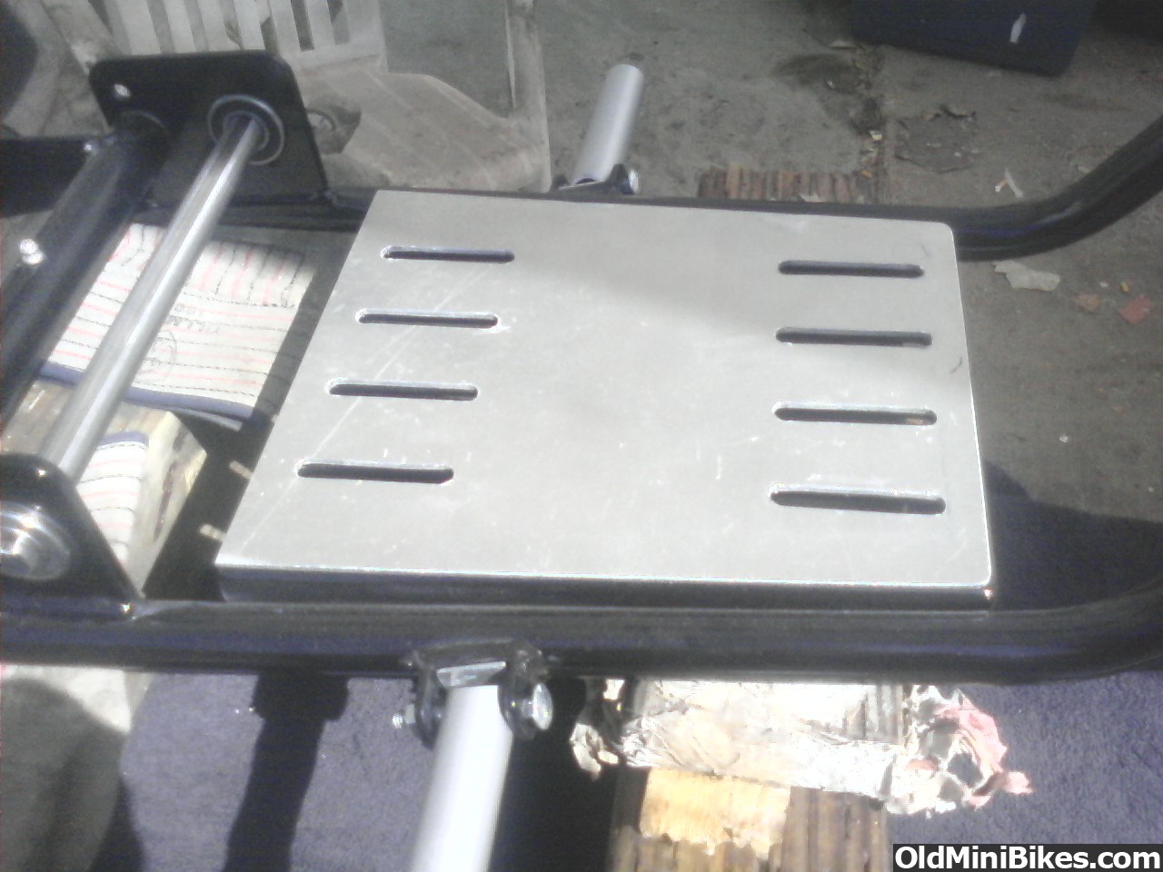

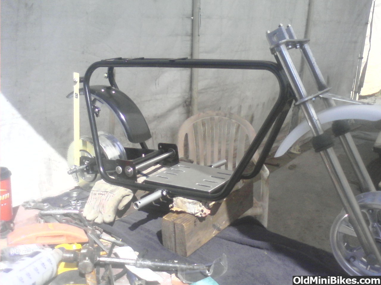

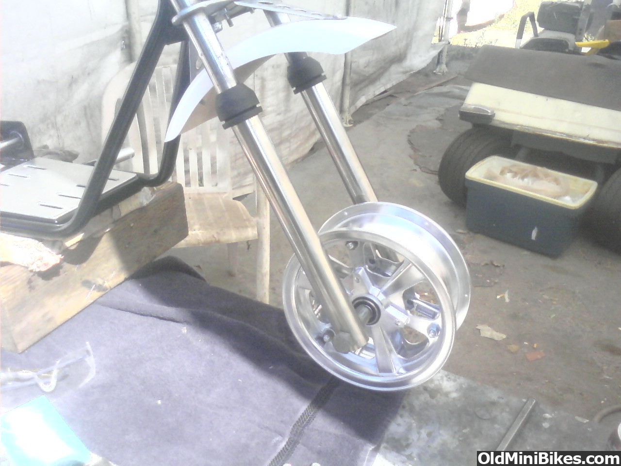

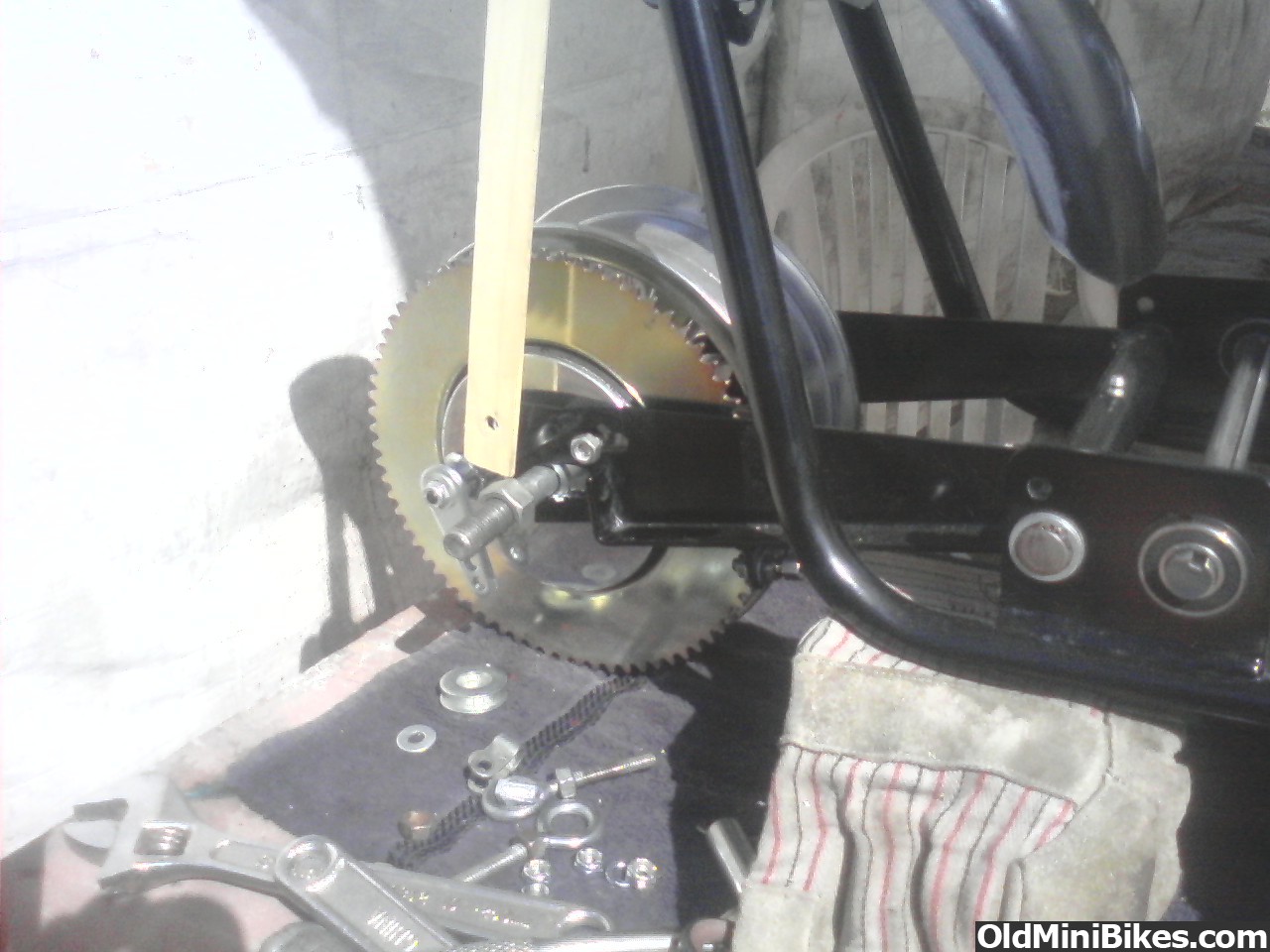

Had some extra fiberglass laying around so I made some fenders. The front bracket is an NOS Bonanza bracket and the rear bracket is from OldMiniBikes. The rear brake plate was an NOS Bonanza and I polished it. The wheels are Azusa 8" spinners I had for awhile now. I made a top motor plate cover out of aluminum so sliding the motor back and forth won't scratch the paint. (still needs to be polished) Gaurdrail Dave had an extra sprocket so I nade a deal with him to get it.
That's about it for now. Tank and seat pan are next on the list !
