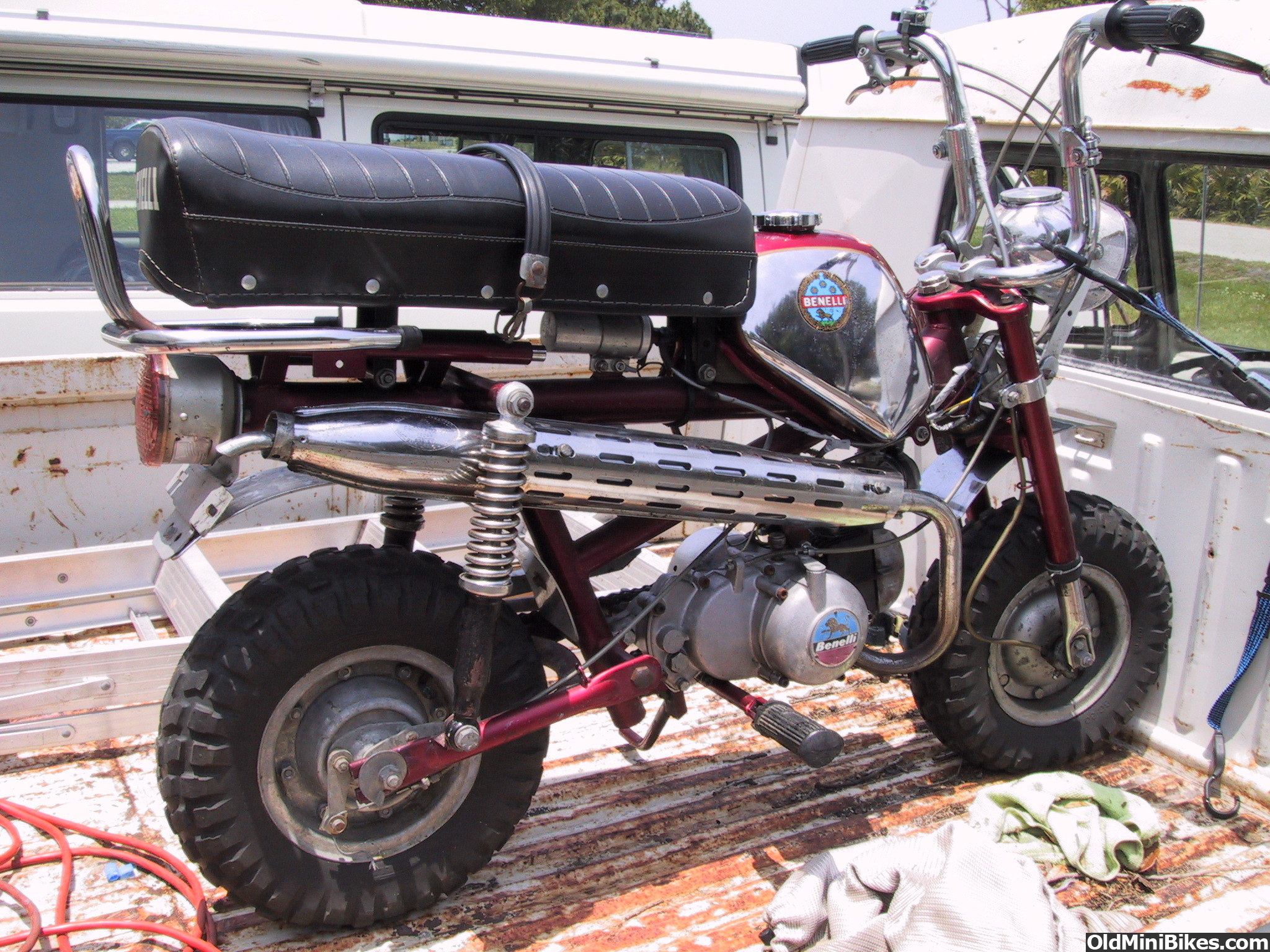

another important thing on these is the tail light bulb needs to be in place for the bike to run, it sort of completes the circut so if its bad or not there no spark. so along with cleaning the points etc., clean the wiring grounds/connections and the bulb and socket.
