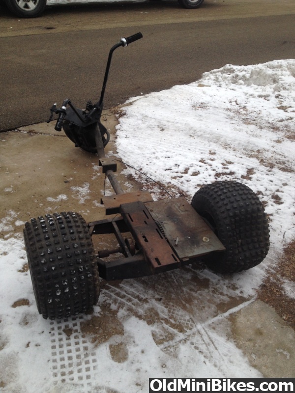

Hi over the last year I've been slowly able to work on my
BGW tri rod so I figured now that I have a little more time and most parts I'd put up a thread.
Here are the pics I have so far

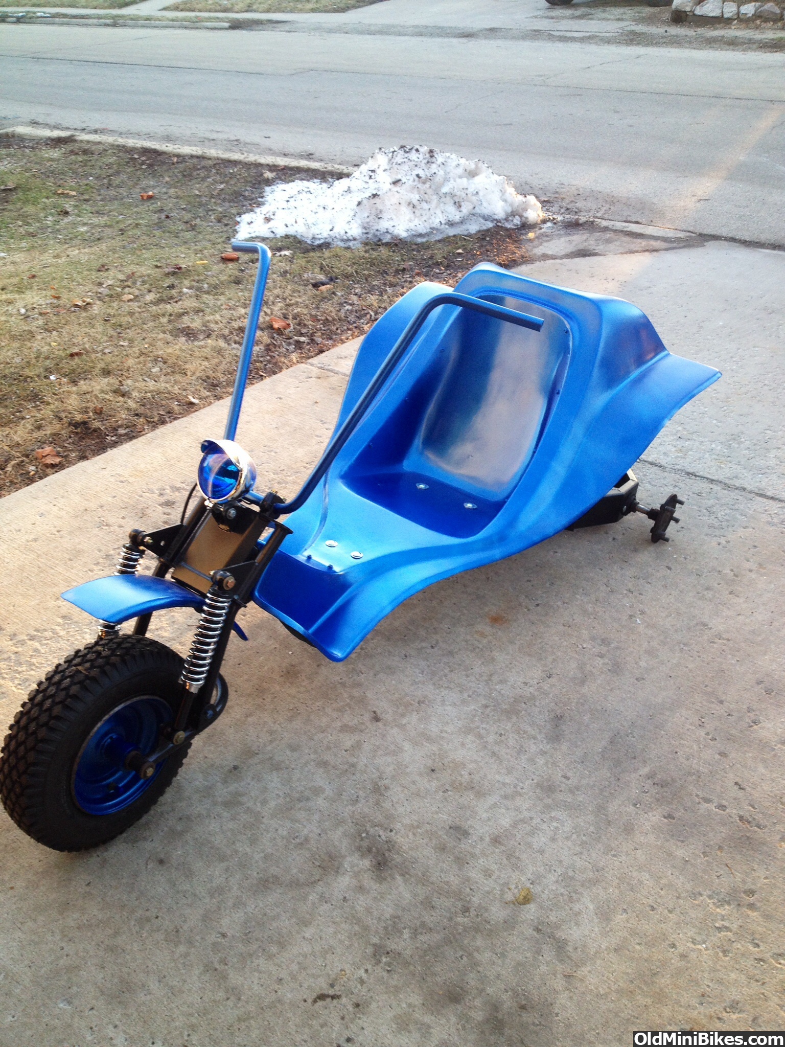

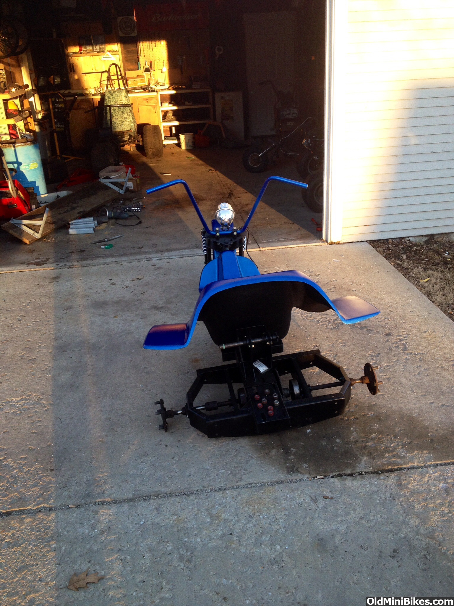

I sanded down frame, shot primer then 2 coats of gloss black. The seat I smoothed with a fiberglass/plastic filler (don't remember exactly what right now) and sanded smooth. Then I shot it with primer and 2 coats of Metal Specs blue and 2 coats of clear. Ordered a blue tinted headlight and slapped a 420cc 13 hp Predator engine on it and painted some parts blue (that pic isn't the best inthe garage).

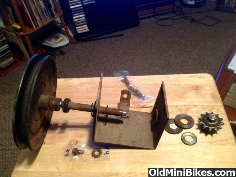

So here's my current hang-up..I'd replaced the jackshaft when I got the mount, it was 3/4" jackshaft. So now that I got engine on it, i noticed jackshaft was too short and noticed that the comet torque converter kits were made for a 5/8" jackshaft so I bought a longer 5/8" jackshaft w/o noticing the old one was 3/4". Now I see you can get TCs with a 3/4 driven pulley but they don't look like sets with the hardware.
Should I use the 5/8" jackshaft with a TC kit or use the bigger 3/4 jackshaft and just get the other TC that's not a kit?!?

I'll take a look at that link. I still gotta get 5/8 bearings if I go with that jackshaft and I would think they'd work but wasn't sure if since it was a 3/4 jackshaft originally if a 5/8 would be too weak. I'll try I get some better pics
Also wasn't sure if I should go with a torque converter kit or jus buy the driver, driven, and belt since I wasn't sure if cover would still it or if I'd need the plate that comes in the kit
The T555's use a 5/8" jackshaft with no issues. The Tav with backing plate would not be what I would use. The shaft sticking out the back of the plate to run the sprocket to the chain would be unsupported. Best scenario would be to use a 40 series with that engine(1" shaft on engine,correct)? Then to the 3/4" driven. I would be worried about the driven spring on a 30 series coming unwound.

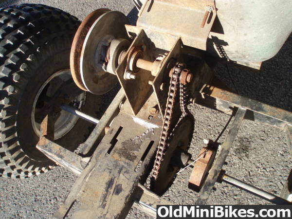

Yeah was jus driving the streets in a small town. I'd taken the 212cc off my TS-110 jus to see how the trike ran and jackshaft snapped. I believe it was from a blown out or missing bearing as I didn't look it over at all before slapping the engine on n hammering the throttle hahaha here's the few pics I have

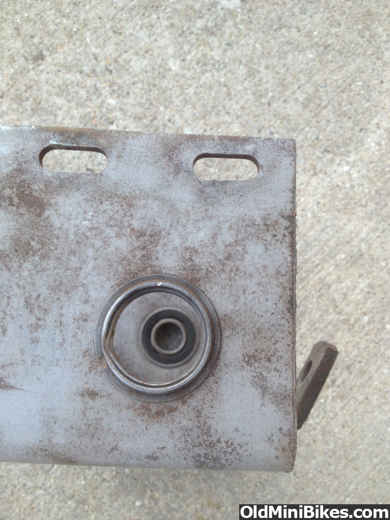

Got my new torque converter in. Put new jackshaft in mount , it has some movement , side to side, doesn't seem right, I bought new flangettes and and still the same, kinda baffled. Maybe could be the paint on the mount being too thick?? Anyone have any ideas? Once this is figured out I have everything I need to mount it and finish except battery and a belt! image.jpg
Are you saying the bearings are moving side to side in the flangettes? I think it is because you have to put the flangettes on the bearing then up against one side of the mount. You have a bearing flangette on each side of the mount.
