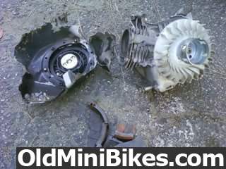

Man that would have been an unpleasant experience. $200.00 for a billet flywheel and rod sure beats the cost of new pants and underwear, and a trip to the emergency room.
