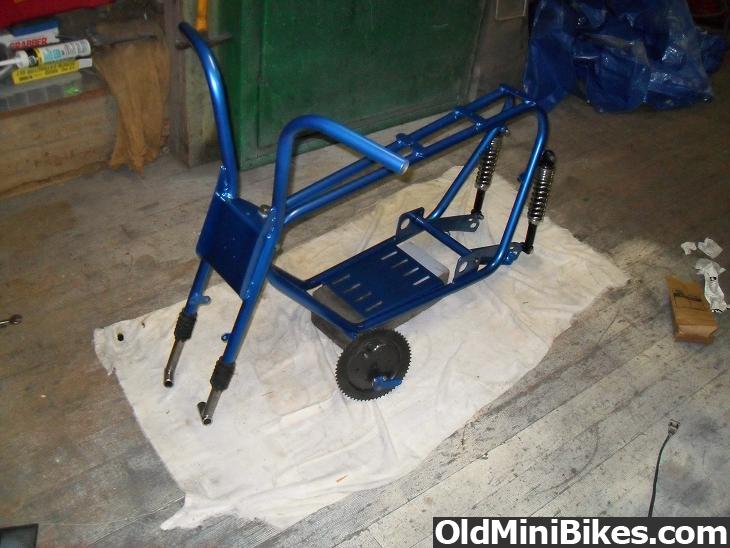

I painted the frame my self. I used The duplicolor Ultra marine blue metallic and High temp ceramic clear. The clear was supposed to be gas and oil resistant so I hope it is.:2guns::chinese:

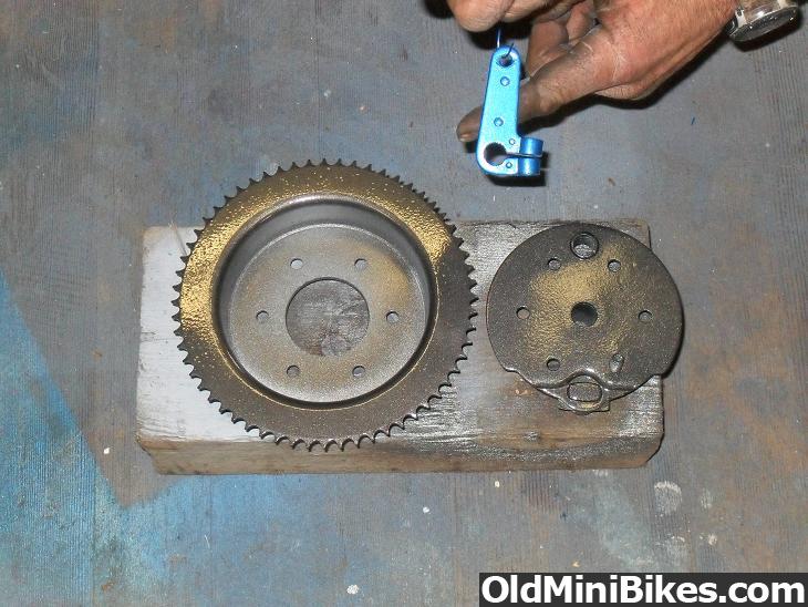

Looks great Bryan, :thumbsup: hey, I couldnt help to notice your rear sprocket teeth look like they have alot of wear, and are pointed, you might want to consider a better or new sprocket ,it will help the chain travel better, and lesson the chance of it popping off. Scooterboy has some very nice, better that original rear sprockets, just a thought. Mark..........
