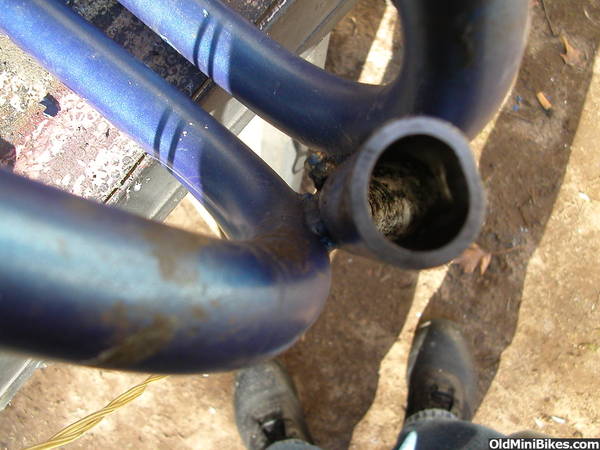

Harleys Papa Apr 12, 2014 #3 Apr 12, 2014 #3 I figure I could just get a 5/8 ID DOM and cut it for the bushings but if I could find one it would save me the time :shrug:

Jeff Clark Apr 12, 2014 #5 Apr 12, 2014 #5 Whats wrong with the one you have? just the flat spot? Ed is always the man..
gumpit Apr 12, 2014 #6 Apr 12, 2014 #6 :grind:Heat it and beat it. The bearing/bushings make up for any out of roundness..

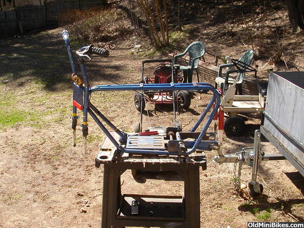

tippycanoenm Active Member Apr 13, 2014 #8 Apr 13, 2014 #8 That will be a nice one Harley............front peg too.......1300?:shrug:
george3 Active Member Apr 13, 2014 #10 Apr 13, 2014 #10 Large drift pin and a bit of heat. As long as its not twisted on the frame why alter the OEM weld.
creia Apr 13, 2014 #11 Apr 13, 2014 #11 Based on what I am seeing in that (one) photo, you should be able repair it in place(make it round again) w/o removing and replacing it. Michael

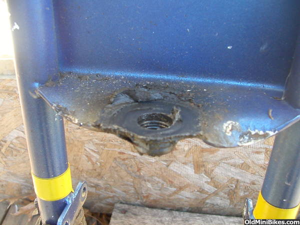

Harleys Papa Apr 13, 2014 #12 Apr 13, 2014 #12 bigevilone2 said: PM sent back ! :thumbsup: Click to expand... Thanks Ed :thumbsup: tippycanoenm said: That will be a nice one Harley............front peg too.......1300?:shrug: Click to expand... Its a mid peg Tippy, they just aren't there :doah: george3 said: Large drift pin and a bit of heat. As long as its not twisted on the frame why alter the OEM weld. Click to expand... Its a whole lot worse than the pic shows :doah: And this bike will be far from OEM when its done :devil2:
Harleys Papa Apr 13, 2014 #13 Apr 13, 2014 #13 creia said: Based on what I am seeing in that (one) photo, you should be able repair it in place(make it round again) w/o removing and replacing it. Michael Click to expand... Its not only out of round its badly worn too :doah: Looks like they rode it 1000 miles with no bushing in the bottom :scared:

creia Apr 13, 2014 #16 Apr 13, 2014 #16 Yes, based on that additional photo and information you provided, time for a new one.:grind::hammer: Michael
