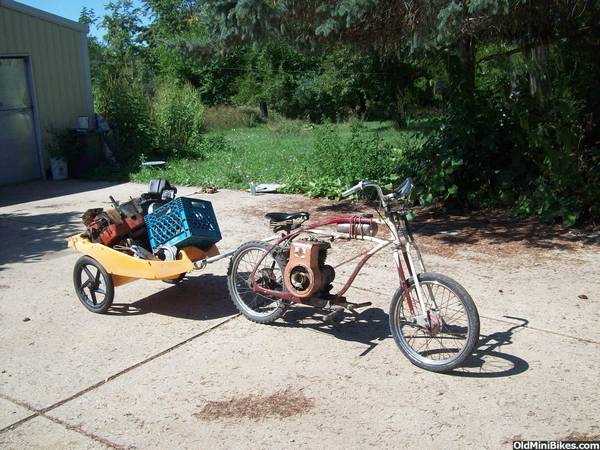

I have a Bicycle with a slightly modded, basically just hopped up Briggs 5 horse, it'll do nearly 60 and actually doesn't pull too bad.. It's pretty slowish getting moving from the dead stop, up to maybe 8 miles per hour, the torque starts adding up, till ya get to like 20, and the clucth really starts to try to grab and and bike shutters each time the fuel detonates and the piston hits, until the clutch really HOOKS UP and it is starting to GO!! because the engine is making 3,000 and just being able to get to come to life some, then from like 20 to hell, 54?? :shrug: It'll try to pull it's ass out from under you... :shrug:
It is geared for 60 MPH and will pull a trailer load of scrap engines to the junkyard... The clutch hates it, but once your rolling, it rolls rite along.. :shrug:
But thats on pavement, in a 75 pound machine, with a motor that runs DAMN good, pushing two 20 inch tires 2 inches wide..
