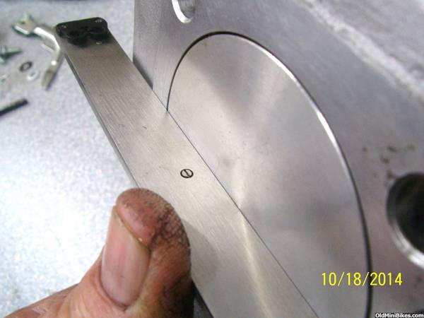

Well It was my first hemi engine and I measured it at .020 in the hole before I ordered the rod...and sure enough it put me at .000 with the .020 longer rod.
I would pull the head and see where your piston is at TDC if its .040 in the hole like some of prowlers engines then get a .020 rod and use a .009 head gasket instead of the .041 gasket. jmo
Yes defiantly check what piton depth you have...
Most of the Hemis I had were .025-.030 in the hole good for a .040 Rod and thick gasket... and most Non Hemis were .040-.050 in the hole... Perfect candidate for a Honda crank and Honda .080-.100 Rod... Or a .040 Rod and thin gasket...
