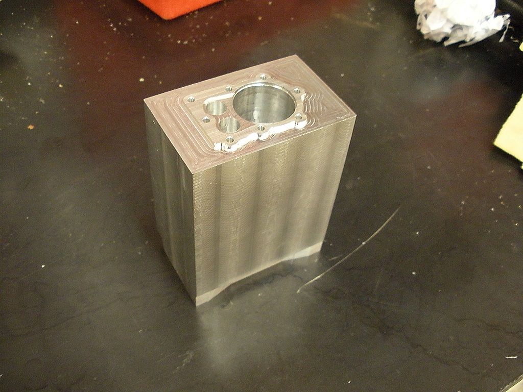

Sometimes when something is scaled down some of the detail will be lost to make the piece doable. The original block has 8 fins. This one will only have 7. I had to sacrifice a fin to allow room for a cutter with enough reach to get to the depth required to cut out the fins. Should know if it worked in a few days.
Side 2 code for the mill is tested. I had a little crash so the finishing passes were not complete but the problem has been corrected and I'm on to side 3. I guess that's why we test. When the code is complete I am going to try to make 3 cases. There will be about 15 hours each to cut so I think the extra debug time is worth it.
Thanks buddy. After this code is perfected I plan to make three cases. One for the bike and one for the table. The third one might end up on a 1/3 scale kart. If I ever finish the 1/5 Chevy with the blown V8.
Well I have all 9 programs complete, debugged, optimized, and ready to go. There are some unavoidable things I will have to live with but I think the finished product will be nice with a little hand work to smooth out the spots where the programs overlap. All the little "bad" things you see have been addressed and with a good setup I should be able to minimize the rest of the tool marks. The next one should be a big improvment over what you see here.
