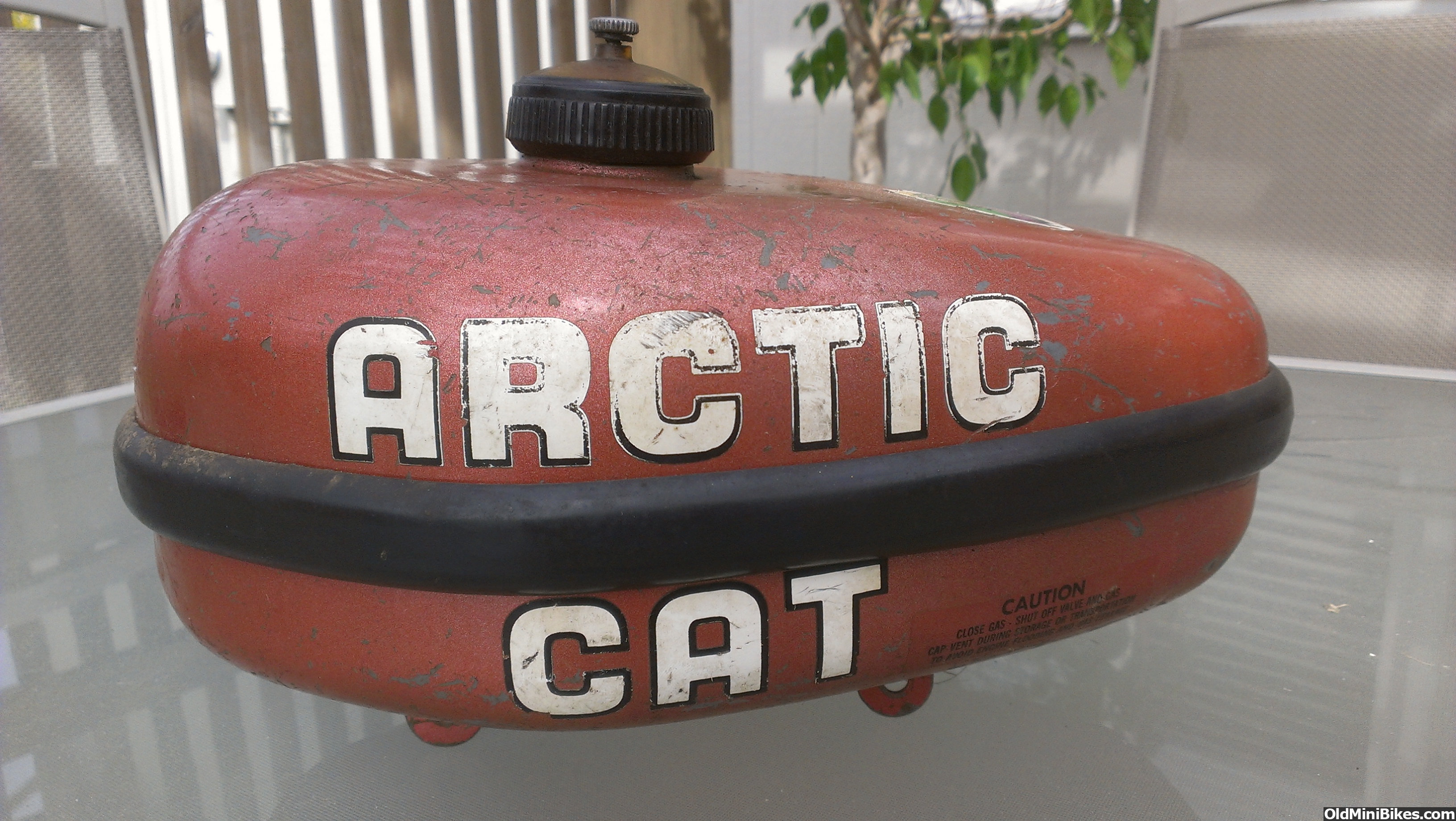

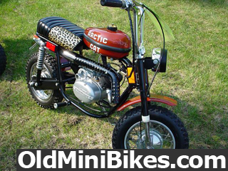

Arctic Cat Prowler Paint Color
Here are a couple of pics. Hopefully we're talking about the same kind of bike (Arctic Cat) and not some other bike called a Prowler.
One pic is of a nicely restored bike (not mine) and the other is of an original fuel tank that's been stored inside for 30+ years (mine). It's a bit faded but you can see something close to the original color, especially under the clear Caution sticker on the lower right corner of the tank.
This paint was metallic and faded really easily. I also heard from a friend of mine who's dad was one of the design engineers on this bike that you could put 2 brand new bikes side by side and they might vary slightly in color. He said they used to use whatever they had on hand back then, which makes restoring one a little harder, or easier, depending on how you look at it. Lots of parts like forks, springs, brakes, lights, etc. were common among brands back then.
Hope this helps. Please post some pics of yours. Like I said, maybe we're talking 2 different bikes altogether. If Arctic Cat though, then the headlight mounts were just welded plates on the forks and painted black like all AC frames. You can always PM me if you need more info. I've got lots.
