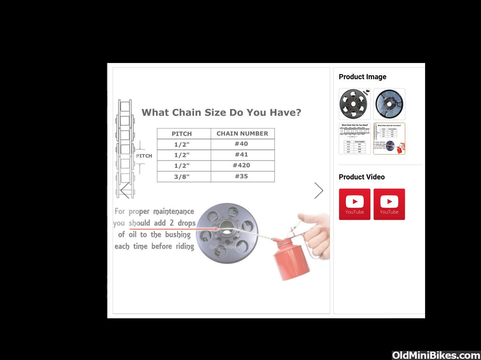

No I'd have to measure on the engine , I also use a 7/8" hole saw and cut a hole in the top of the angle iron dead center to allow access to oil the bushing when you remove the guard !!
