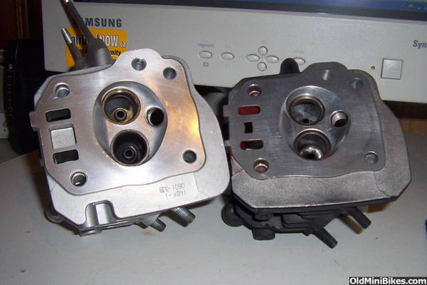

There is room to improve the engine.
Shop around the local small engine shops for a Honda clone 14cc head.
This head is used on most 5.5 hp clones and its a direct bolt on for the 6.5.
It will significantly raise compression and improve the way the engine runs at all speeds, but you will feel it most at lower rpm.
Here are a couple of 14cc heads.
See the chamber is smaller.
I know it does not seem like much but it makes a difference you can feel at all rpm.
