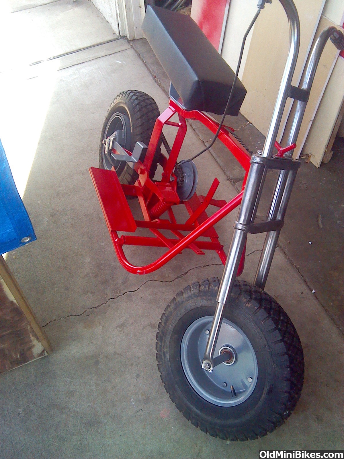

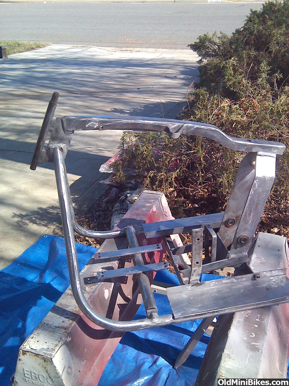

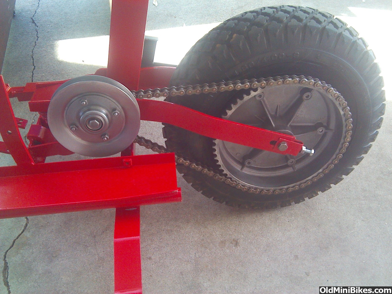

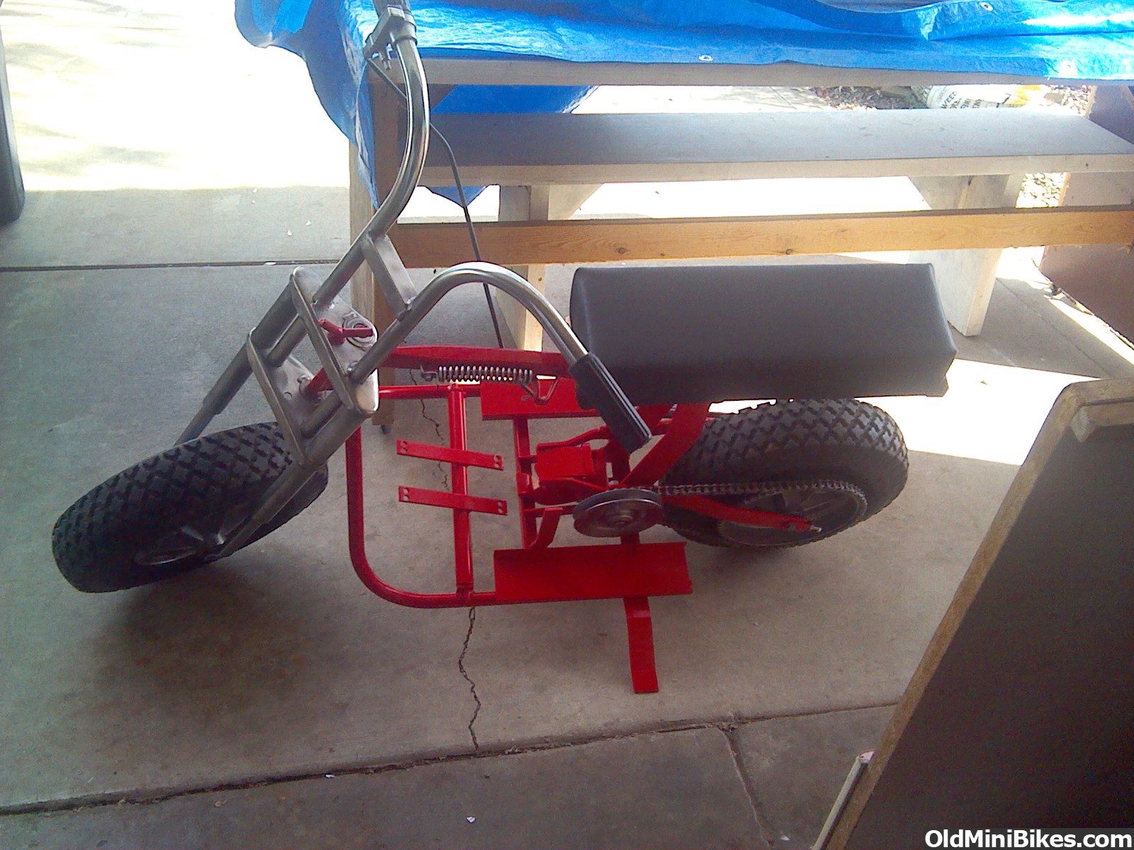

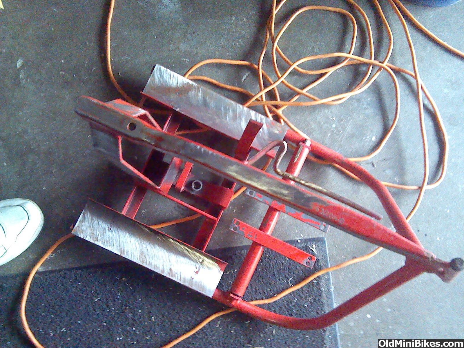

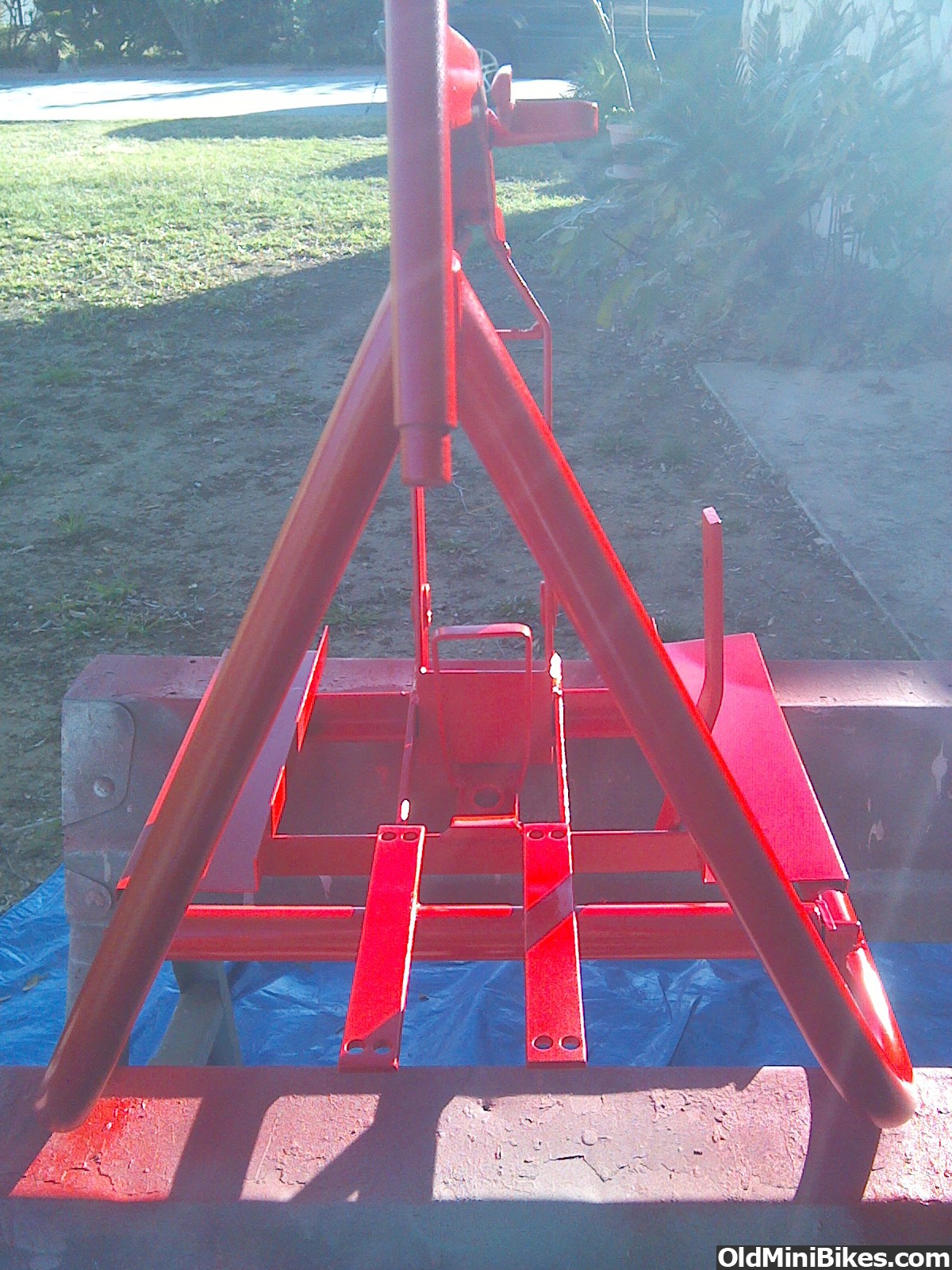

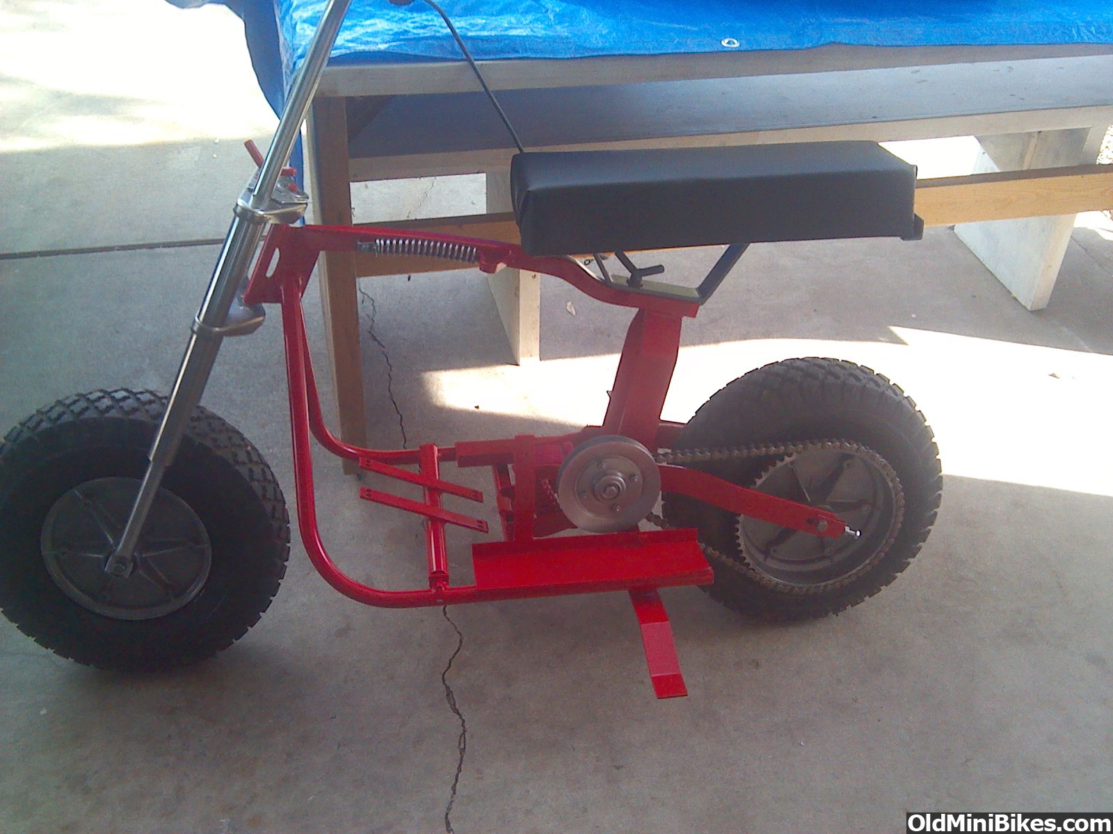

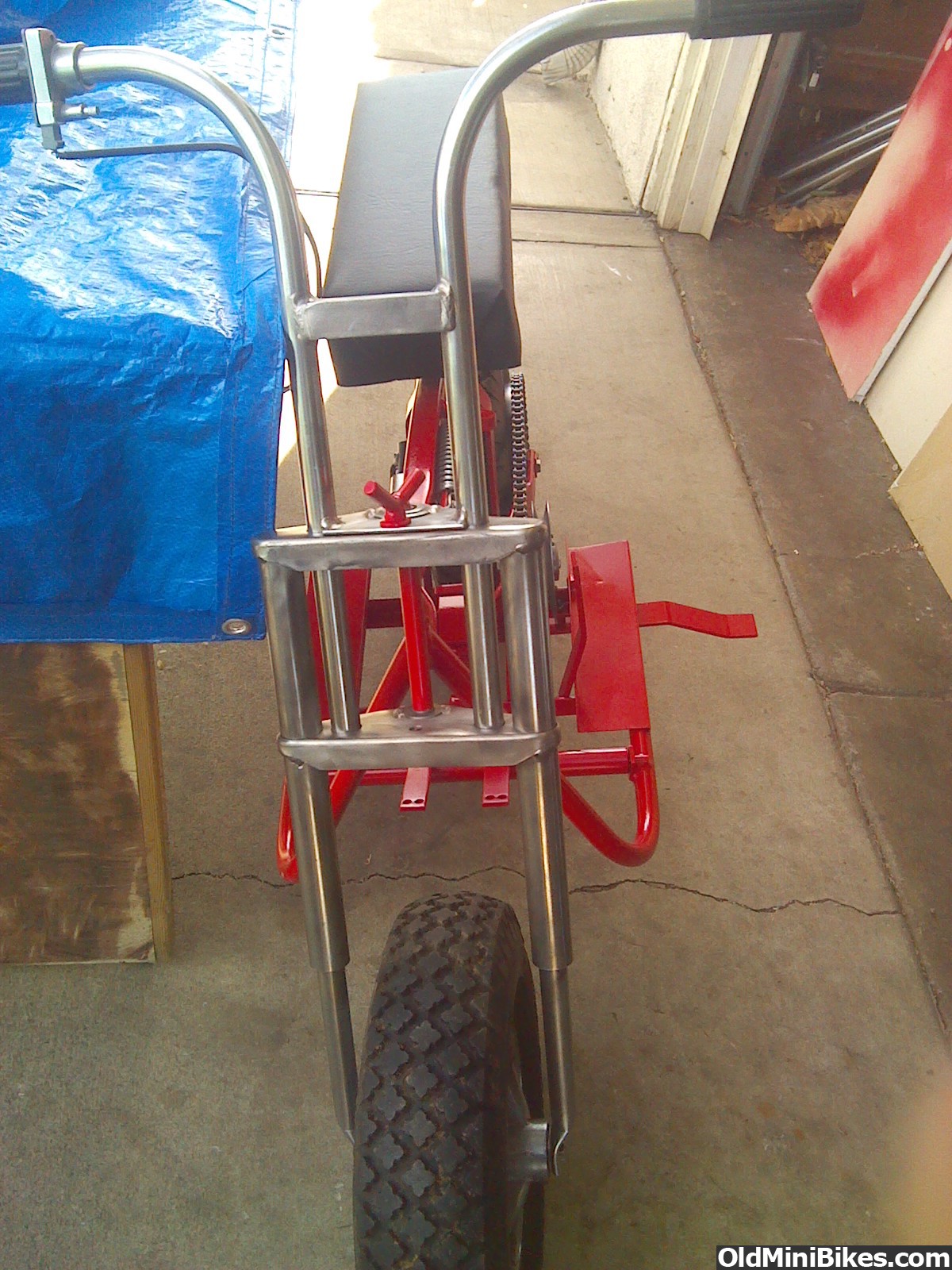

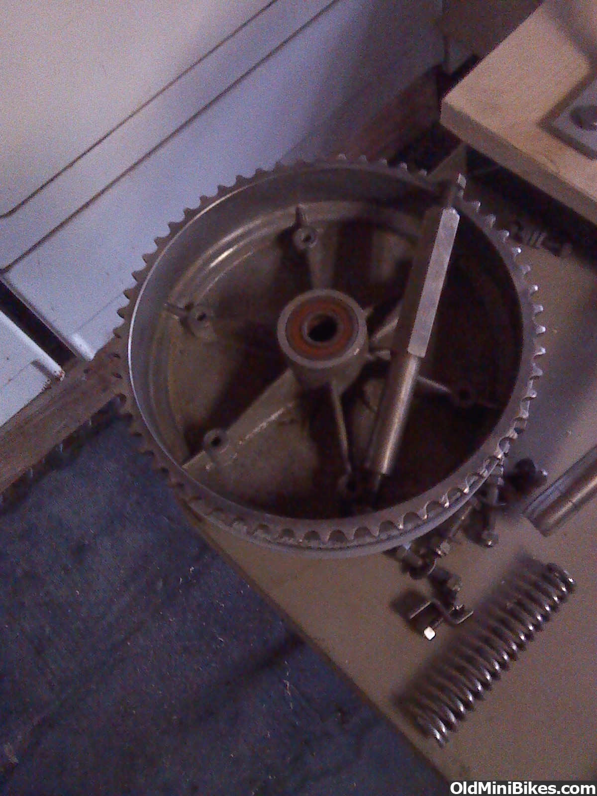

Thanks for the insight guys. I'll keep at it. Tried the dryer trick... but it sounded like I was going to have to fix the dyer if I let it go much longer. Here's a few pix of my progress.

Alright....I must admit.....That is a very nice! and a very cool looking bike!!
(We could use some of them over here on the East Coast) :rolleyes:
#11
Welcome to the fun , I have a Powell sitting at my sisters in Colorado that I'm dying to get my hands on , Looks Great !
