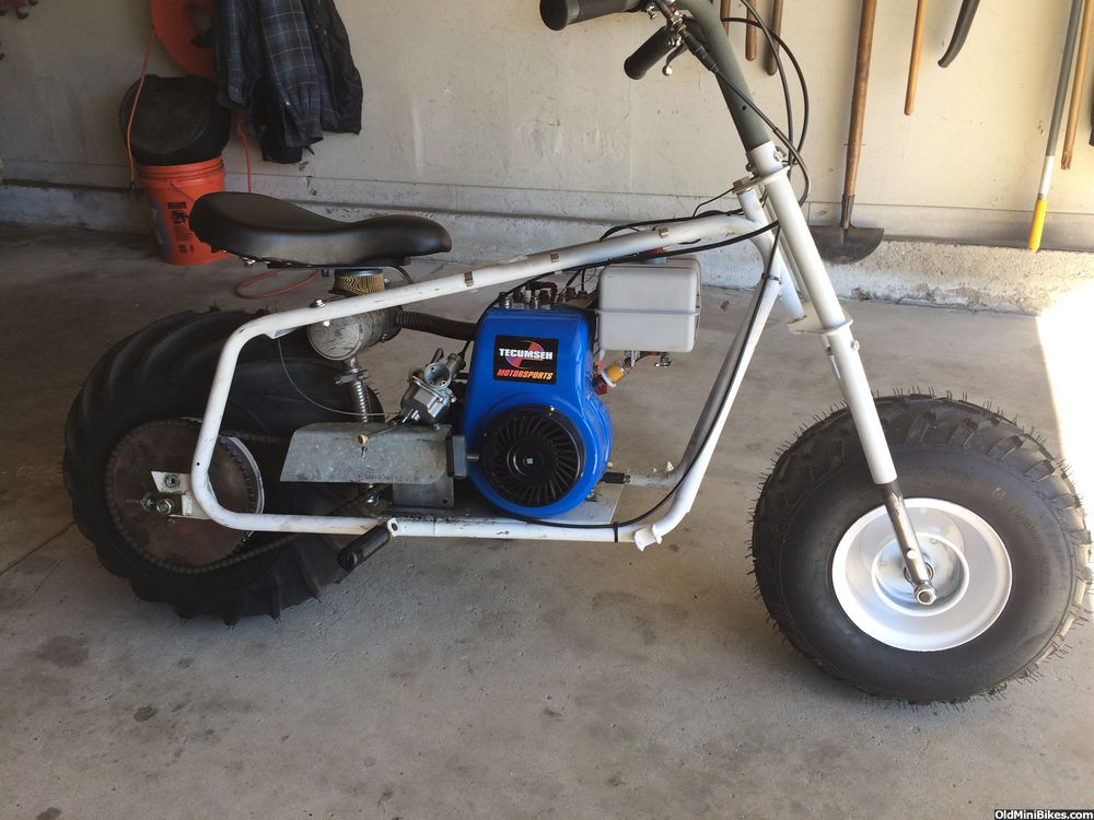

The shock rubbers are not the determining factor in seat movement right to left. The hinge is loose and you can tighten it to the pin to help or even eliminate the wiggle.
You will heed to remove the seat and turn the hinge straight up. Use the biggest hammer you can find, 5 or 6 pounds, as a backer under the hinge. Use a good punch and a 2 or 3 pound hammer to roll the hinge back tight to the pin. Easy to do as long as you have help.
Doug
Normally I might agree but the hinge is very tight .. I had to douche it with PB Blaster it get it to move when I got the bike.
In this case the lower rubbers have had oil leaking on them from the shock for so many years the rubber swelled up and is just spongy .. the upper rubbers are fine tho.
#62
I know my green SB is a little sloppy side to side and I traced it to the hinge pin.... Figured yours would be the same. I know this is to simple but are the bolts tight in the hinge?
My observation of the seat function is that the shocks only hold the seat up. There really is no way without triangulation that the shocks could control side to side. The hinge is the wiggle point. The rubber deterioration would just make the shock mushy feeling. :shrug:
Doug
Doug
Well crapsnacks Doug, you were right!
Tom and I were out in the garage ... I reached under and sure enough one of the seat bolts was finger loose .. I bet the others aren't far behind!
Kudos amigo!!

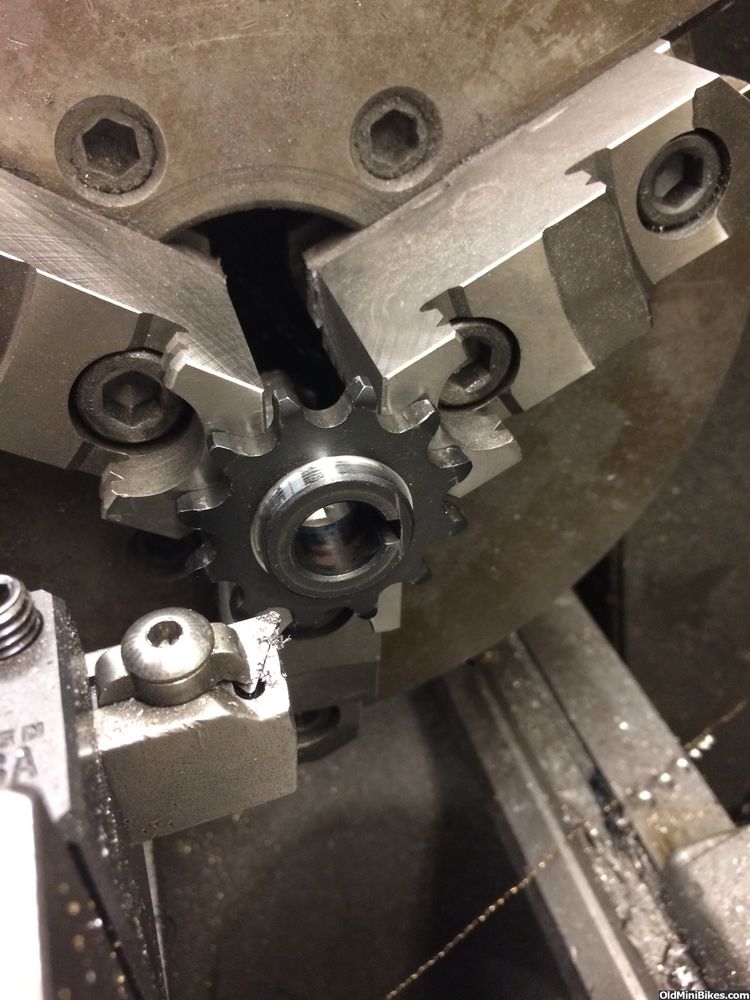

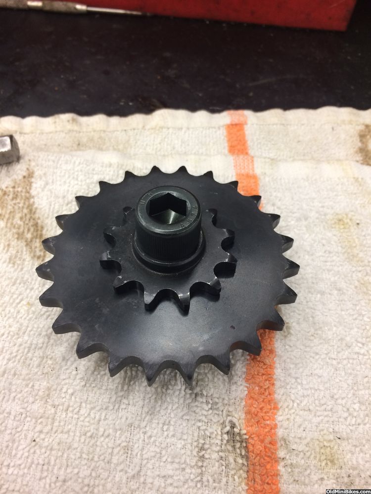

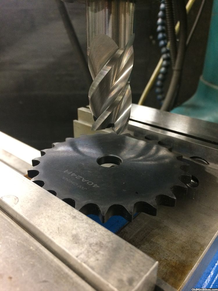

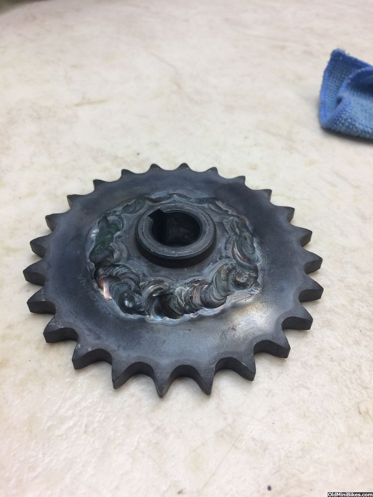

Too tall gearing has been an issue ... Tom suggested going twice the clutch teeth ... so I got a 24 tooth plate sprocket. Its a fairly inexpensive way to home in on the gear ratio I will want ... Being a plate its intended to be just welded to a 5/8 shaft ...

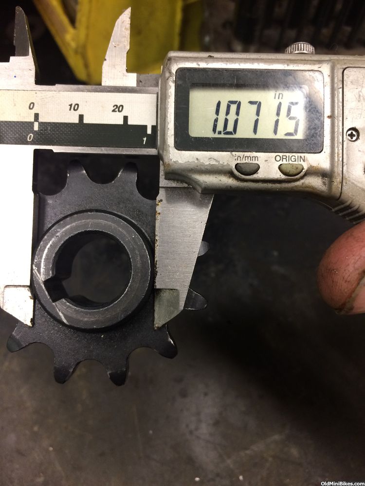

I have a 12 tooth with a slot for a key ... I'm going to mate the 2 sprockets.

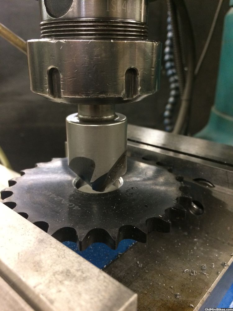

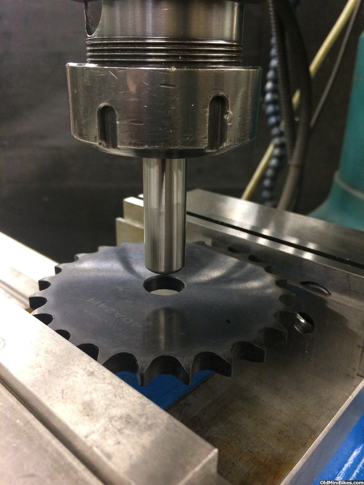

The plate sprocket was centered in the mill with a 5/8 dowel.
A 1" carbide put a new hole in it.
The hole was chamfered to help mate the parts flat.

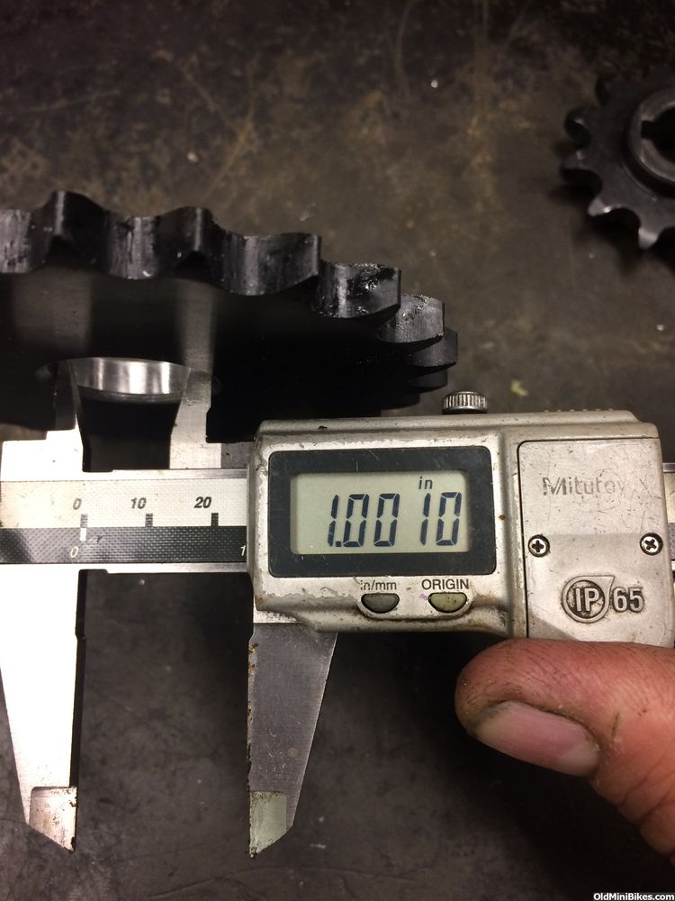

The plate is about an inch.
The 12 tooth is a bit bigger.
The 12 tooth was spun down to match the plate.
We got a good fit and bolted the 2 together.
Gob on some mild rod and she is stuck!
The back side wont need any weld.
I will install it tomorrow and see what's what!!

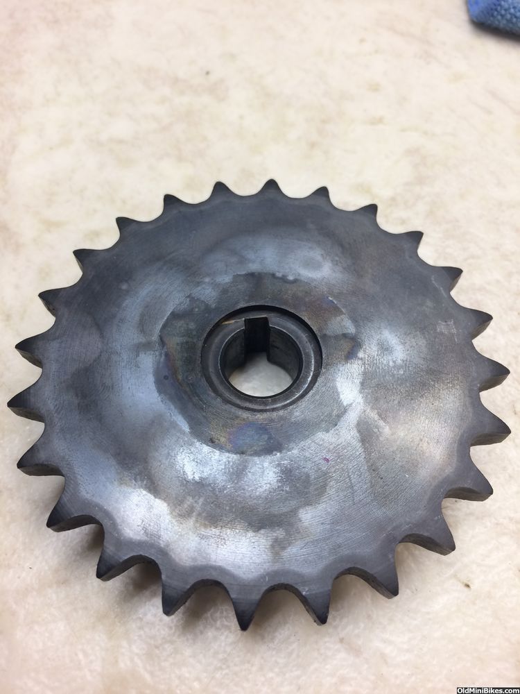

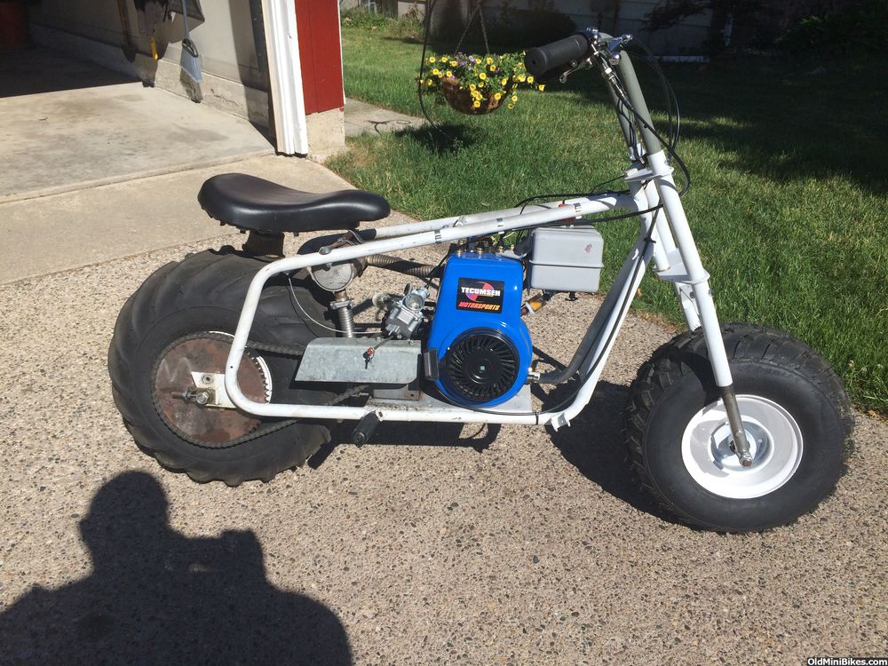

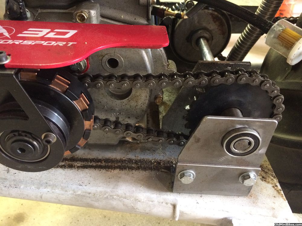

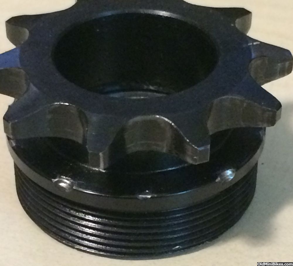

I got the 24 tooth sprocket installed on the jack shaft and re checked alignment, its perfect ...
That pic was taken after a short ride, the mounting plate was cleaned off and you can see where the new chain is chewing into the 3D Clutch sprocket and leaving a metal trail ..
Using delray's "how to start a hi compression motor without ripping out tendons" video [video=youtube;Di9nn2kSKp0]https://www.youtube.com/watch?v=Di9nn2kSKp0&feature=youtu.be[/video] I find this H50 Tec starts on the first pull!

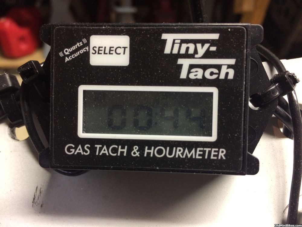

I installed a Tiny Tach. It reads hours run when the motor is off and RMP when the motor is running.
The screen looks good, this pic makes it look hard to see through, it is not ...
I take it for a run ... the gearing is much better but maybe still too tall for me .. My neighbor had his late 60's Yamaha moped out and I paced him going down our street. My mini got to 6500 RMP and started starving for gas, I'm thinking I need to open the jet another step. The Yamaha said 27mph, that's about right ...
I have a sand hill on my block, I've ridden up and down it many times on many bikes. You can feel the torque going up it at a clip but it bogs to the point of stalling if you go up at 5 to 8 (?) mph ... I was able to ride the clutch and get it up the hill.
It has all the power of my old VT-10 and likely more if it was running closer to it's power band.

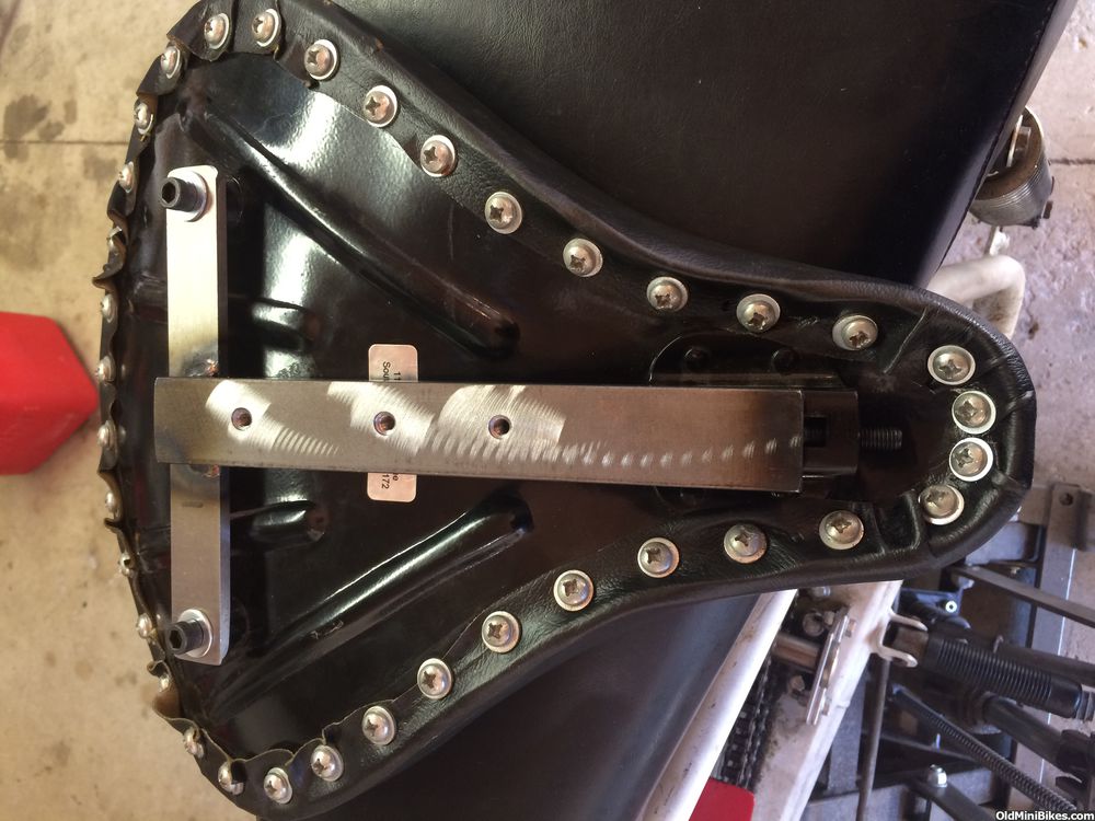

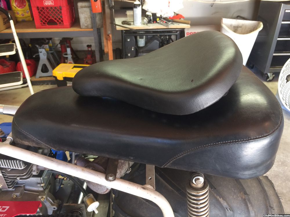

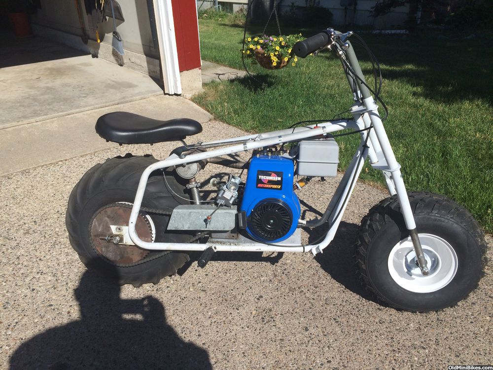

The motor is waylaid awaiting jets so I thought I would play with the aesthetics ...
Every Heald I've ever seen has the same seat ... I like the seats on OND's build off bike from last year and the Murray Track 2 ... so I got a bobber seat off eBay ... (since these pics I cleaned my lense to get that red crap from showing up in my pics!)
I made a cheezy bracket out of scrap metal with a few holes to play with position ...
I tried the seat back further over the wheel where the back of the stock seat would be .. NOPE!
Closer? Maybe ....
Closest ... Maybe ... gonna need to look at the pics .. higher? Angled more?
Not sure how the seat will ultimately be mounted but it will be sprung ... mono shock?
A rail around the back or some sort of something to keep me from sliding off?
Black fringe??
Hello Kitty Logo?!?
Bla bla bla ...
#78
Hi Dave!
My vision is more the seat sticking out in the air appearing to be unsupported rather than compression springs on the bottom.
A mono shock and linkage might be needed.
The seat is just mocked to show position ... better bracketry will be made when I land on something I like.
The current exhaust will be replaced with something else opening that room up.
Altering the frame isn't a problem either, I've considered extending the rear axel back but I don't want to extend the wheel base and sacrifice "flick-ability" in the trails.
Center of gravity is a factor in seat location.
I still need to decide on clutch or TAV, then what to do with fenders ... the rear one in particular, I want it to ride high like a dirt bike, not hug the tire like all Heald fenders.
So lots to think about that will all need to tie in together.
In short I want the bike to look cool but also be 100% functional.
