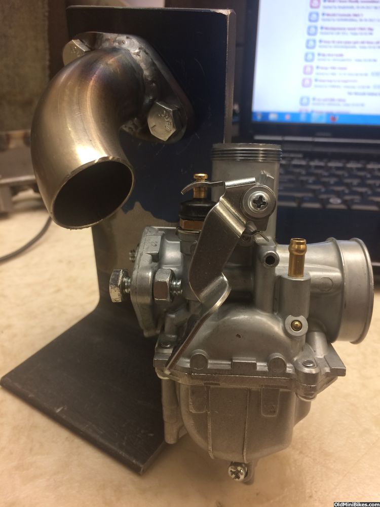

Things I do like .. the Tecumseh H50 Racing motor ... also the Mikuni tho its got a learning curve to it.

I'm with Davis on this. I am interested in this. I learned Mikuni tuning a couple of years ago on a BS flattie, and once I got it dialed in, the throttle response was phenomenal. I never found much difference with the air bleed, but getting the clip set up correctly on the slide pin made huge differences that made simple jetting easy to dial in.

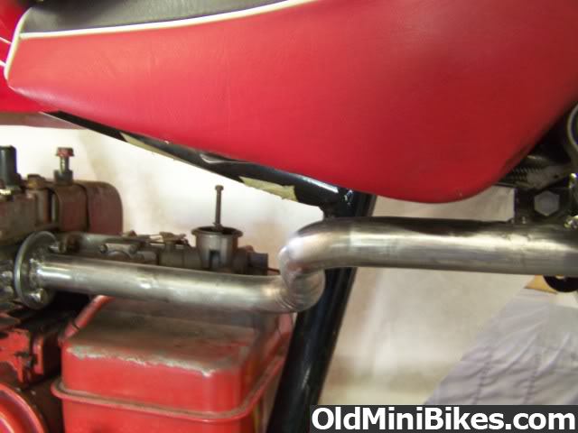

I suck on exhausts, because my tools are limited. I do know that Tecumseh's like as little back pressure as you can give them. I'd be thinking along the lines of a supported straight pipe, with possibly a quality muffler clamped on like RLV. You'll want to wait until the very last, so you can make sure you miss your seat support structure, and your body fitment to avoid those troublesome legfires. :)

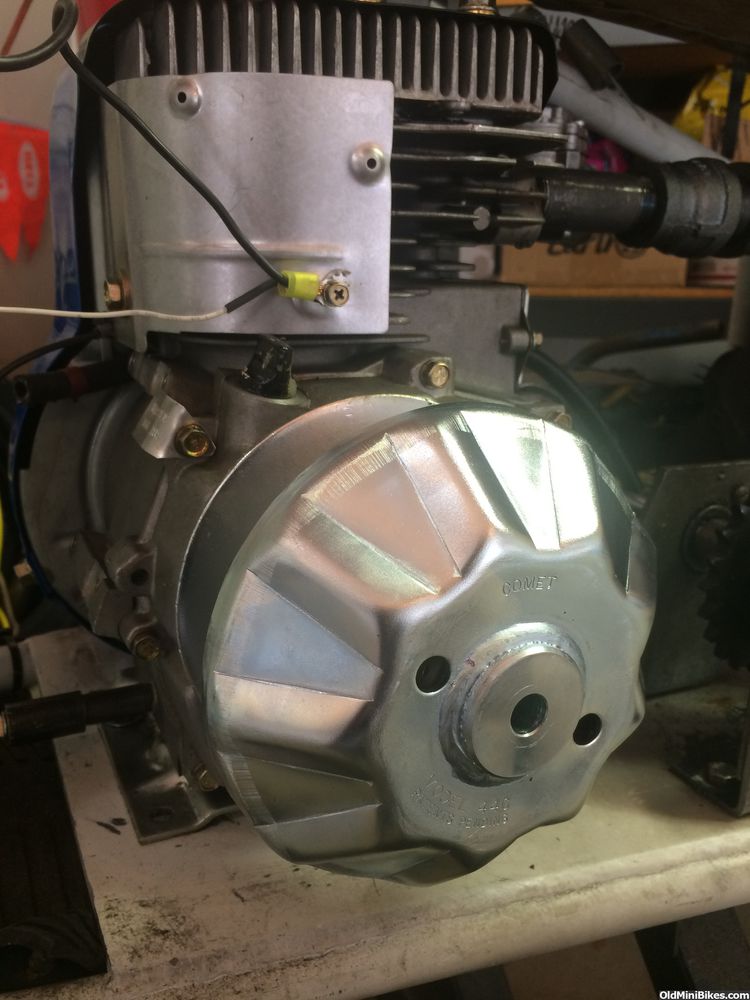

#89
Clutch issues ...
The Clutch will be replaced with a TAV.
Its hard to control this clutch in my application. I had to try it tho.
In a drag racing bike being able to feather it out and let it lock when you want it to would be the cats ass. It locks up hard, at least on my 9hp motor.

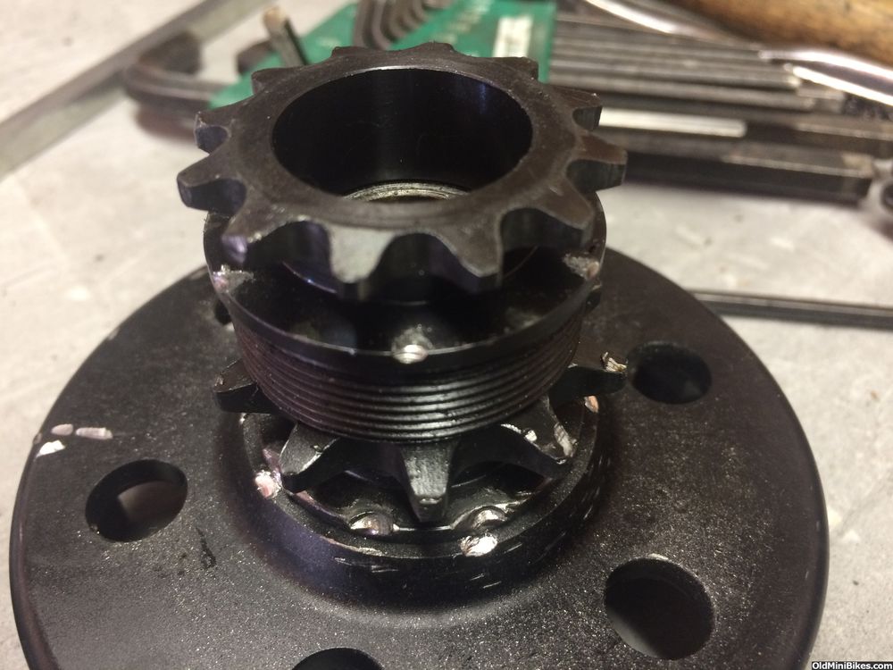

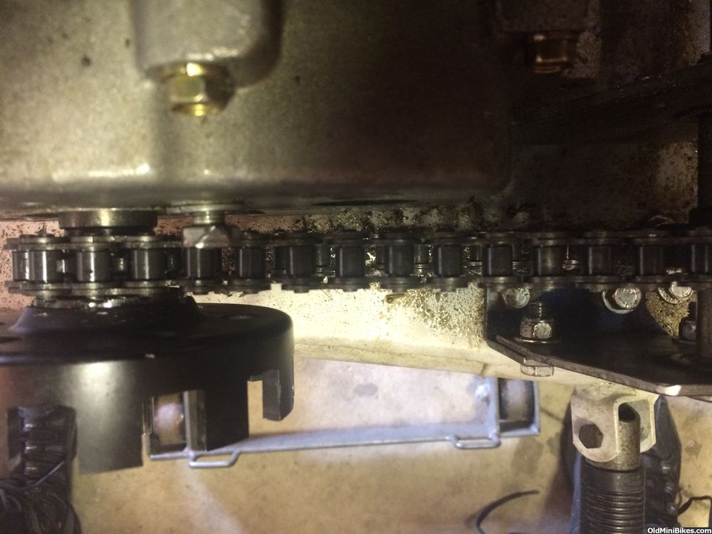

Problems I had otherwise ... (sprockets were aligned with care so that was not an issue)
The chain was chewing the sprockets (#35 & #40) badly.
#35 on top, #40 on the bottom.
My best assessment says master links should not be used, but I didn't see any thing on the 3D website about that.
First the #35 .... The regular links could have made those chew marks but the master link was definitely interfering.
Odd thing is the chew marks on the sprocket are every other link pin, not every pin like I would expect.
I measured the pin width and regular link pins were .520 while master link pins were .560
The #40 ... same issue as above but more pronounced as the chain is wider but the distance between the sprocket edge and the chewed area is about .210 on both the #35 & #40 sprockets. Add the wider master link and there is much interference.
When I moved from a 12 tooth jackshaft sprocket to a 24 tooth sprocket I ran into another problem, the chain was hitting the hex head that secures the guard to the motor.
This was causing the chain to get pushed twards the outside under load and popping the master link clip off and then the chain.

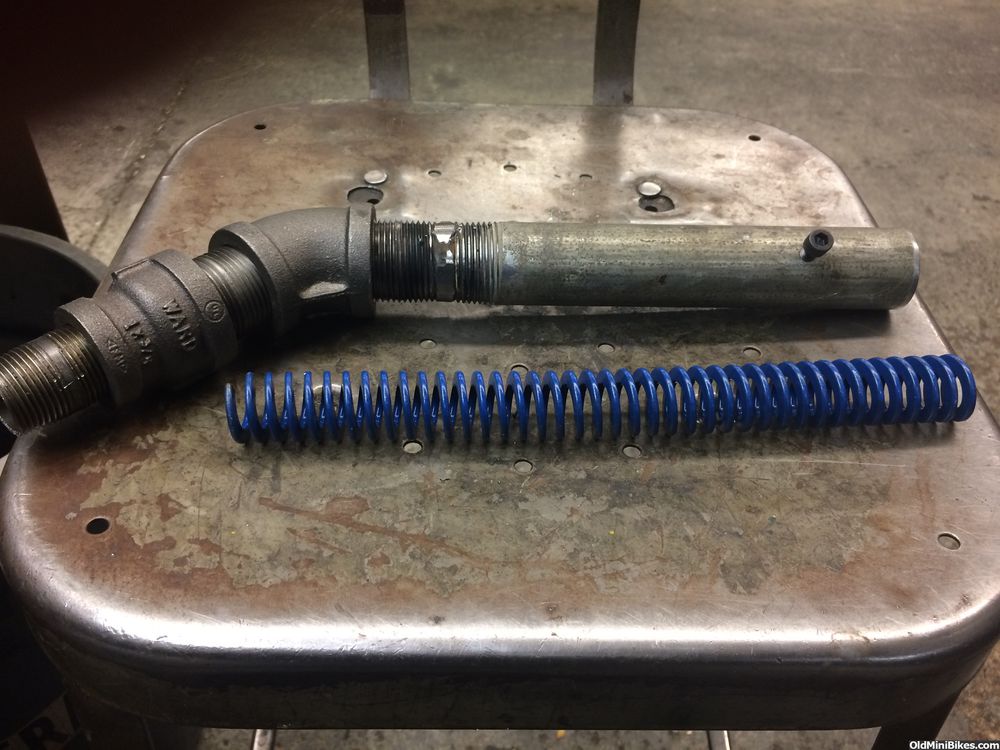

The exhaust is my next stumbling block ... I found some parts around the shop to fab this up ...
The spring is 1" O.D. and 1/2" I.D. ... it fits in the tube and is held with a cap screw. it's a continuous coil.
The flat ends of the spring have been cut off so
It can be cut as needed for sound/performance ...
It looks good on paper anyway ...
I hope to try it tomorrow ....

Interested to see how this works. Can you post a couple of videos, one with the spring & one without? Looks like a good idea for a budget muffler build.
#94
Could you come up with a larger diameter spring? Say a 1 1/2 inch OD or even a 1 1/4?????
I am liking it so far.
I would think the longer the pipe the better sound control it would have to a degree.
Delray's pipe was pretty long.

Ok, here's a video of the exhaust in action ...
[video=youtube;WPz4EBnKEiQ]https://www.youtube.com/watch?v=WPz4EBnKEiQ&feature=youtu.be[/video]
The results are more dramatic than the video shows .. the spring makes a big difference in sound.
Crank the volume on your speakers, its helps tell the difference .. yes really ... you hear the no-spring throaty sound.

Me likey. I wonder what it would do with a length of pipe behind the spring? A tailpipe....
Doug
#97
For me a finished exhaust might have this spring near the end but held in place with a cap screw that wouldn't be so visible.
And yes I can get 1-1/4" and 1-1/2" springs ...
