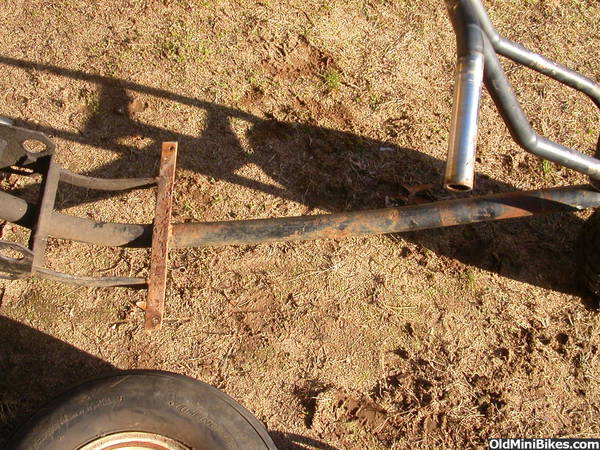

Flat track racer, 18" stretch(so my fat arse will fit) live axel, golf kart tires and one hot motor :devil2:
#2
I will straighten the lower part of the forks and get a new front tire the upper forks will be cut off and I'm going to use bicycle handle bars, not sure if they will be 12 or 18 inch rise :shrug:
I'll add 18 inchs here under the seat with some cross bracing :thumbsup:
#5

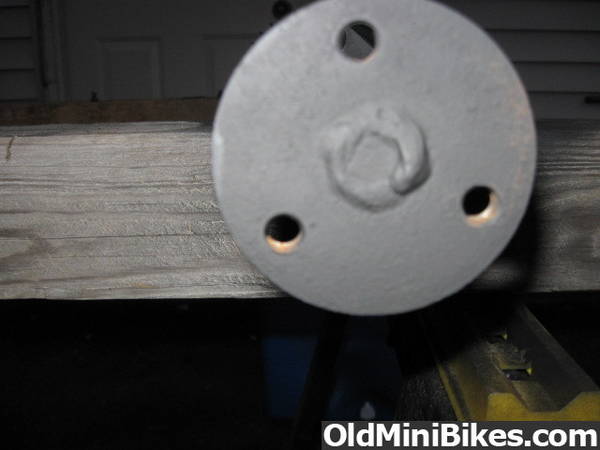

I think you have enough problems in the turns. Lol.You might want to reconsider the live axle. There are adapters you can put on the hubs to run 4 bolts wheels..

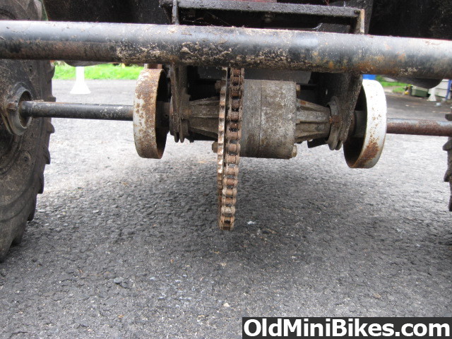

I thought the butchered frame had a live axle. But it had some weird double bearing and two seperate axles in it. I actually put in a differential and added a 4th bearing hanger. Beefing up some other places with gussets. Making it heavy duty.... Might leave the drivetrain stock so I can let others try it out. I might also put the body I have on it as well... I have a lot of welding and grinding to do.... Too damn cold though... I'll need to take into work to get more done before spring.
Are you not going to race the TT course? And with a little to much water on the track you may not be able to turn even on those corners of the oval. It certainly will be harder to make the sharp cuts to get in front of someone unless hitting the brakes. Powering the motor wont let you turn as fast by sliding the rear end. We have been riding these things for a while with both differentials and live axles. If you want to turn. You need the differentials. I hate to see you spend money to do it twice when you arent happy with the live axle over the differential.
