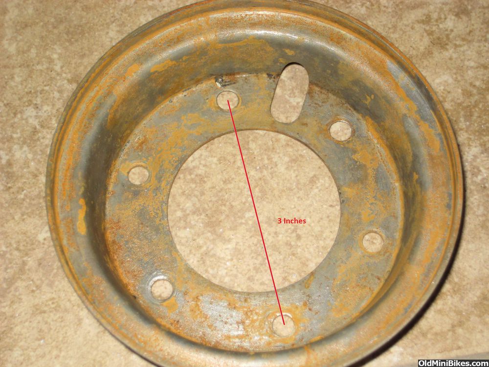

The good wheel half. Later on, Hands 4" wheels were used. These use tapered hubs for Timken bearings.

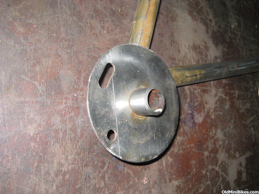

Detail of rear brake backing plate. A band brake configured as an expanding unit is pinned to this plate (round hole) where it is anchored. The slotted hole contains the actuation on the other end of the band via standard cable.

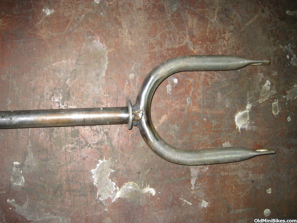

Replacement 1" steering tube welded to hoop. (All 3 hoops on this frame are 6" centers) Weight of bike is taken up on welded washer.
Assembled with replacement top frame. 1" X 22" long. Coped to neck which is 75 deg.

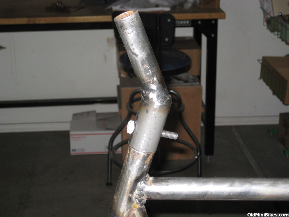

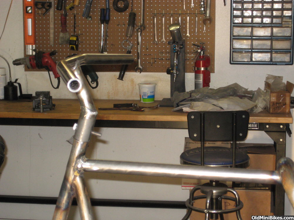

Steering stem and handlebar mount. Bottom section would have been same dimension as steering neck. (This was all missing) I was unable to source an I.D. of 1" plus, and without a lathe, I had to shim the inside of the lower portion. The lower portion is 2.25" long. Shim was a piece of .030 sheet metal rolled up inside.
Top is set at an angle of 47 degrees, and 4 inches long. It will be coped and the handlebars will go there.

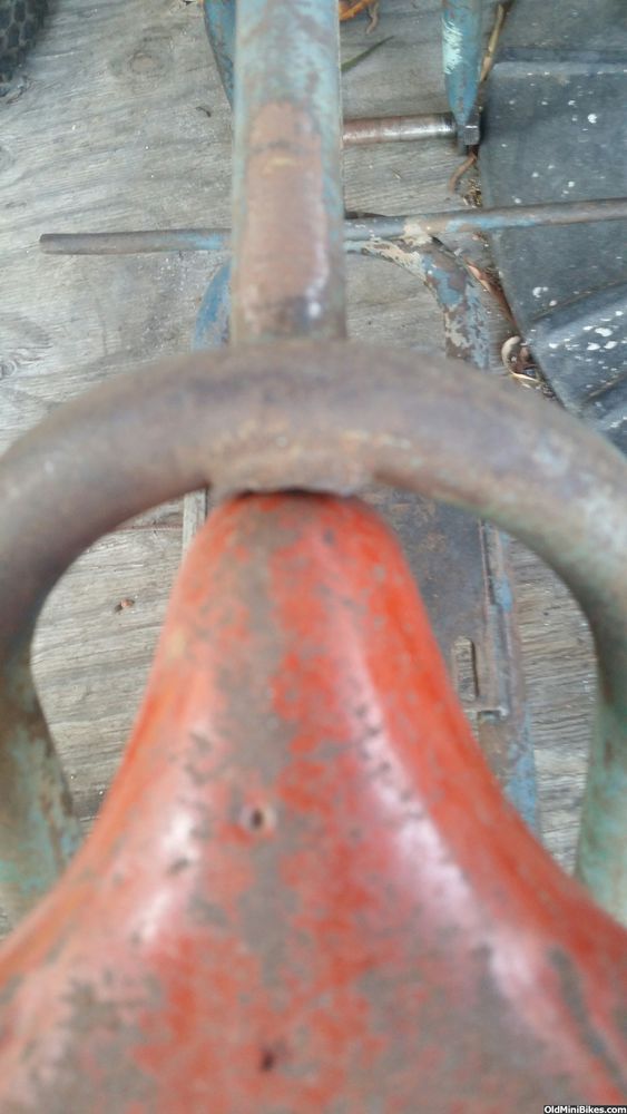

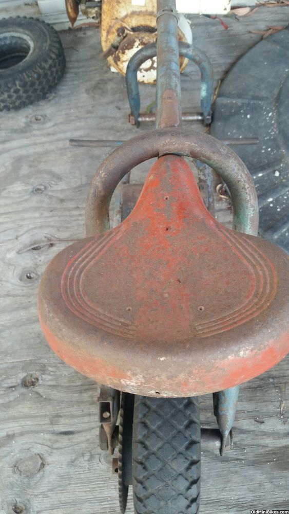

Does anyone know what kind of seat this is/was? It has the shape, almost, of an old Troxel, but it almost looks metal, or plastic molded. The seat would have been available in late 1950's, and very early 1960's.

I've been looking at seats awhile i have beach cruiser bikes ..those remind me of bicycle seat coz no bend in them..scroll down ...maybe you can use one of these..
Thanks Raskin, a couple of them look like they'd work. Using "beach cruiser" as a search criteria is a better way to search.

seats were off tricycles, steel, welded in front (on top) and bottom to help strengthen the tube of the frame and keep it from bending down in the back. pm me for pics and ill email you what im using on my build.

Ha! Thanks James, that is what I was coming up with too. I sent you an email requesting photo.
