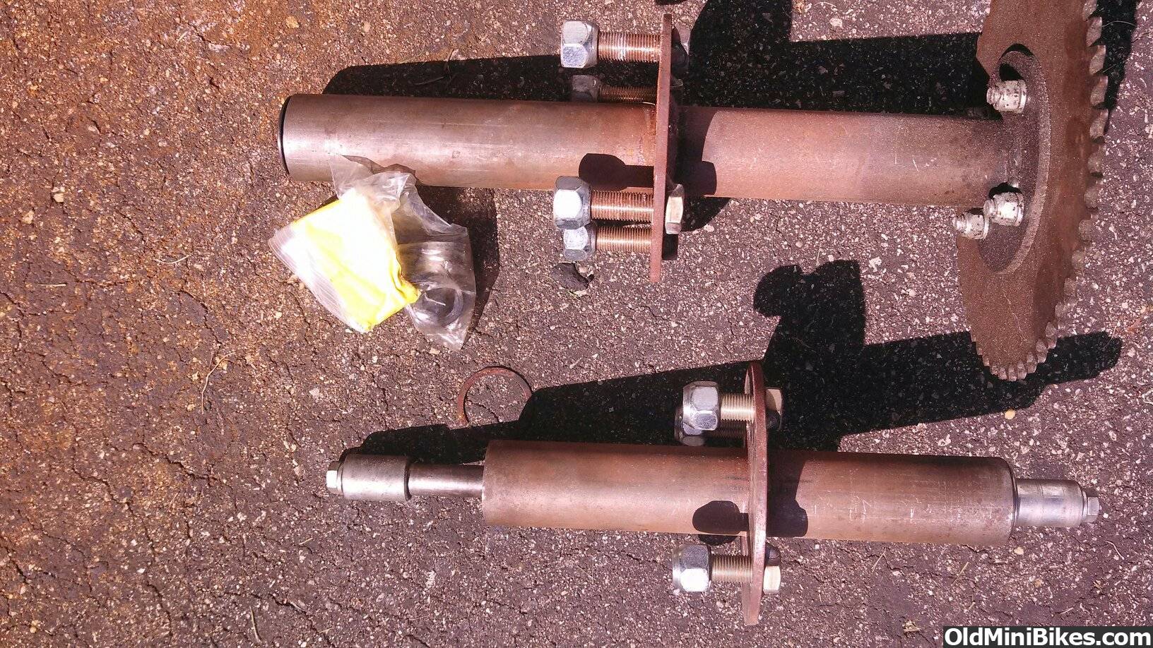

Made the front and rear hubs to mount 4inch pattern 4 bolt wheels on my El Burro . Sold the bike with the bad original tires on it and kept these . Have everything here but the rear axle to mount to your El Burro . Made for center off set wheels . Has a new 40 chain 48 tooth sprocket . $150.00 plus shipping . I accept pay-pal .
Thanks Jerry for the compliment . My brother and I saw a need to be able to make hubs for most any mini bike where the tire mounts to a hub with bearings . A friend has a computer water jet laser . I drew up prints with the dimensions needed and he made them up . I bought steel tubing with an inside diameter of 1.375 inch so the bearings with the snap ring can be used . The OD is 1.630 . The plates are pressed on and then welded . These are some of the plates we had made .
