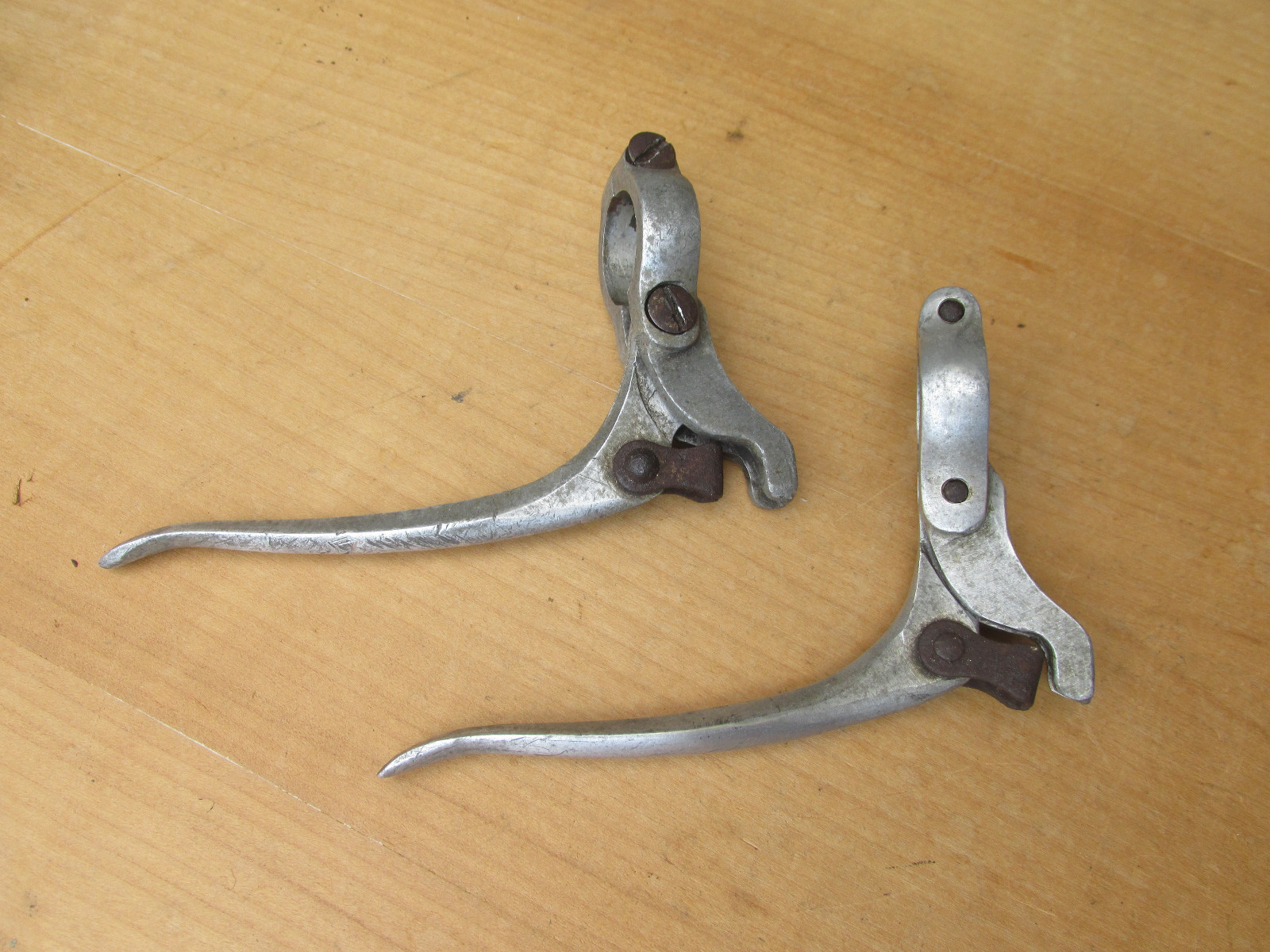

The rusty brake levers....I guess they're hard to find replacements for, that are the same ones. Might just use some of the later design that has a single clamp bolt, instead of the double bolt clamp. These might be English? they look like those found on some old Raleigh bicycles?

Those levers look like mini bike standard Cherry. Inexpensive to replace. Excited to see you move ahead on this.

the brake levers on mine are not Cherry levers, they have an extra link in them, the cable does not have the round large end that the Cherry requires. But I could use Cherrys to replace them, and I doubt anyone but me (and anyone who reads this thread) would ever notice.

Upon closer inspection....the "MADE IN...." stamp was hidden pretty well, and it's tiny. But there it is...JAPAN!
I did find one picture of these same levers, on google, from a site that copies stuff from ebay auctions. no idea when they were offered for sale, and they were rusty, too.

The Brake levers are old school bicycle brake levers I'm sure. I'll look and post a link when I find them.
I looked in Vintage Bicycle brake levers, nothing exact so far. # 172505088984
yeah, they are old bicycle brake levers. But kind of hard to find the exact style today...if you have a link for something that's close, I'd sure appreciate it.

I looked into 20 pages on e-bay nothing exact, I know I've seen them in the past.

The pointed lever reminds me of a muscle bike brake lever.

Those are not the correct brake handles and as far as the clutch goes let it soak in pb blaster a few days and I usually work them off from the backside and sometimes they flat gust don't come off and you either ruin the clutch or if the motor was junk I've cut the crank and done it that way and as far as the foot pegs the black ones on OldMiniBikes are correct for the bike.

Interesting...in the blue Action brochure above, I can see the two bolt clamps on the levers, just like mine has. My guess is that they sourced parts from several different places over the years. I see no evidence on mine that the levers were ever changed. I also noticed that the footpegs on the scooter in the brochures are light colored, as mine are...not black.

I see two on the pic in the flyer...but since I can't find any like that to buy, I'll probably just get some of the generic replacements. No biggie.
