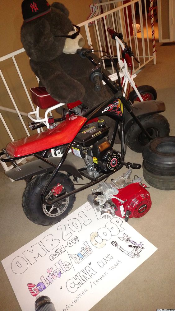

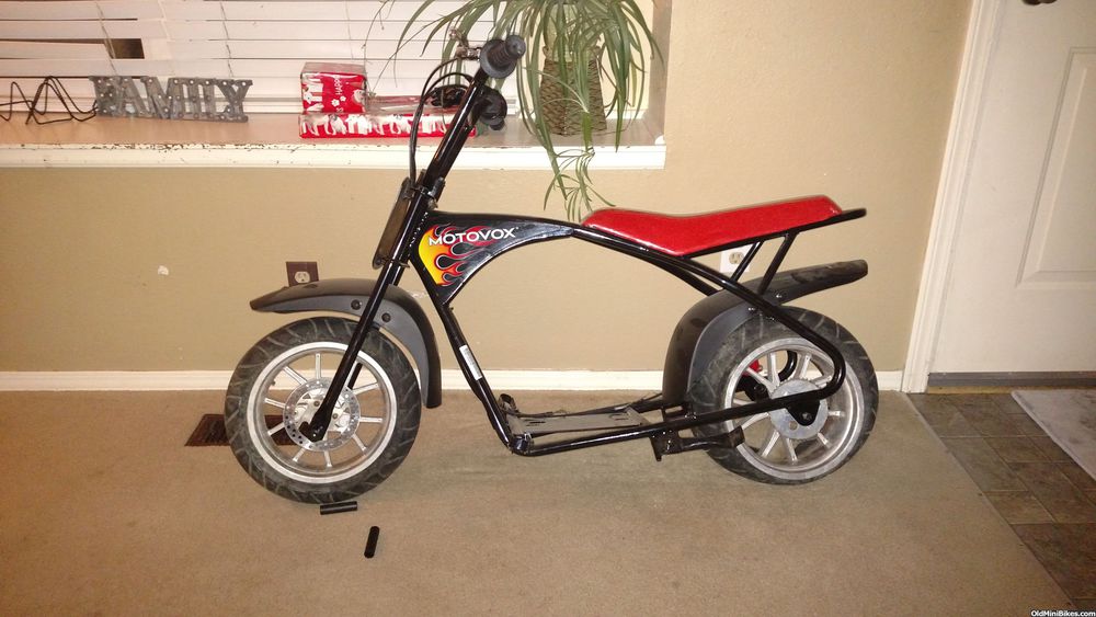

Daughter/Father team, my daughter will be hands on in every aspect and decision of the build. We were told we could only compete in one class with the bike (although I hoped it'd qualify for 18 under and "China" class) but my daughter decided she wanted to play with the big boys so China class it is. Get ready for some pink fellas. Daddy's Little Monster.

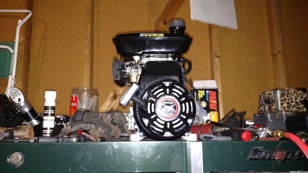

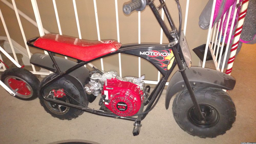

Thanks for the kind words everyone. I only wish I had known about this Build off when I started building my DB last summer. Unfortunately we don't have quite the budget to go that crazy on this one and I want my daughter to do as much as possible. I chose to give her my GX200, for it's safety and reliability. Besides the governor delete, re-jet, intake, and an exhaust, I will only install OE Honda 18lb springs and call the motor good. She's 9, and likes to go fast, but we try to play safely. She was riding my Easyrider before we got her the Motovox and it's just too slow for her. We will concentrate on custom finishes/color schemes and upholstery

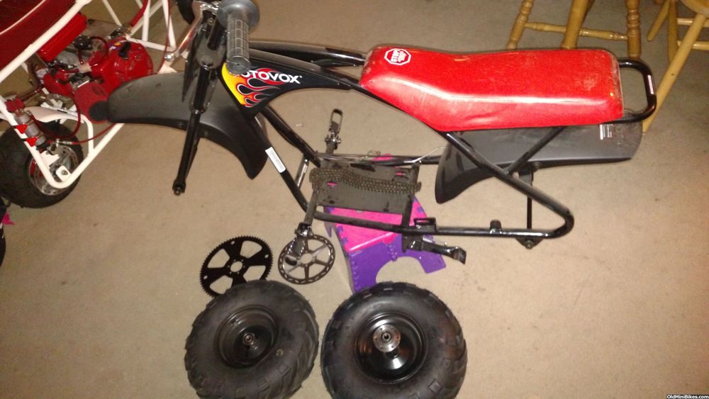

Would love to use these freebie X8-X9 wheels, but would take some machine work to make work. The flanges are puny 3 bolt to hold both the rotors and sprocket on the front and rear wheels. The positive side is that even though they only have 3 mounting holes, they do line up with the stock rotor and sprocket. But on the downside, the rear wheel has 2 of 3 bolts sheared off in the aluminum wheel and I am sure more will snap if and when I try to remove the rear sprocket and front rotor. Then I would need custom spacers in between the rotor/sprocket and rear wheel to line up the caliper to the rotor and sprocket on the other side. Anybody know or is a good machinest?
