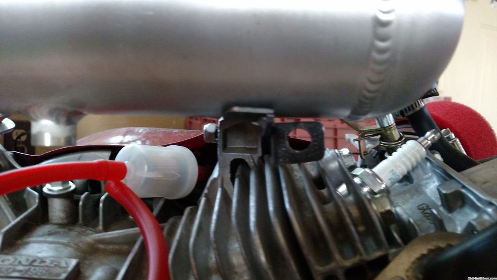

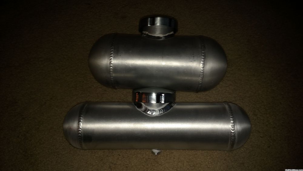

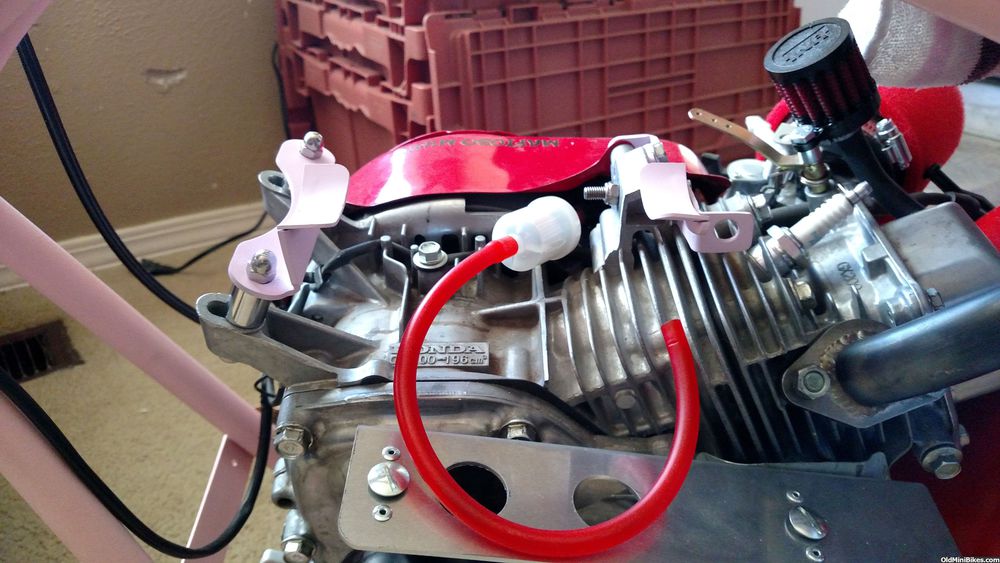

The new smaller diameter, longer tank next to the the first one showed up Monday. Fits beautifully, and gave me enough room to level out the gas tank on the bike using 1/2" chrome spacers on the front mount. I'll probably end up using 3/4" spacers or adding an additional 1/8" spacers.
The motor plate and whole bike for that matter slope down in the front, making the engine not sit level in the bike which in turn made my gas tank slope down forward. With the larger tank, there was no room for correction. I also shaved down the throttle cable compression fitting bracket off the rear mount to clear the longer,
now level tank. And I already have the other one sold for what I paid for it.

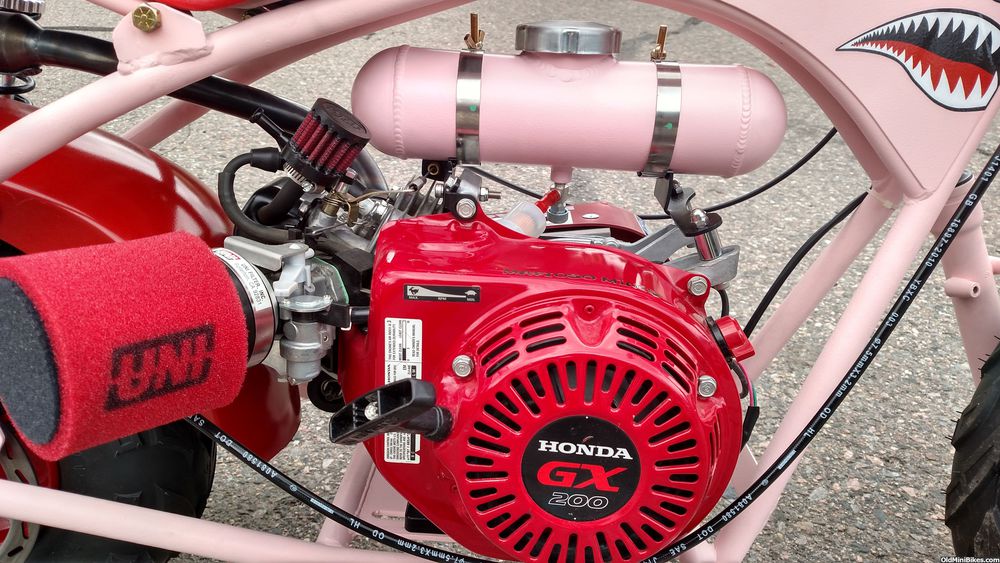

Nope... Another reason I swapped out tanks. The gas cap now comes off and will be easily filled between the two top tubes with a funnel. Got word this afternoon that the my tank and clutch cover are done being anodized and I will be picking them up tomorrow. Will finish putting it together tomorrow and snap some pics outside. Will be done and ready for it's maiden voyage.
Decided to paint the bare metal tank brackets in a Krylon chalky finish pink paint. As close to a match as I could find, but doesn't match the frame perfectly, They will be mostly covered by the gas tank anyway making the difference even harder to notice.

Ahhh ok that's good, I had suggested the offset filler neck on that tank awhile back but you already had the new one. Sometimes they make it easier to fill in tight clearance spots. In your case it would have been outside the frame. So when is the reveal Bday?

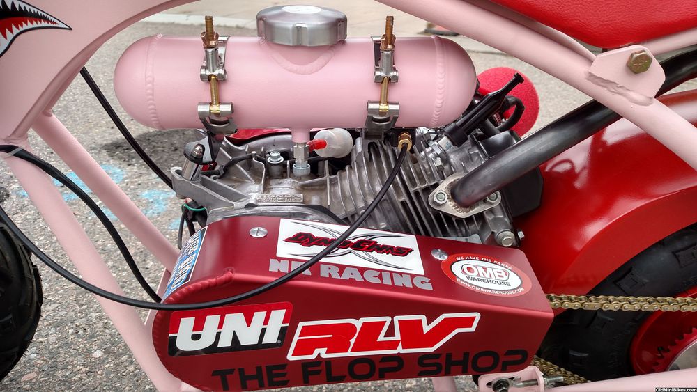

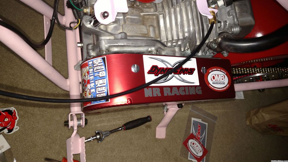

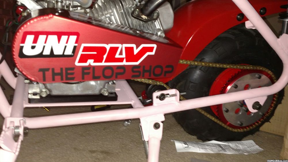

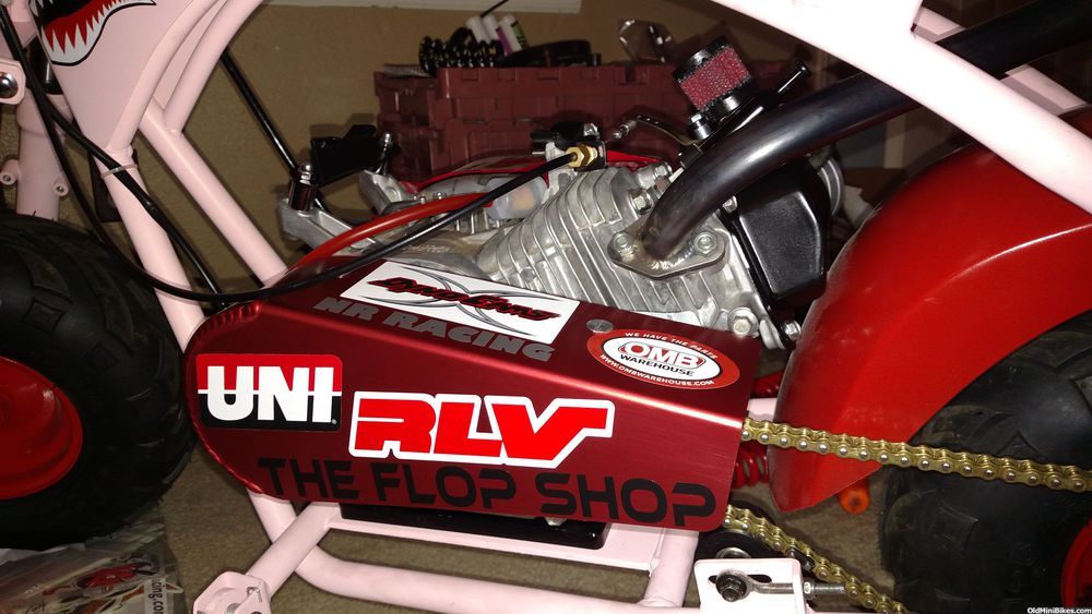

My anodizing experience had mixed results, and after picking up the tank and clutch cover, had to go to plan B. The clutch cover came out nicely, but the tank was a different story... I still opted to decal out the newly anodized clutch cover, for a racy look.
Due to the different lower quality alloys used in the tank, it came back 2 shades of purple and was hideous. I literally took it straight from the plater, to my powder coater and dropped it off for him to powder coat it to match the frame. I will pull the tank brackets back off and paint them gloss black.

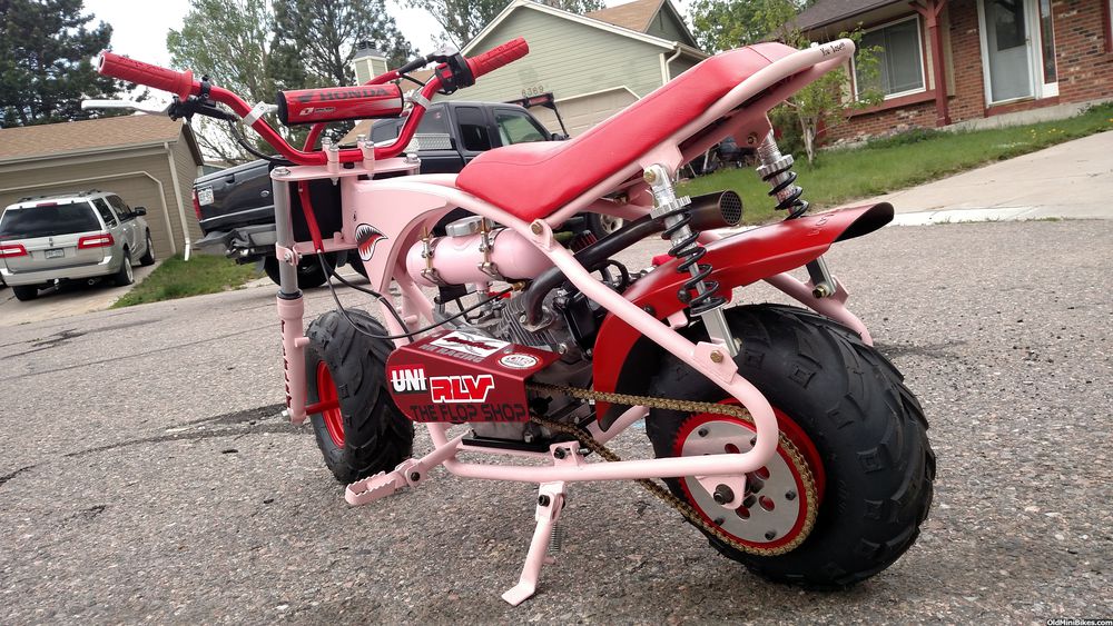

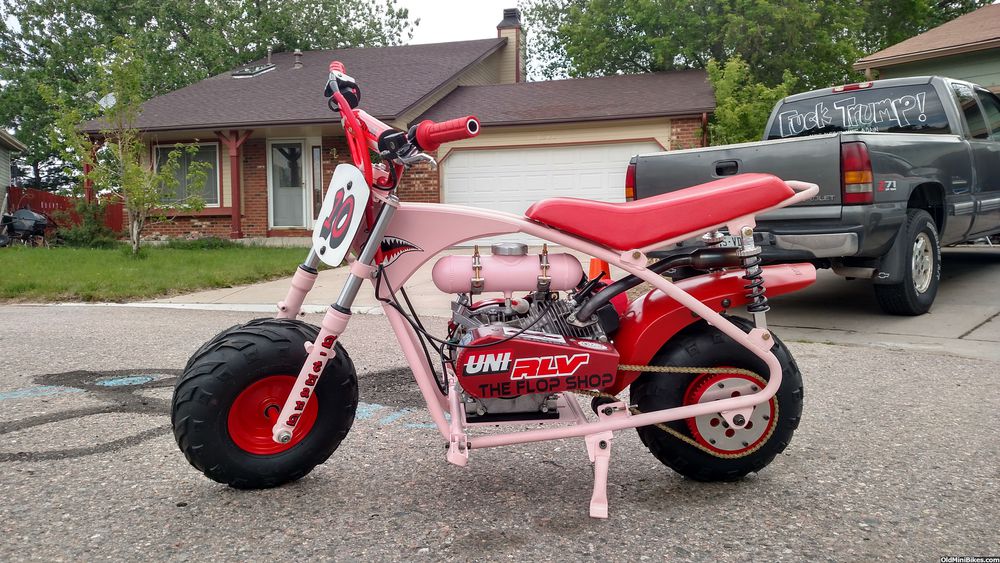

Finally done boys, try not to cry...lol
Testing and final submission video(s?) Coming next
Holy shit! I've been "testing" all afternoon! Lol! Hands down the best bike I've built yet! This thing hauls ass, but is confidence inspiring! The suspension works perfectly absorbing all the little bumps in the road. I only wish I had a GoPro to take y'all for a ride with me! I've never been this fast through corners and curves on a mini bike before! I'm absolutely tickled pink! Lol! I hated the small pics in my last post, so here they are again, more visible.
