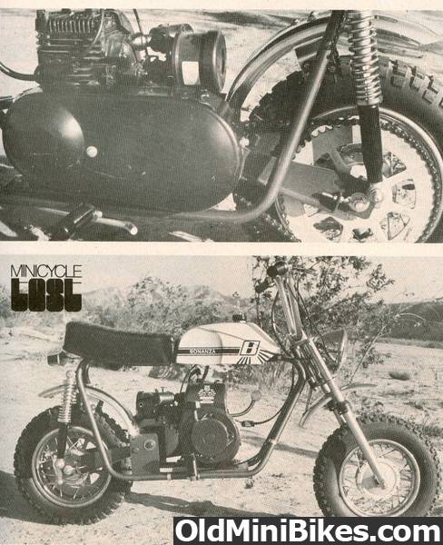

No, not a TAV unit. I'm using a 30 series driven and driver from a TAV but I'm mounting the driven directly to my JS. I want something different and when you use a TAV on a Bonanza they look weird because you have to stand them up. My sprocket will be a #35 chain.
Bonanza had a few 'TC' bikes. Basically thats what I'm doing.
I'm mounting a driven to the outside of the JS:thumbsup:
kbs8ball
Do you have a tall jackshaft mount frame? im thinking 15 or 16 teeth with that 60 tooth on the rear. I eventually want to build the bike in that bottom pic.

I'm guessing they did that for ground clearance?
