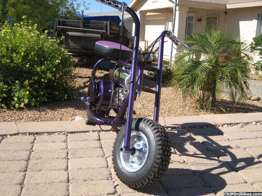

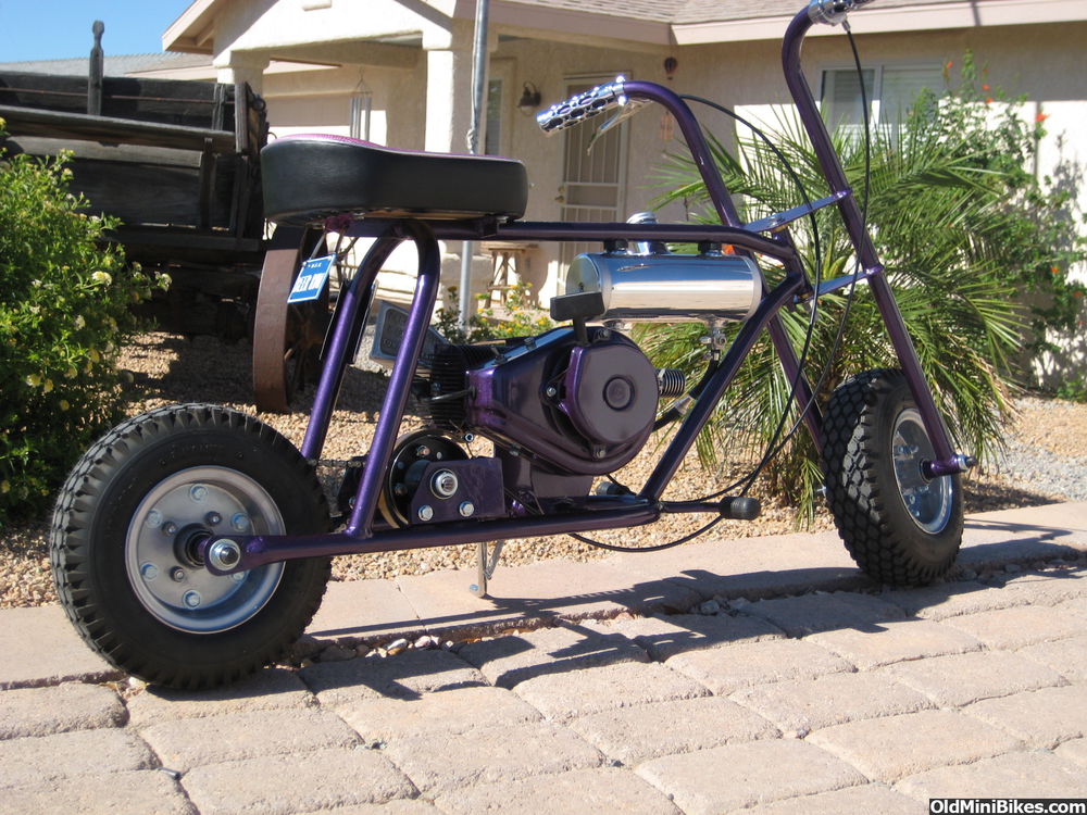

That's a sharp little bike, Dave. I'd never guess it was homemade if I hadn't seen it here
Thanks Andy, it's good to know that my skills are on par with a 19 year old stoner on an assembly line in 1966. LMAO! What am I talking about, I AM! :laugh:
A classic two-stroke and a one-off custom. Outstanding! I have to ask, how loud is it? Does it have those Harley people shuttering? So cool!!!!!!!

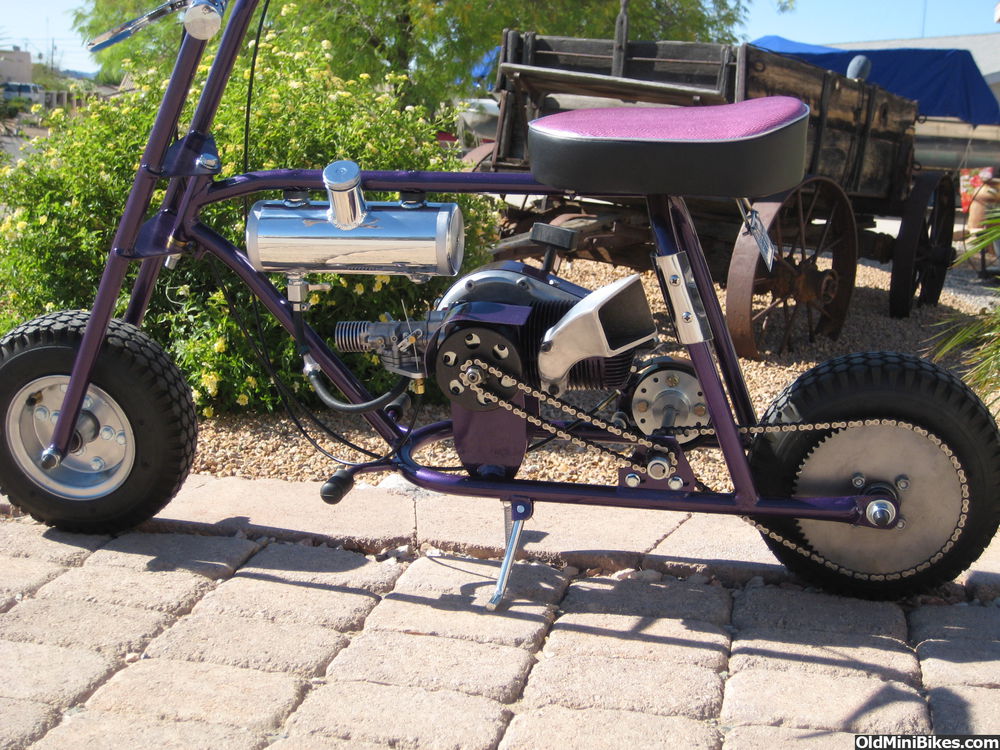

Well.. for a garage hack like myself all I can say is .....Beautiful bike with just enough bling ! Hoping to see a run video if not a ride video...can't wait to hear this little bike .....sing ! :wink:
Thank you Eric. Based on
your Bonanza, you are hardly a hack! Stuffer and carb were a big improvement on response. I did not have the time to get some things chromed. I'd planned to, but oh well. It is obvious that these make lousy mini bike engines. The power band is high enough that for dead stop take offs, it has to be no taller than 5.5 to 1, but it quickly revs out to 28 MPH PLEADING for the next gear. On a kart with taller gears, it would carry very well in the power band. Louie estimates 5.5 HP or so with the gear I have on it.
