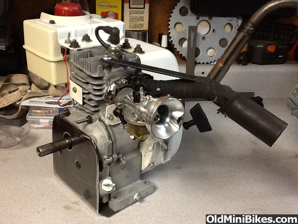

Your not going to find a billet flywheel, not made by anyone. The OHV 5.5 Arc rod fits , and if your lucky you can find a dyno cam for it .
I've got one that has a little done to it . It's got the rod and a 255 dyno cam . Stock piston and flywheel, the intake port has been reshaped with epoxy and running a clone carb .

Wow thanks for the response, your engine looks great!
I noticed your crank is tapped, mine is not. I should probably do something about that lol. I don't want to soup mine up too crazy but I do like the security of billet parts VS stock stuff.
