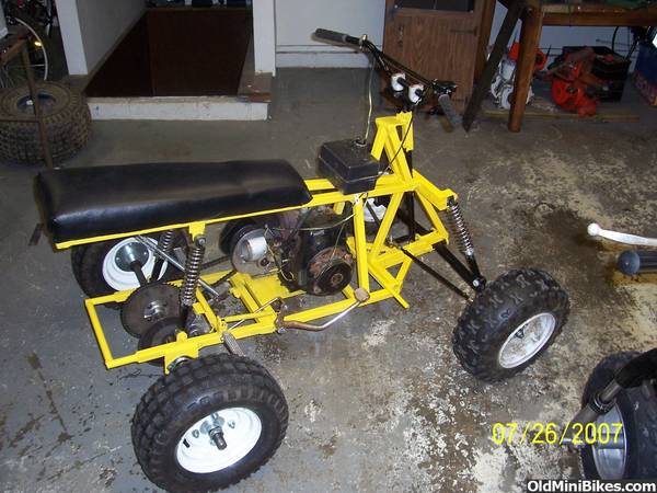

I bought the plans to make this 4 wheeler!!
Hey All, I bought the plans to make this 4 wheeler. This oughtta be fun!!!
If Hent says its ok, I'll start a Project thread as I go Along. I have most of the material at work so I dont really need much other than a seat from
KS8ball. I Dig the old school vibe of it!
Heres a pic!

Vincent on Jays forum has a yellow one and thats what turned me onto it.
Bottom two frame sections are almost tacked together!! Is that one yours?

It's nothing complicated, really. I just sat on a computer chair with a measuring tape and figured out what the basic dimensions had to be to make it comfortable. Then I built the whole thing around these measurements, based on the items I had collected, while keeping it small enough to fit in my truck's bed. Forms follows function, as they say.
The most important thing is to have all the important items (engine, clutch wheels, etc) before you start working. This way you can make sure everything fits together and you don't have to go back and hack the pieces you just welded. Changing something on paper is easy and costs nothing!
I just bought those plans off ebay as well, Looks like a fun project but the thing I don't like about the design from what I can see in the picture is that a single arm is used for the from suspension? I think you hit something light it would bend that all outta whack. I'm thinking of a double V wishbone style like a real 4-wheeler uses, otherwise looks like a great project!
