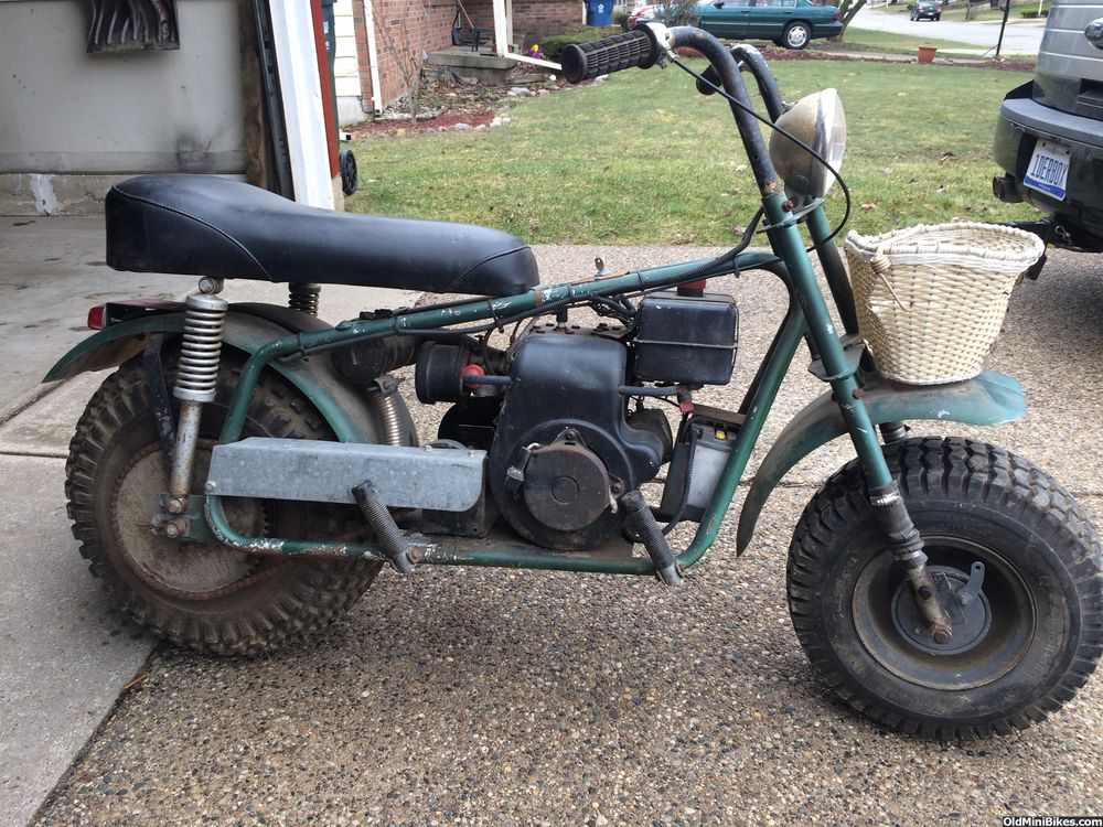

Just got home with a Heald VT-7 .. Pics ...
It died on the trail in 2003 and has been sitting in the shed ever since, 14 years.
Tires hold air but are weather checked.
The gas tank is bone dry.
plug was covered with soot.
I pull the ripcord and it dosent feel like there is compression ..
I don't see any holes in the block.
Oil level is where it should be.
It has spark.
I put in a new plug and a bit of starting fluid, nothing.
Gonna do a bit of disassembly and see what's what .. a blown head gasket would be nice!!
Here are a few pics ....

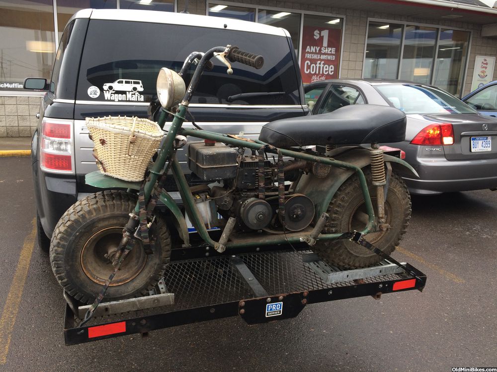

Here she is on her way home ..

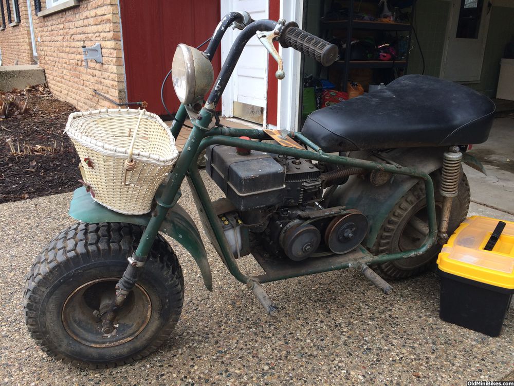

Right side ..
Left side ...

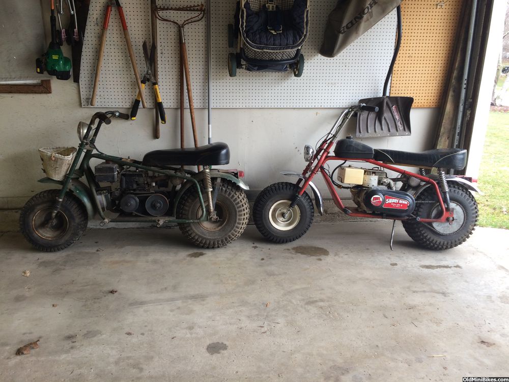

With the VT-8 ..

I had wondered how much difference there was between a 7 and a 8. I figured they were a little smaller but those 2 look to be the same in all aspects except the top bars.
Curiosity question... Was Green a factory color?

Top frame rail, front end rake and handlebar height, rear wheel mounts, jackshaft .. likely other stuff ... hope I can mount a Heald tank to the frame ...
The paint is rattle can green ... I wanted a bike I could do some mods to, not a clean survivor ... Dorothy fits the bill ...

Factory color for the VT7 is blue. Yours looks to be mid 1972 and up it has the plastic t/c cover mounts. Metal cover would have been flat on top with 2 bolt holes. Very nice find all complete.

Vt8 & vt10 both have a "horizontal" front on the top tube before it drops down. Good score.

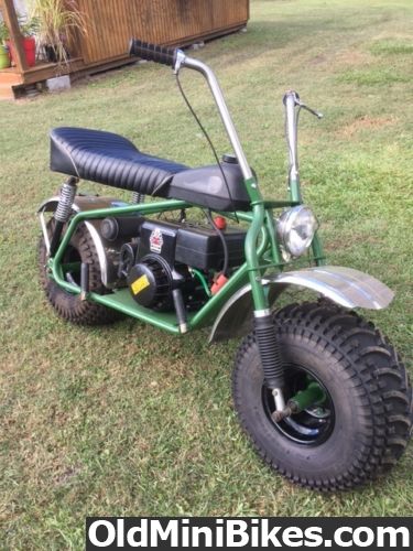

this is my restored VT7 early 1971.
Your bike is pretty well optioned. Lights. Front brake. Electric start
