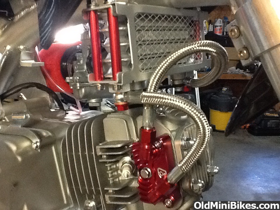

why would you need to remove some cooling fins? I didnt on mine and its on my ct70
also you need a cooler
My lifan oil temps would get around 225 I think which was good but still a little warm
the piranha got around 240 and I think from a chart I read 250 and higher really reduces the oil life
with the cooler im around 210 or less
