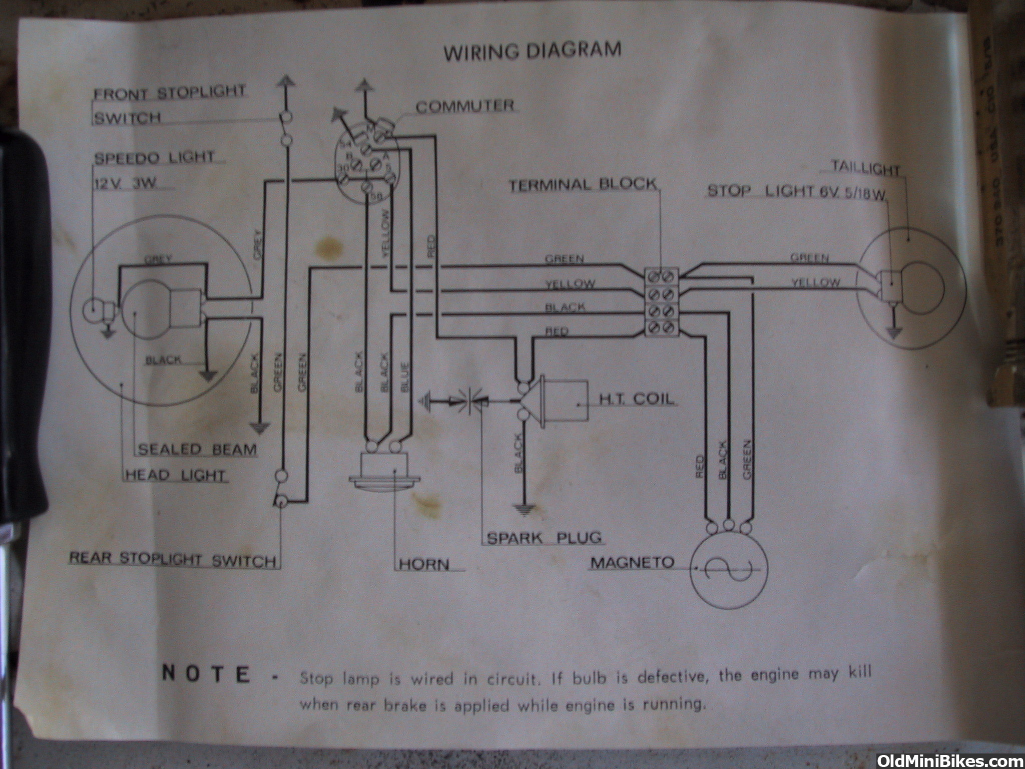

Can anyone help me?...looking for a wiring diagram for a 1970 Benelli Buzzer or if there is a certain starting procedure, kill switch, etc.? Thx JB:mad2:

This is the diagram in the optional CEV light kits Benelli supplied. and reads/shows the same as in my Hurricane 65 owners manual.

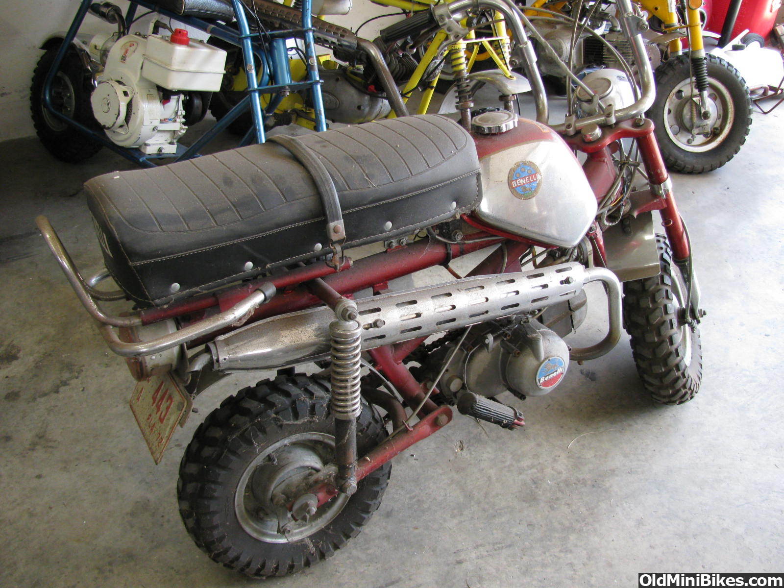

note the writing on the bottom, taillight need to be in the bike and working. It shoudl be a good match to the buzzer, the hurricane uses the same engine as the buzzer (my Hurricane for reference)
