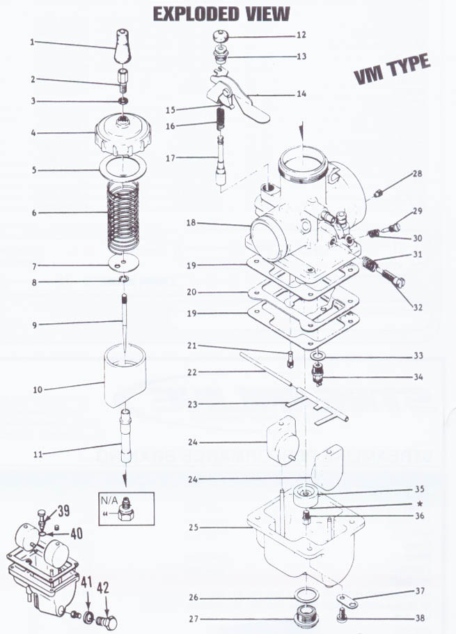

My buddy had a VM22 on his 200cc two cylinder ATV. After he rebuilt the carb, it ran pretty much the way yours is. I dug in and found the needle retainer plate was missing. When the throttle was closed, the needle would push up into the piston and let fuel flow out the main jet. We ended up loosing the retainer plate so we hacked one out of a plastic washer.
Also, the main jet size will do nothing to adjust the idle mixture. It is only for 3/4 to full throttle.
Here's an exploded view of the carb. The retainer plate is 7:
