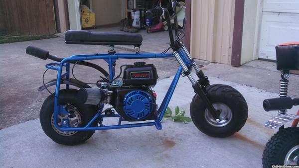

There is a Doodle Bug forum on this site , OldMiniBikes has a ton of stuff available for them , I like the older style DB30 , you can put any clone on em easy , if you are mechanically skilled you can cut new slots for mounting the engine , I'd advise searching posts on engine swaps to learn the tricks to making it simple , or they sell an engine adapter plate for $40 that your 8yr old could do by himself ! There is a sticky on the DB forum for engine swaps !
this one I just finished and I got the ideas from jdogg , he's a member that built an awesome DB-30 and I loved his design and was more than happy to help as all members are , get something and get started :thumbsup:
