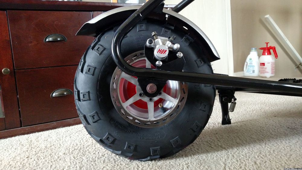

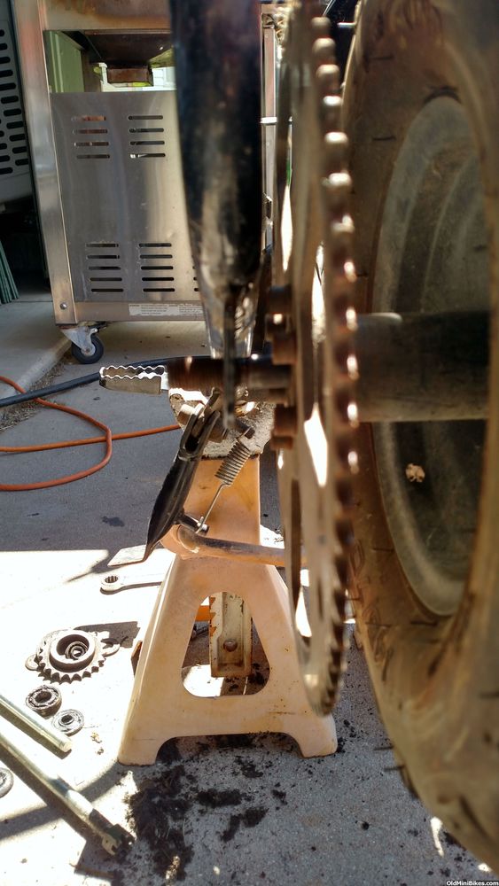

The dude I got it from said they couldn't keep a chain on it and it was pretty obvious why. Both rear wheel spacers that center the wheel were missing and it had some kind of generic gear, bearings and washers attached as a tensioner.
Luckily I have extra front spacers to cut down and my daughter's Motovox to reference.
With the rear wheel centered, a new tire ordered and the Jerry-rigged tensioner removed,(have a proper spare tensioner amongst my many parts) it was time to do something about the hideous plastic fenders...

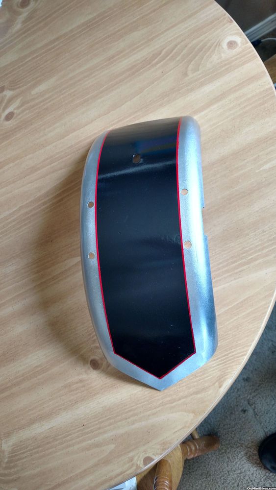

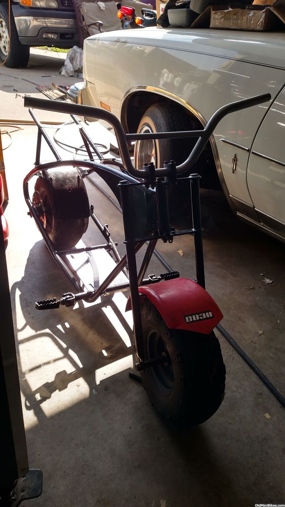

Going back to my spares, I dug up a couple of Doodlebug fenders and a lower set of MX style bars off my daughter's old Raxor MX350 electric dirt bike and swapped out the rusty handlebar clamp hardware. I carefully and evenly bent down the original steel fender brackets to mount the DB fender right over the back tire.
The lines were bothering me and the fender needed some cutting and re-shaping to look like it belonged.
I then moved on to the front, making a nearly identical matching front fender out of another rear DB fender.
Making use of my spare parts, I am trying to keep this one on the cheap. Custom fenders free...

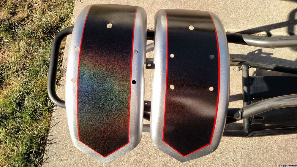

Thanks man. Your compliments and suggestions are always appreciated.

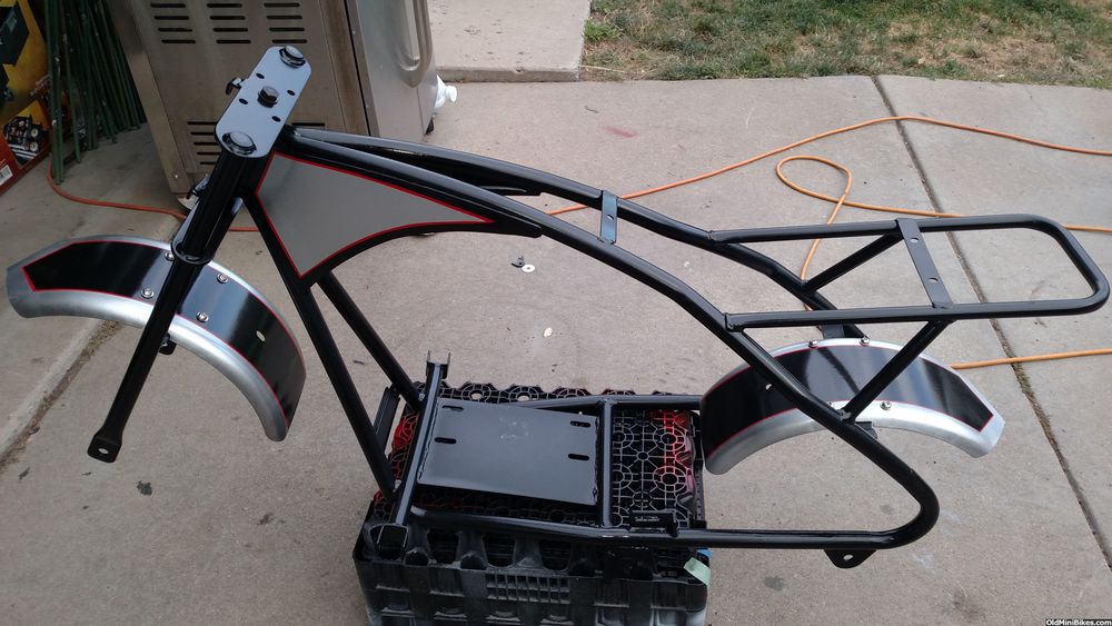

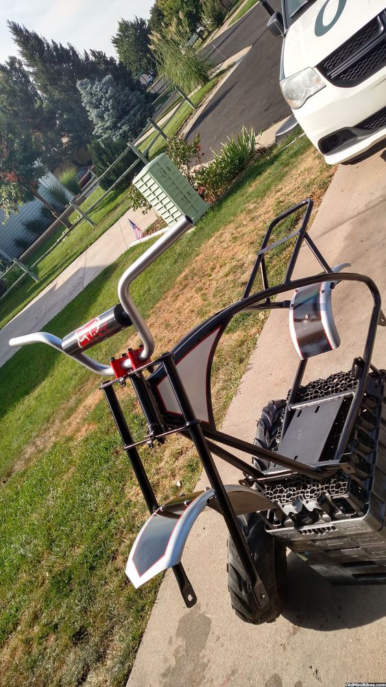

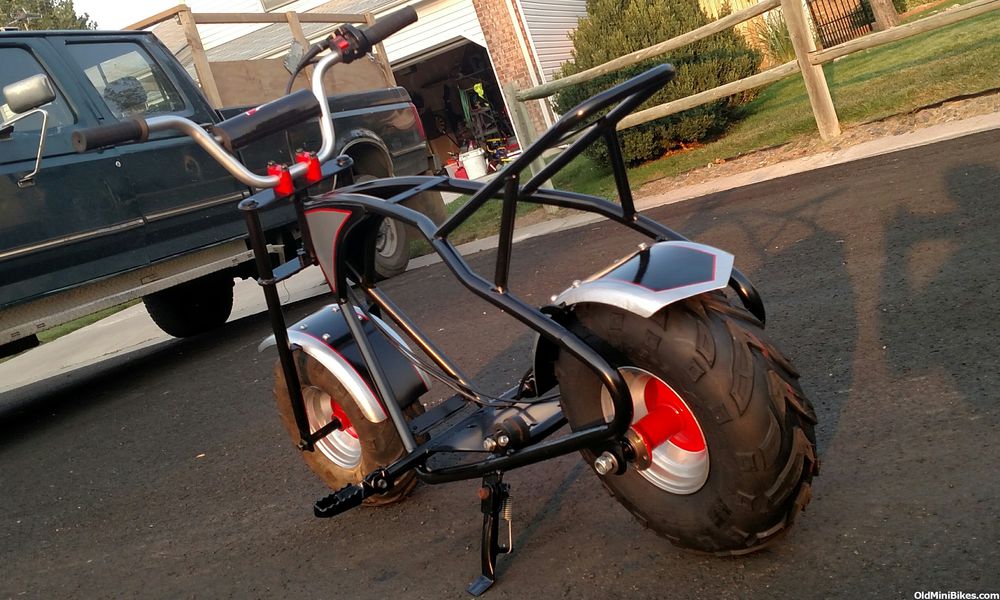

Got both fenders done, and now out in the light, when the sun hits it just so, you can see the metallic rainbow shimmer, you couldn't see inside.

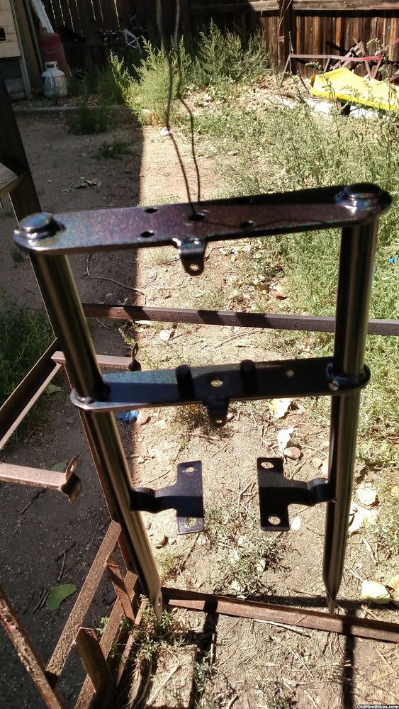

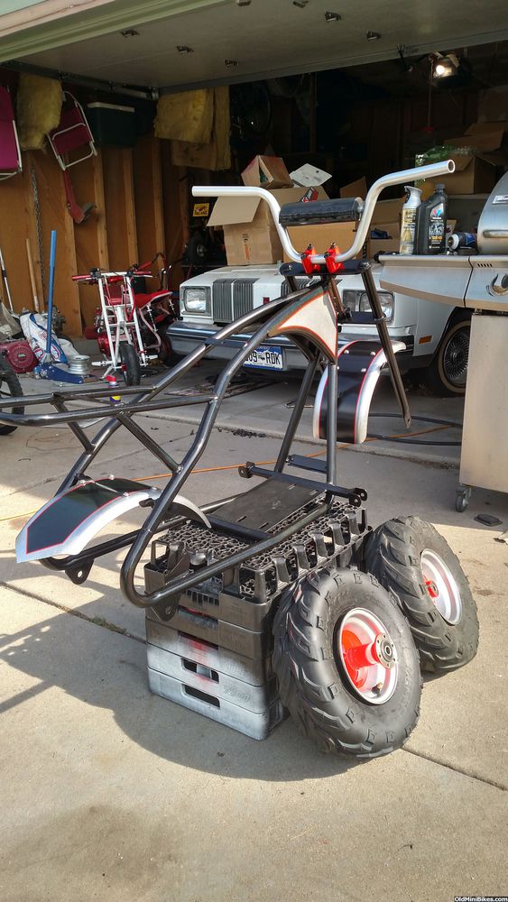

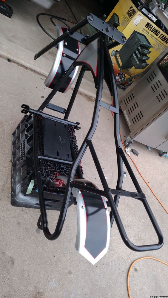

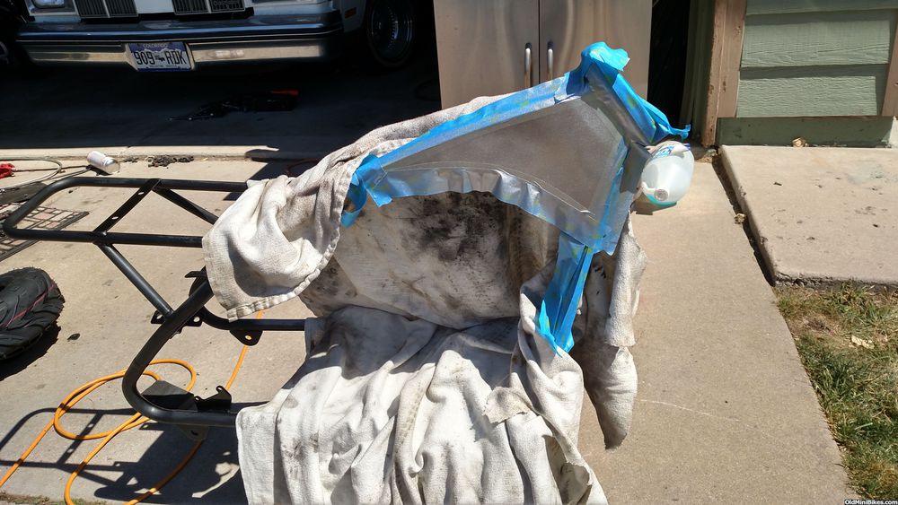

A long day of cleaning, masking and painting. The forks are done. I will let the silver and red paint on the faux tank dry overnight, then mask back over my design and shoot the rest of the frame in gloss black tomorrow morning. Then remove all the masking, make any touch ups by hand necessary before shooting the metallic clear coat.
#8
Had an idea to use some bailing wire to hang my frame from my daughter's basketball hoop to shoot the gloss black...
Worked out well and I will let the frame dry overnight before shooting the clear coat.

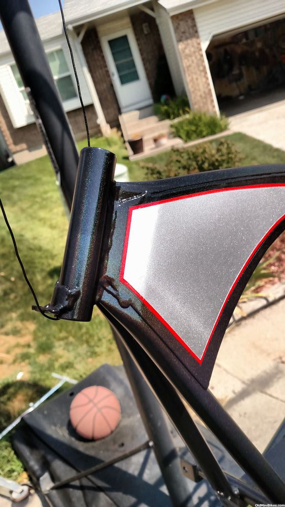

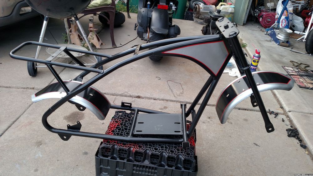

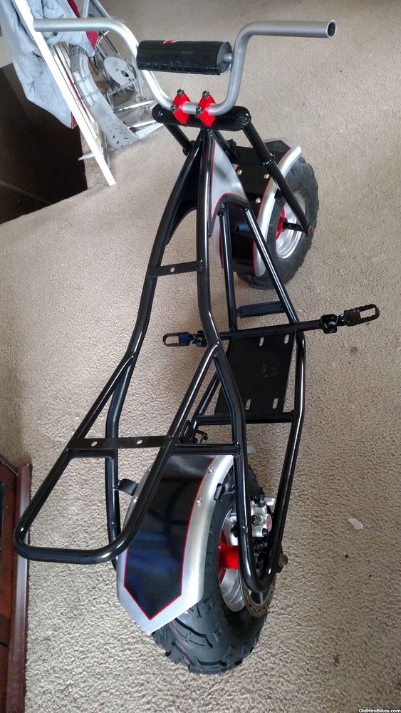

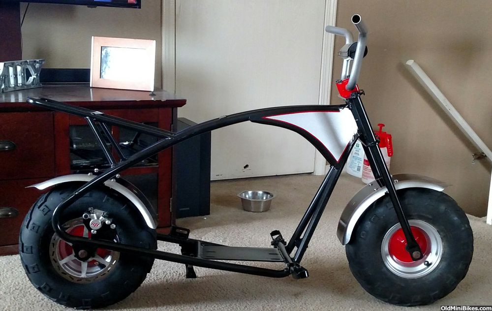

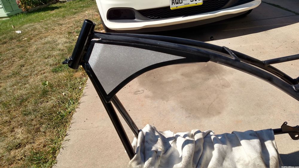

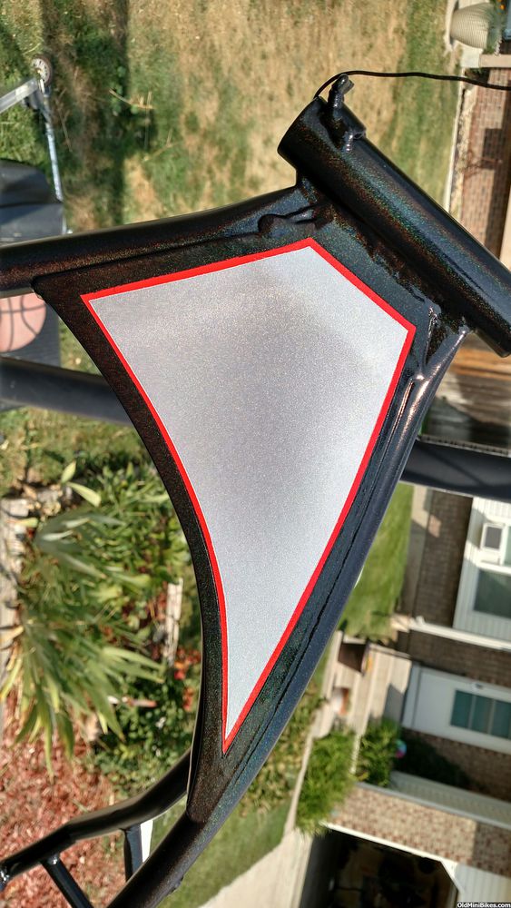

Got the frame finally finished and am stoked with my rattle can paint job. Pics just don't do it much justice. When the sun light bounces off this thing it's beautiful.
I tried my best to get a good shot of the top of the frame, but my pics keep coming out shadowed and blurry. I did manage to capture it good on the steering stem and tank. The flake job dances in the sunshine and changes colors at different angles.
