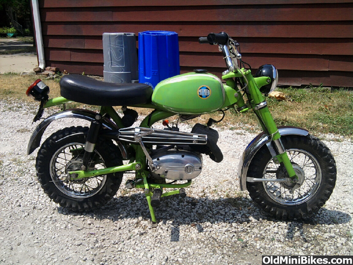

#28
I am trying to get this bike back together piece by piece. i pulled the tank out of storage I had powdercoated and it had rust bubbles under it. So i bought a NOS tank and I am in the process of getting everything else done.
I still need the wiring setup to the coil, I dont know which of the 3 wires goes where?
Can someone help me with some pictures so I can see the colors and where they attach. Thank you!

#29
Well....I cant see the wires, and I don't have a schematic, so start like this. one wire is the lighting coil (for the lights), one wire is power for the ignition coil, and one wire is for the points. You will need to do some kick tests with a volt ohm meter to identify them, then go from there. Don't be scared!
#30
I did do some volt readings and i adjusted the points on the stator so everything is flowing smooth. I did find different readings off of two of the wires, But i still do not know who goes where, and I am not sure which side of the coild is + and -. Its hard just to gestimate this stuff and also I am battling the idea that the coil or the points could be bad and not producing enough voltage to spark because I have tried alot of combinations!!
