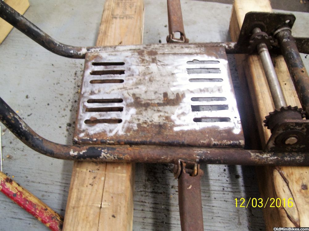

This is the frame when I first got it sometime back. It never ceases to amaze me how people junk these little frames up with welded on pieces and then totally butcher up the engine plate.
Another day off for me today so I'm hoping to get a set of forks made for this frame.

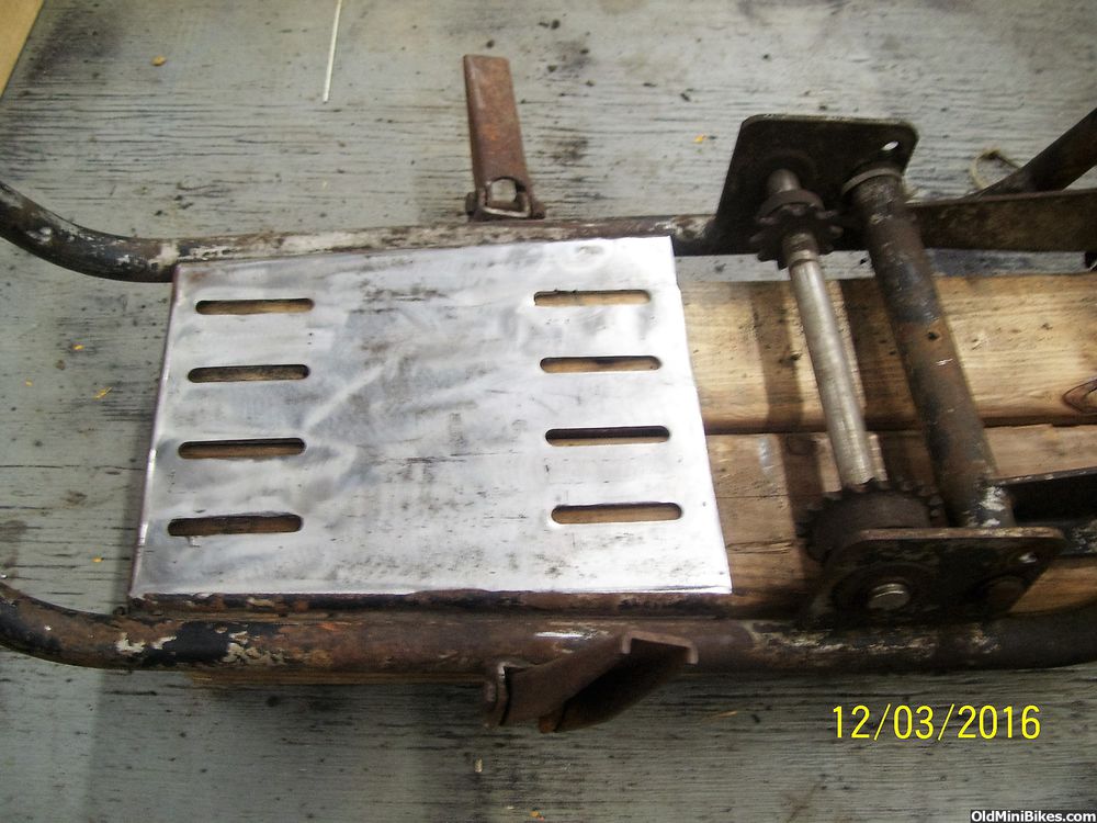

Looking forward to seeing this come back to life... The engine plate sure looks better. Did you just fill or weld sm pcs of steel?
#13
Hey Mark....I ended up using some flat stock then cut them to length.. then welded them in. Looks better, but I still have to work on it a little more yet. :weld::grind:

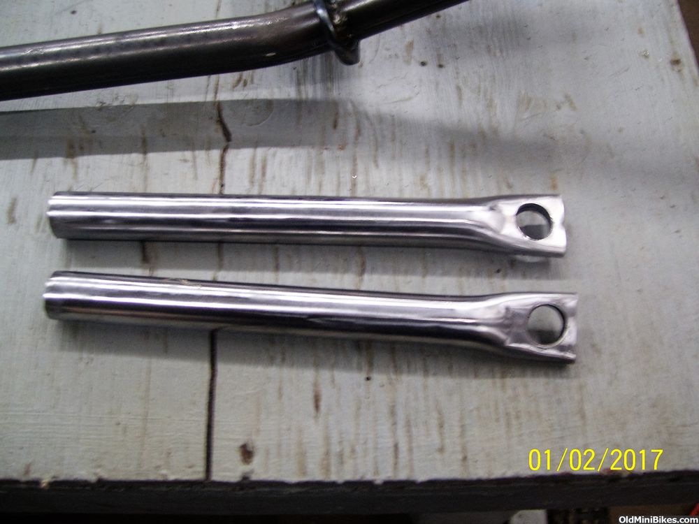

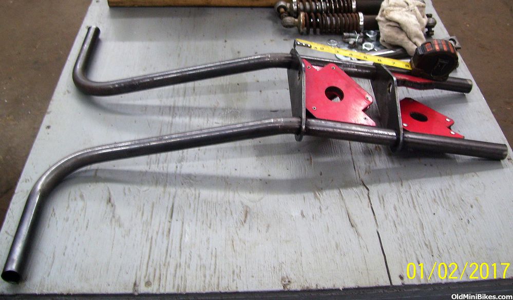

OK... I've been working on forks this morning and no not the original Bonanza forks . This is a MX frame originally but I'm not going that way with this build. Its going to be more like a small tire BC or smaller bike...I'm going with 6'' wheels and tires. Anyway this is the forks that I came up with, I went a head and bent the handle bars in while I was bending up the forks. Might not use the handle bars....don't know yet, but they would be easy enough to cut off and replace with bolt on bars.
These forks will be externally suspended with chrome springs and welded on spring cups.

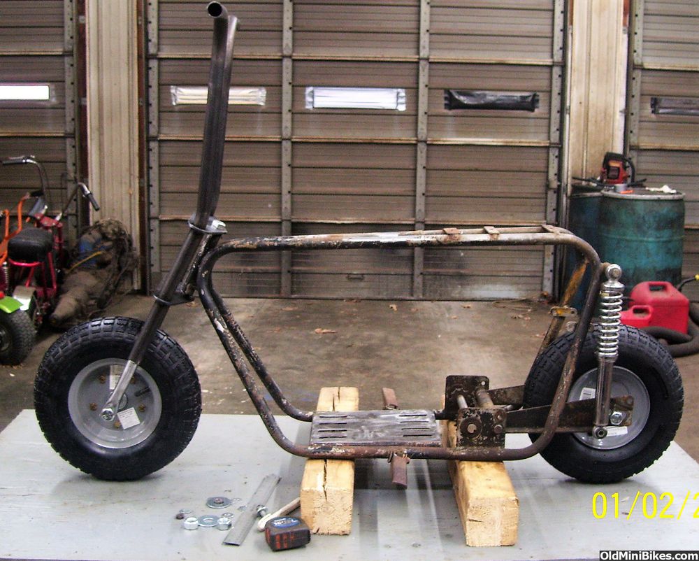

Quick mock up with some 6'' wheels and tires that I had on hand. This is the ride height that I'm looking for.
I'm going to have to find some 10" rear shocks to get it at the right height.

I like that stance .... My bc1200 drops about an inch when I sit on it !! But I am no light weight .. Lol
#19
The front forks and bars look great.:thumbsup: I'm sure this will be a cool bike. Might be your favorite driver.:laugh:
