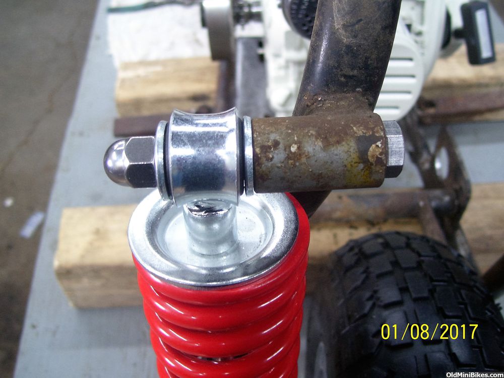

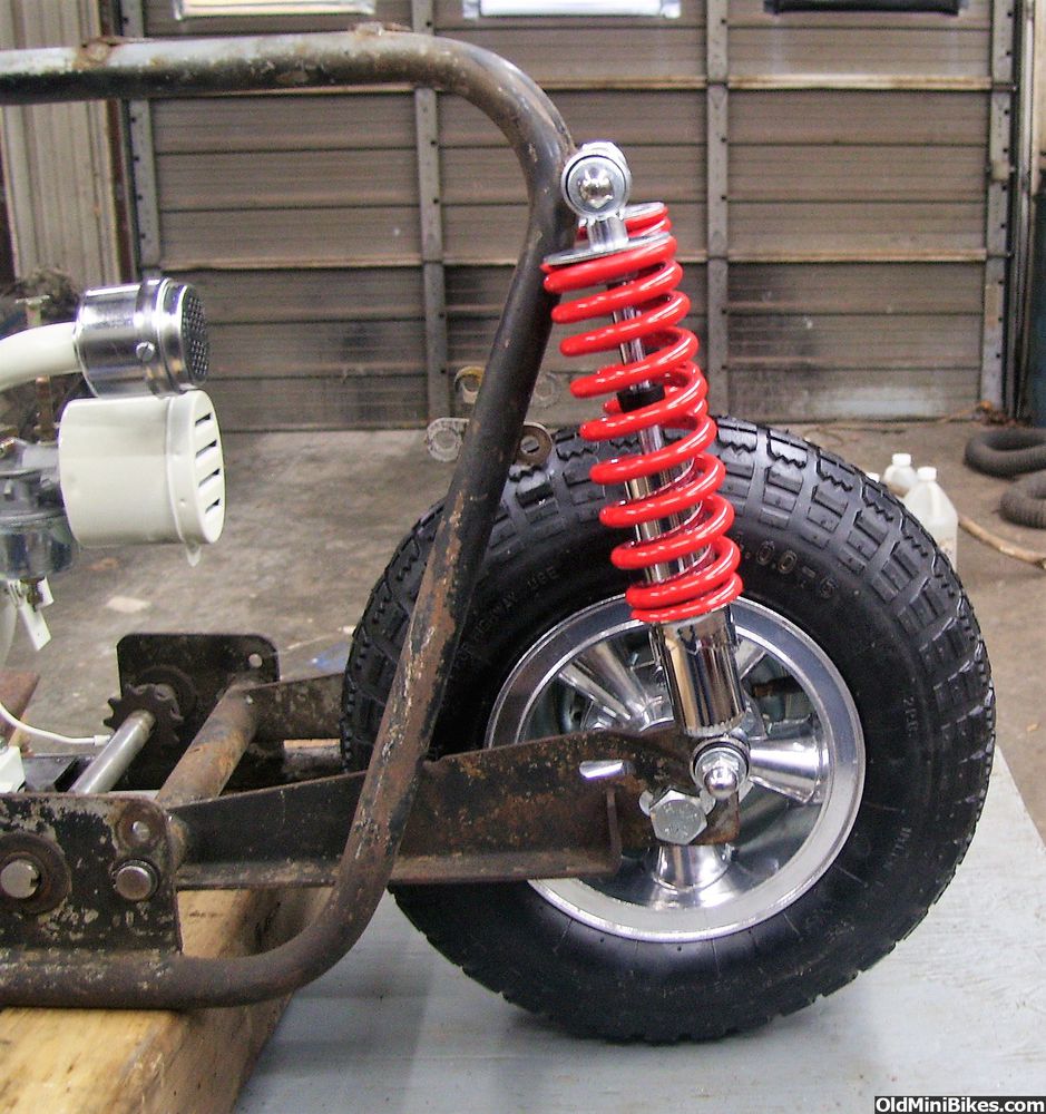

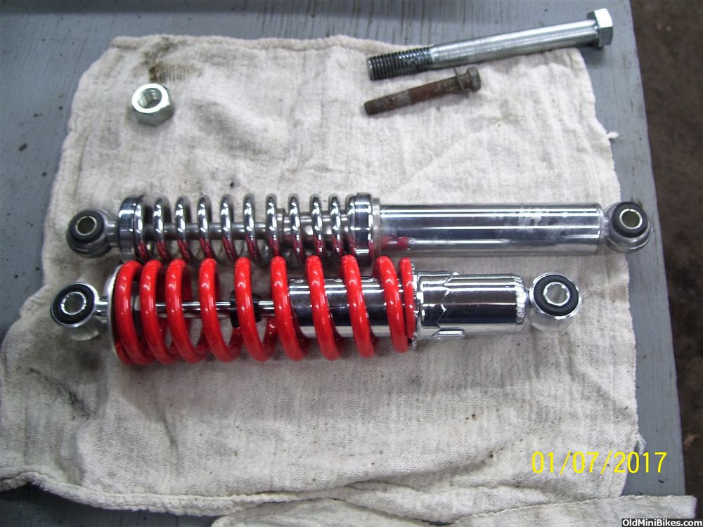

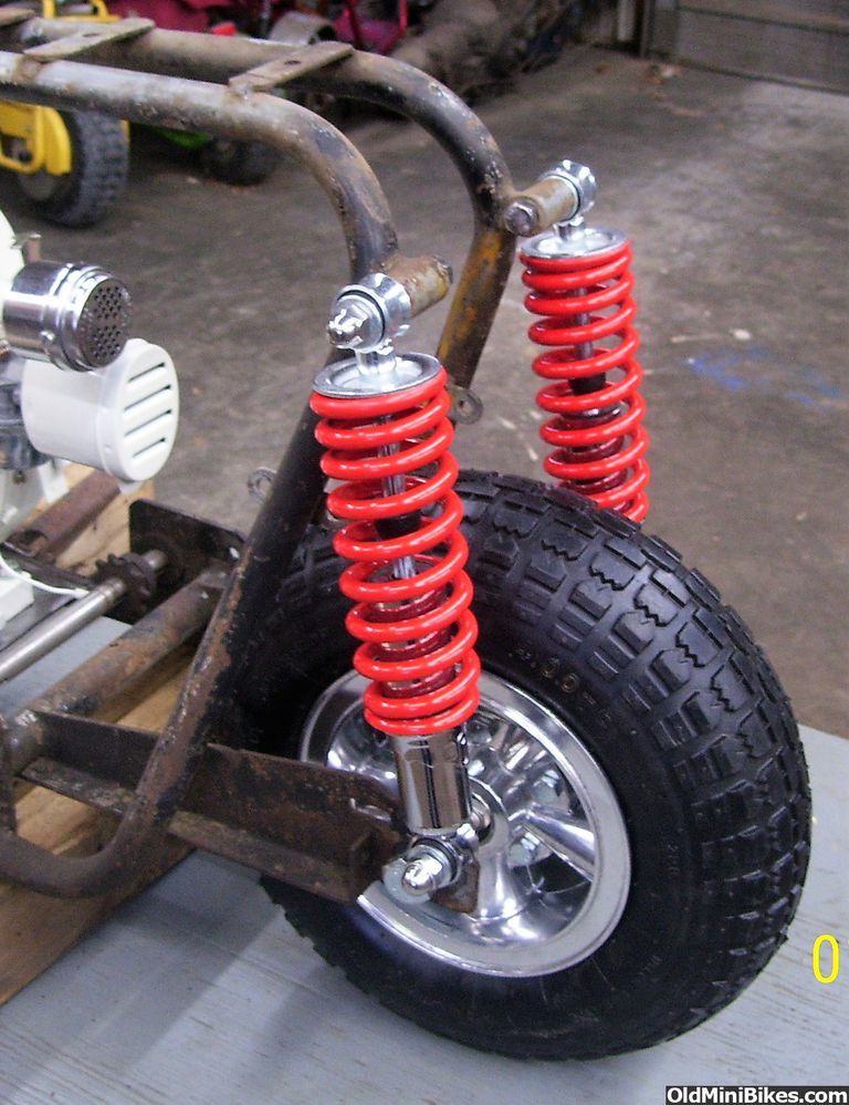

New 250mm x 10 shocks (10'' x 3/8'') compared to the regular 12'' mini bike shocks. I kinda like the color of the springs . :biggrin:

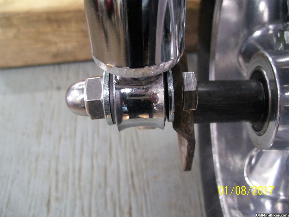

Stainless 2'' and 3'' bolts and acorn nuts for the rear shocks...all the bolts are a bit to long and will be cut to fit.
Shocks are going to work.
Rear tire is for mock up only.

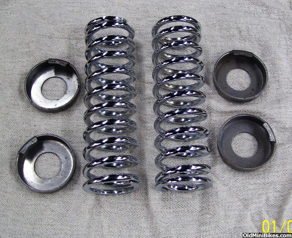

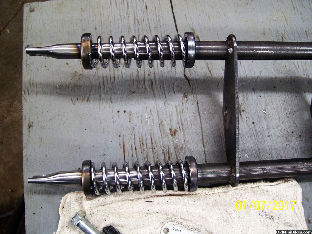

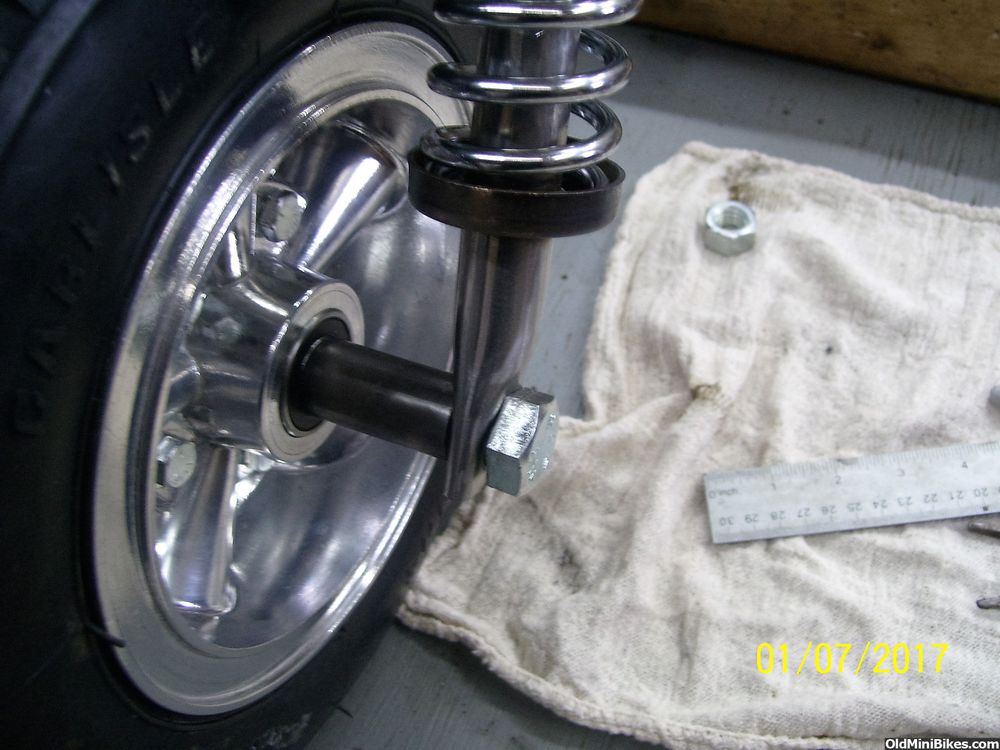

Really nice 5'' springs with weld on cups.

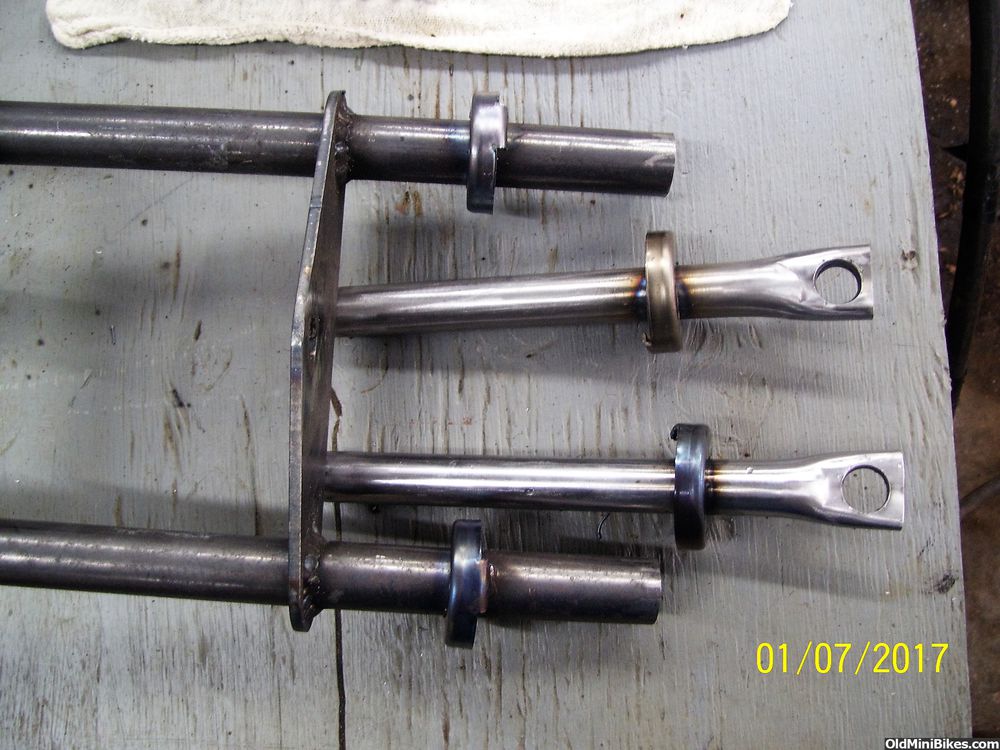

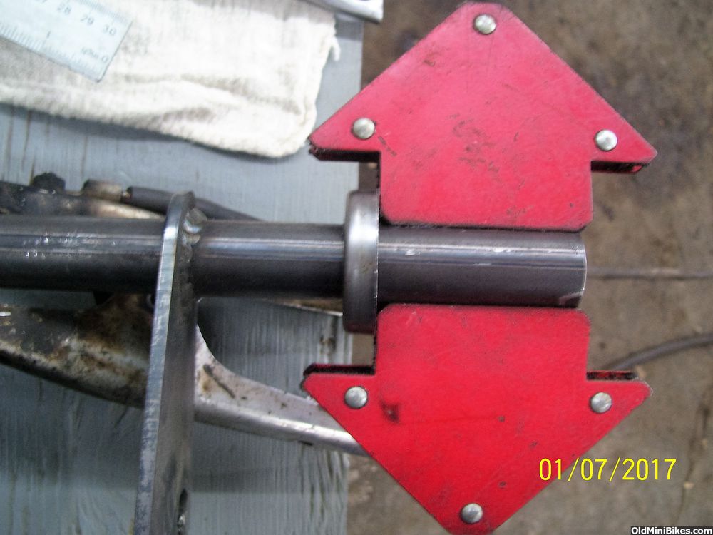

Marked off my fork tubes to weld on the cups...3'' at the top and 2'' at the bottom.
I welded the cups from the bottom side, and will have to clean them up a little with a dye grinder. But no welds on the top of the cups, I think it just has a little bit cleaner look to it.

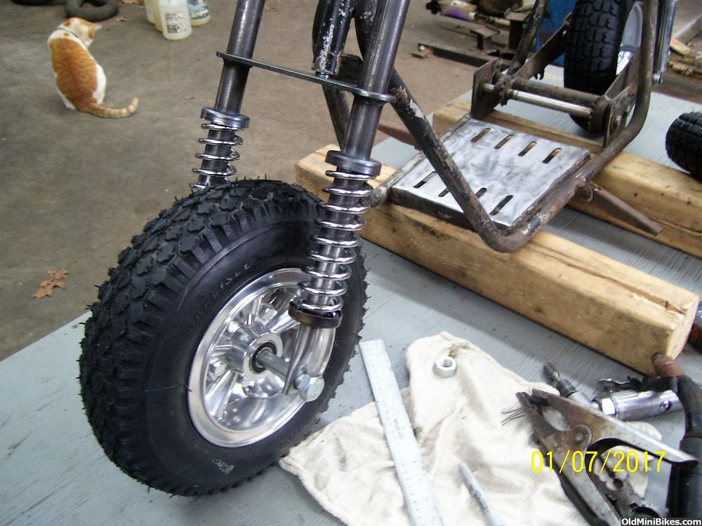

I got the forks done and I think they turned out all right.....and they have plenty of cushion to them.

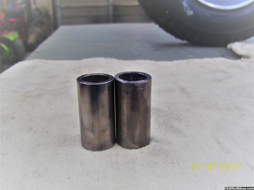

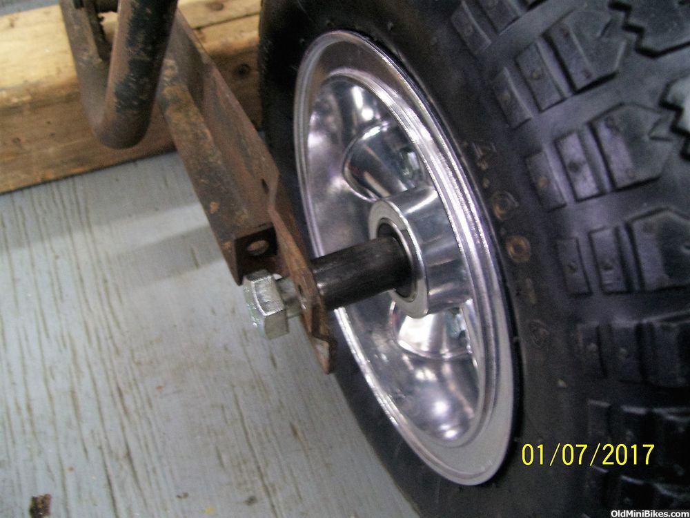

Went a head and made a couple of 1''1/2 spacers to space the front wheel centered in the forks. I used regular 1/2'' pipe and just cut to fit. Used the dye grinder with a rotary file attached to open up the inside just a smidge.
A pic of Tom and the completed suspension forks.....they seem to work good .

Got a little time to work on this Bonanza today...got the stainless shock bolts cut and fitted and snugged down with stainless acorn nuts. If you've never bought ss acorn nuts they where about $2.79 a piece..:xmas-smiley-016: Merry Christmas to me ! :laugh:

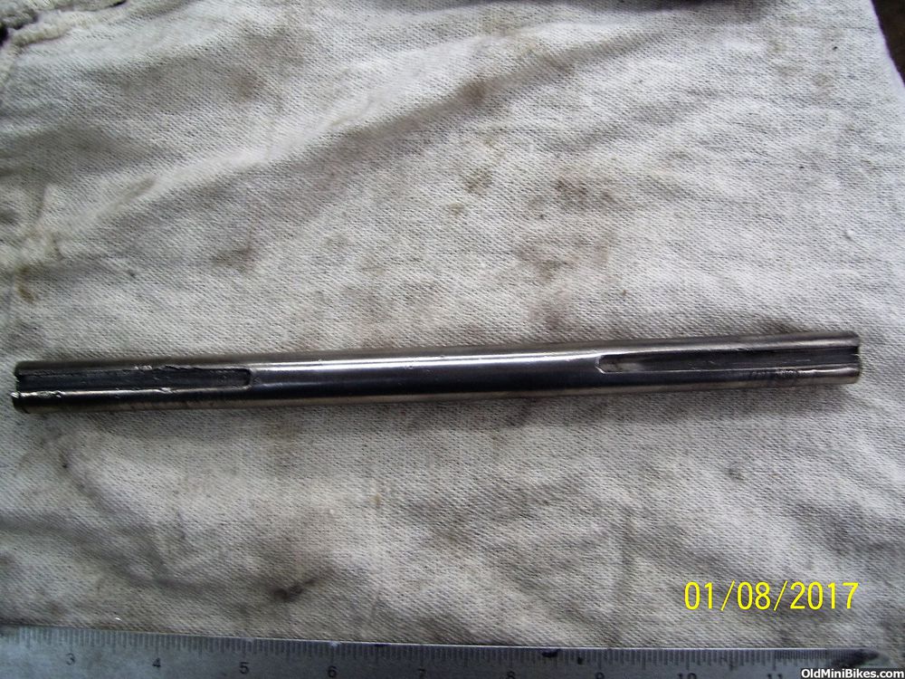

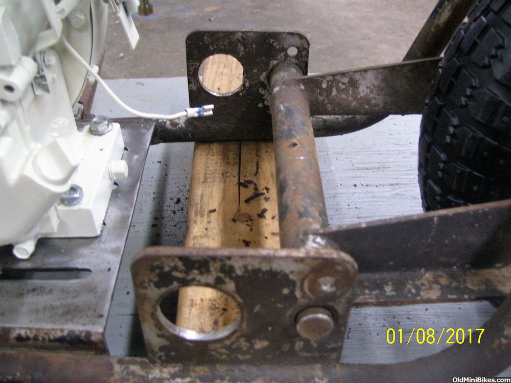

Also I decided to get the 40+ year jackshaft out, and Oh yea it was stuck good....that's when I decided to get out the big guns,:wink: my BFH ..:laugh:
Not a problem....jack shaft its self is pretty ruff...but usable ..maybe.

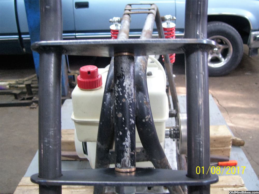

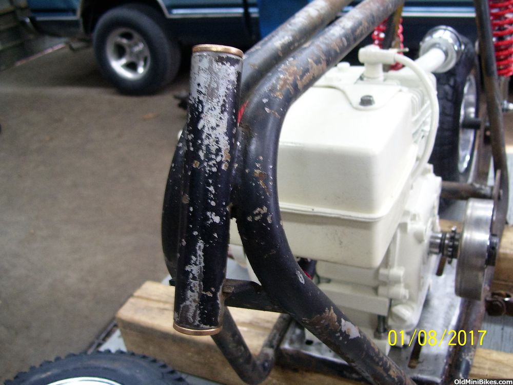

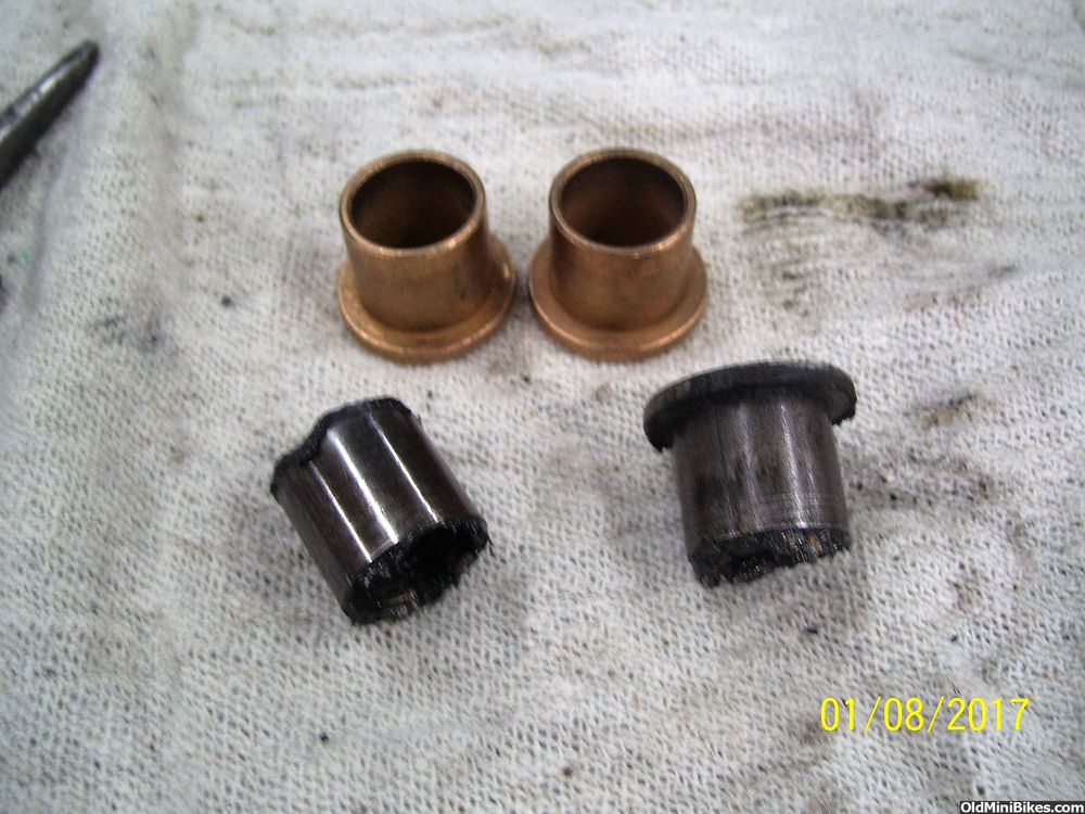

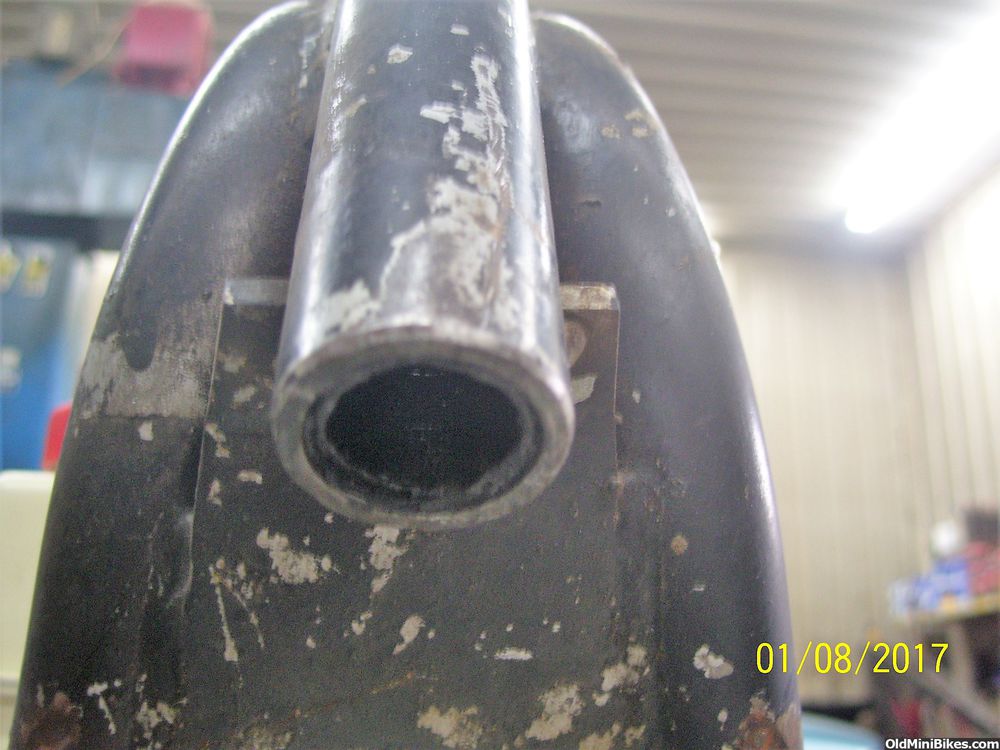

On to the neck bushings....and of course they were bad to...really bad. I got new 3/4 x 5/8 bushings from the Local Mom & Pop.
After new bushings...good and tight again .

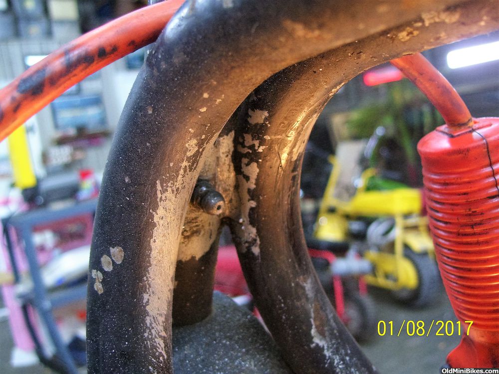

Oh and one very cool little thing I found on the back side of the neck......a grease fitting ..:eek:hmy: What a great Idea !!
Ok... I can see it now! Grease fitting = head stem full of grease.
Then one day on a whim you take it to a little show and park it in the hot August sun... Only to return and see most of that grease has droooooled down the fork across the tire and wheel........ Leaving a puddle of embarrassing grease drool on the ground.
Oh, did I type all that??? I was just thinking it I thought...:lol::lol::lol::thumbsup:
