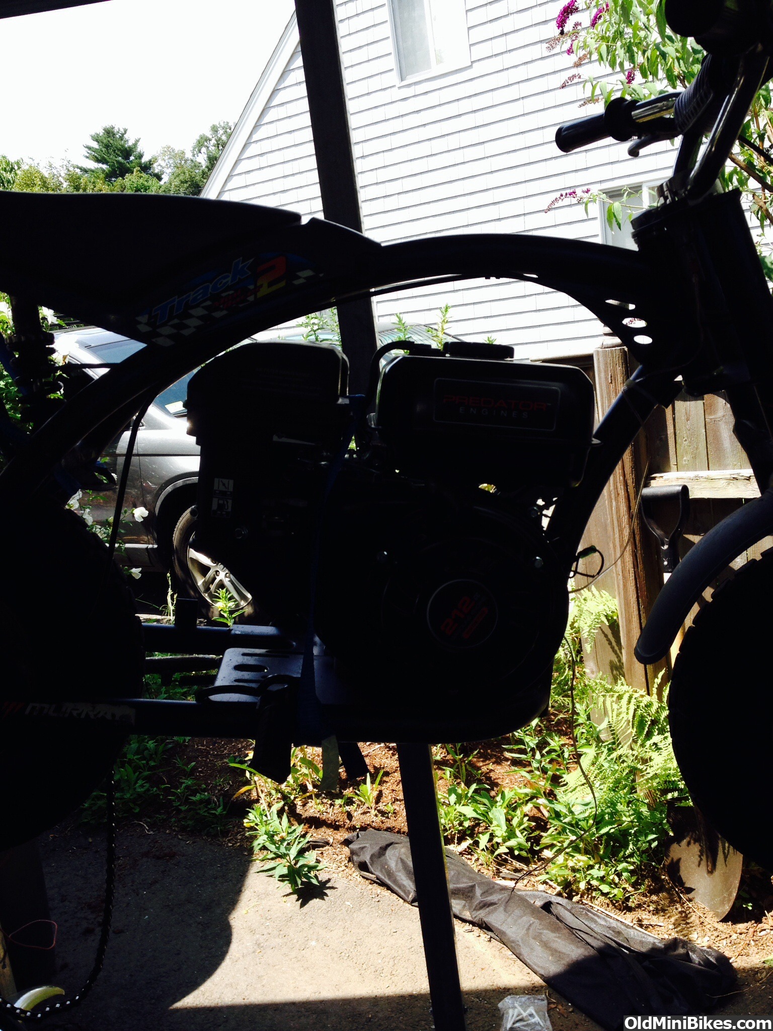

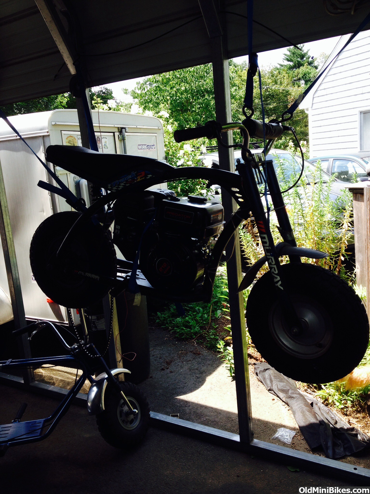

Picked up a Murray Track 2
Picked this up for $125 today... Time to pick up a Predator and make a little racer. I may need some bigger bars though...

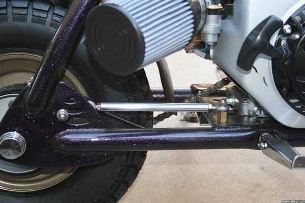

and make a strut to your brake drum...the stopping is 100% better without the flex!
CarPlayLB
Well-Known Member
#8
when you apply the brake, the mount flexes quite a bit and it doesn't stop as well as it can. The strut keeps the band aligned and it gets full contact. It gives a firmer feel to the lever and lets all your energy go to the band and not in the flexing of the mount. I am 280lbs and I can lock the rear tire up!

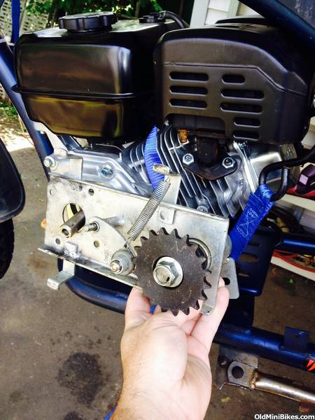

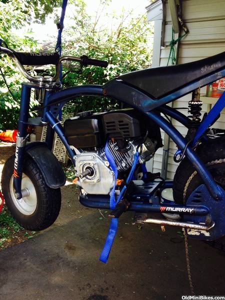

I think the Predator will be fine with a little help from a Mini Baja jackshaft/backing plate. I need to find a cover for the backing plate and a clutch though. I usually just toss that stuff when I put on the Torque Converters. :doah: is the clutch a 420? 40/41?
