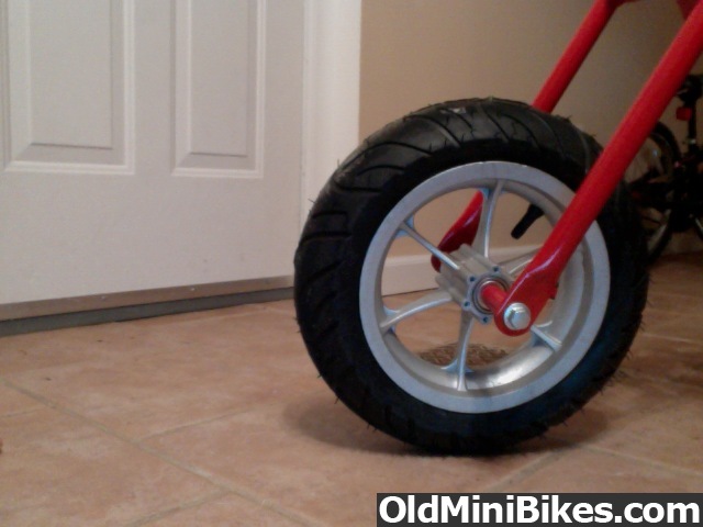

Hey Guys I want to powder coat my minibike rims. Do you guys think it would look good with a the main rim gloss black and the lip red :shrug: Any suggestions? Also, I live in New York anyone hear of AMS Powder Coating or Action Powder Coating? How are they? Also, I heard that sand blasting is no good and metal pellets are better. Here are the websites so you can check them out. Powdercoating and Why You Want Us | Awesome Metal Stuff. Here is a pic of the rim so you can visualize the black rim and red lip. Thanks :thumbsup:

Should look great. When choosing a shop for any task you want to see their previous work prior to giving them any business. As for a blasting media that wont tear up the aluminum you want a glass bead or walnut shells. The shot peen stuff would likely work, the blaster will use the correct stuff. I plan to powdercoat some aluminum wheels eventually and will have the same place do the blasting since all I have is an open air booth and sand.

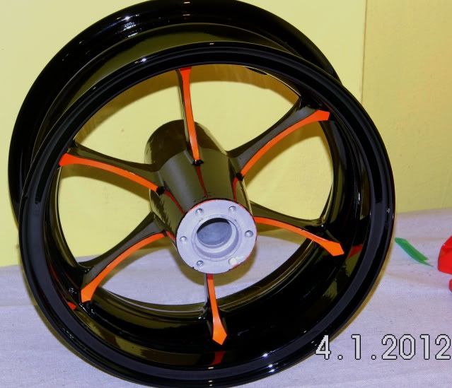

Powdercoating adds some thickness to the wheels and makes mounting a bit more challenging. Use lots of soapy water and be patient. Took me hour and a half to get these mounted. Thin, stiff, sidewall and the extra thickness made these very hard! I actually got so good at these that I did the rear one twice! Mounted the tire backwards! Doh!
