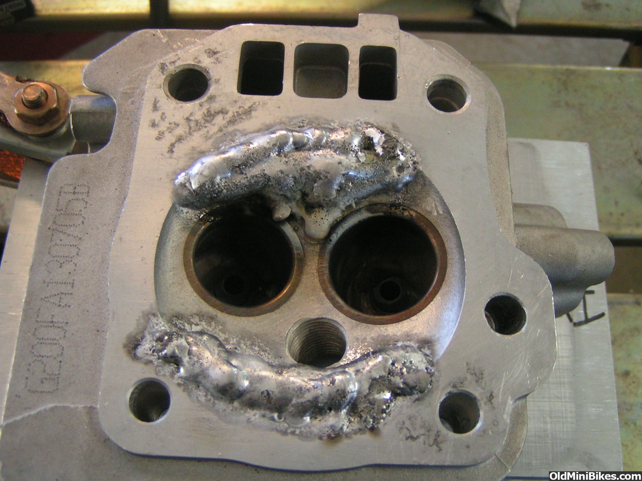

I am still playing around here with this head and now have a welder and a machinist to do the work.
Just need the rest of the engine to complete the mock up.
This is where the wind is blowing.
About 2cc of weld and .050 of mill for a target of 16cc.

Yes after first pass but I tried to use a mill with a ball cutter to shape chamber and thought I could follow the contour of the bowl lowering the knee. Screwed up the head but digging a trench next to the seat. Then went back and tried to fill up the trench and messed up the seat. Good thing I bought Gerald's spare hemi head. I'm sure I could do it now by just staying away from the seats by at least 1/4 inch. Don't know if that heat will loosen the interference fit however.

I don't have a mill.
I was going to try and reshape the head by hand after welding.
Risky idea on my part.
That is how it is done (by hand) saw a video on you tube by brodix fixing a head that looked like junk, tigged it up cut new seat pocket pressed in new seat and with a die grinder with a coarse carbide burr proceeded to make it look just like the other chambers. Head was then milled and finished the chamber with cartridge rolls to get same finished as un damaged chambers. Amazing.
BRODIX Cylinder Head Repair Video - YouTube
about 1.49 in he is grinding the welds.
