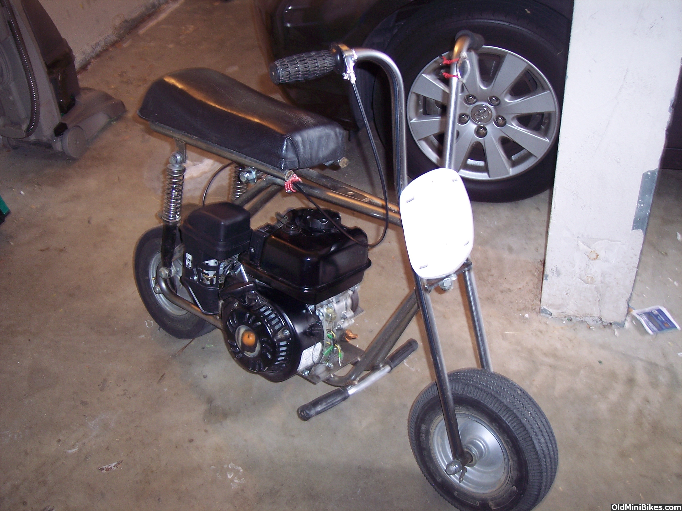

Its nice to see you are excited about your bike as I am with mine. Heres my JC Penney El Tigre.
Mods:
1) Predator 212cc swap. 12/72 gearing, its hard to keep the front wheel down haha.
2) I picked up a beautiful raw rigid fork from Joe's Minibikes in L.A. and its an incredible upgrade over the horribly designed grenade shocks that were original. They have a more aggressive rake than the stock forks, weigh 5 pounds less and are 5x stronger than the original El Tigre forks! Theres nothing like a rigid front end...
3)Box stock mods :thumbsup: I opened up the internals of the stock airbox, and opened up the jet for more fuel. Now the front wheel pops up easier, BUT its more controllable because the throttle response has been smoothed out with the addition of more fuel.
4)The custom made race number plate. I like how it gives the bike that race look. I might put "212" on the plate.
