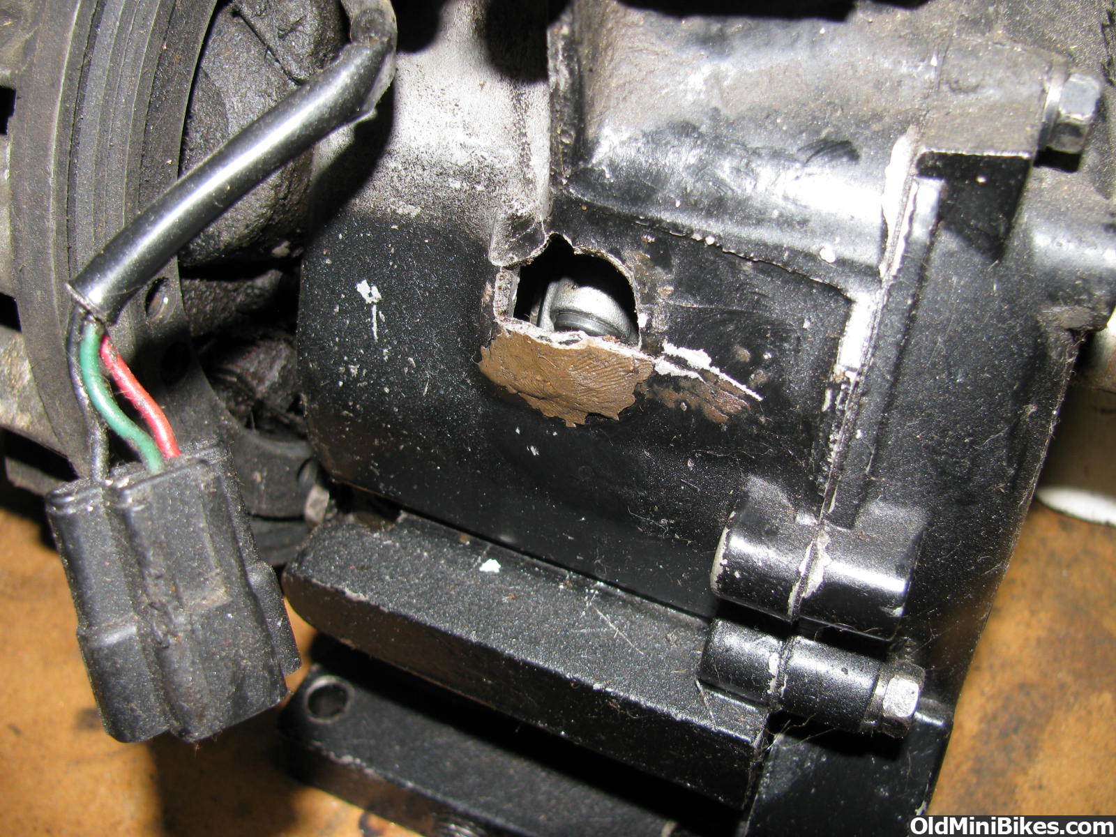

not the best pic but you can kinda see what I mean on one of my old Rupps that had the Dellorto conversion done to it, the pivot will stop against the ear on the block.
No problem, just remember to keep to a short burst rule, try to keep the speed runs short or you could end up with unwanted access hole in the case :laugh: reusable blocks and cranks for Rupps are not cheap an easy to find anymore unfortunately!
