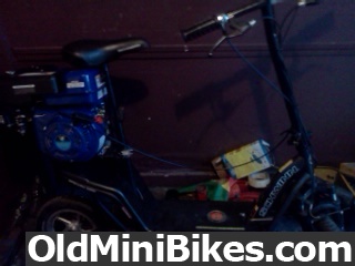

ive done what your thinking about ,i use a schwin stealth 1000 & doodlebug 2.8 motor.get the gearing right & the kids & you will be very happy ,heres pics of mine, first time I tried a swap I used a 6.5 clone which was way to strong for the electric scooter frame, the 2.8 is perfect match for scooter.

birddog1148 - let me know how it comes along & i'll do the same. don't know exactly when i'll get around to it though. i'm waiting until at least the 8th before i buy a predator for the doodlebug. then i've got to get a clutch & see about making my own mounting plate. might be a little bit.
kruger - that's exactly what i was looking for. the one i saw on craigslist had the motor mounted on the footboard. got any tips for me (i.e. did you use the sprocket that's already on the rear wheel or a different one & if so how did you mount it?)? seeing as how the schwinn without batteries probably doesn't weigh any more than the doodlebug i think it should do fine. the doodlebug actually pulls my kids around pretty decently.

yes you must change rear sprocket to #35 chain,i went with 50t rear ,i weld the sprocket to a gear out of the currie direct drive unit then assembled it on rear axle because the schwin 1000 uses live rear axle the s350 doesnt. so take old sprocket of wheel line it.up with you blank #35 sprocket and drill it out,as for motor mount I attached mine to seat pole and also used bolt hole thats used to hold rear plastics down, use 1/4 plate & youll be good to go. good luck.
