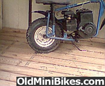

Here's what it would look like with a couple of engines. The original Tecumseh probably still looked best. Clone hangs out one side a bit.

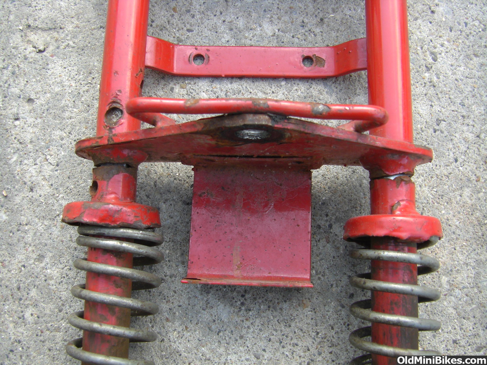

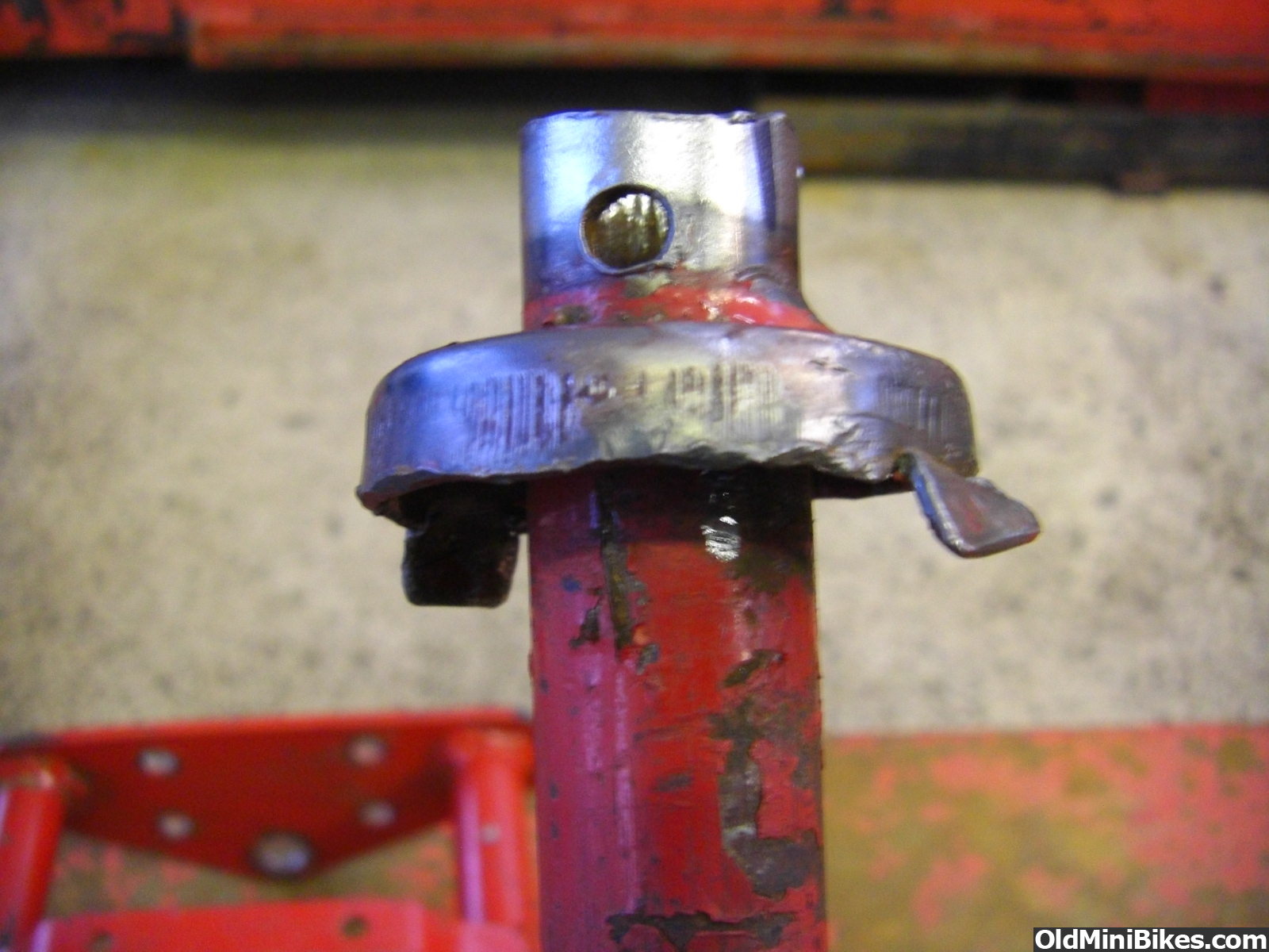

It looks like i'm alone on this one but i actually really like the Thunderbird for a few different reasons. ** A stock Manco Thunderbird is junk in my opinion*** They are easily modified and i was able to make mine into exactly what i was looking for and more. Here are my major issues.

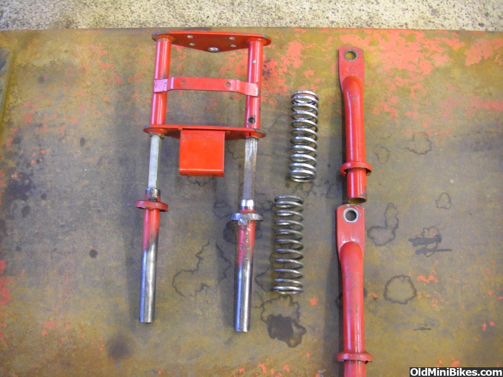

A) the frame isnt exactly what i would call strong but more importantly (from a safety standpoint) my front forks were completely sheered at the welds. The forks took the most time to rebuild and reinforce. They did come out nicely once i finished them.

Summary. I do not suggest this Mini for those looking a "turn key" bike that doesn't need modification. ( see pics of front end before I fixed it)

I forgot that i dont have any finished pics. I wont see it for a while either. Sorry guys. Boy.... i forgot just how badly those forks were messed up. I cant believe i was able to salvage them.
