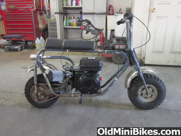

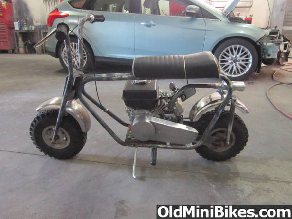

Just finished this one up bc1300 been painted like five times over its life and I thought id leave it that way I put new tubes in the original tires are in great shape no cracking put a predator with stage 2 kit in new grips throttle chains shock springs wheel bearings new clutch neck bushings cables seat BIG thanks to OldMiniBikes for the parts and another BIG thanks to David Wulf for the clutch cover as well. This bike runs and rides very well its fairly high geared but @7000ft elevation its doing 54mph so not to bad.

This bike was just redone for the second time. I built another motor with help from ole4. It now runs way better than it did before. Just over 60mph with a 5.4-1 gear ratio. But didn’t feel that great at that speed so I ended up with 6.25-1 and running just over 50mph at 7870rpm. But ole did say to keep it under 7500 so that just kinda happened oops! 133C81B2-8DC0-4814-A2A5-30A60D909866.jpeg

Looks like it might be time for a steering damper and a recording tach.
Great work, very cool west coast bike.

Bringing this one back. I was just bored and dug this thing out to go for a ride. And it pulled 8210rpm on a incline with my 250pound ass on it. If any of y’all get a chance to buy a head from @ole4 you should. They put it up.

Busted this one out again yesterday when my son said he wanted to ride something faster than the 50mph mini Gote I built and he rides. He watched me take a full pull down the street on it and said no way he wants to ride it. It does still haul ass 63-64 mph all day long. @ole4 you da man.
