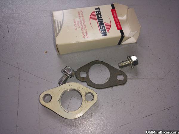

That flange OldMiniBikes has fits the H50 not the HS, its much bigger. The only way I have ever seen flanges available for the HS50 was the adapter/repair one that tecumseh made (has NPT for a screw in fitting/muffler) part number 730165
thats because they are, the bolt spacing is the same between H35-HS40-HS50 but the location of the exhaust is different between them.
The offset in the port is the same between the H25-35 as the HS40 if you flip the flange, you can see it pretty good on the flanges I had copied from an original Tecumseh threaded adapter here:
cool, I have the laser cut ones that fit the H35-HS40 if thats what you are in fact looking for? :shrug: Their $8 each shipped (sorry bryce to cut into your thread)
