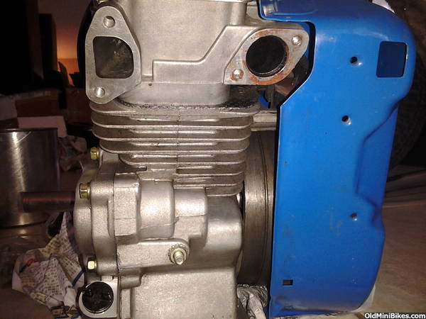

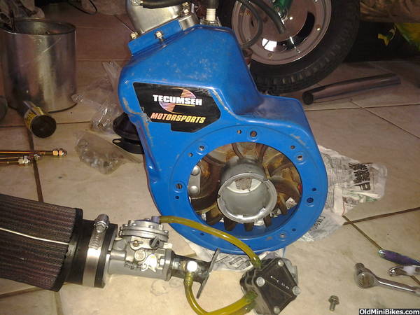

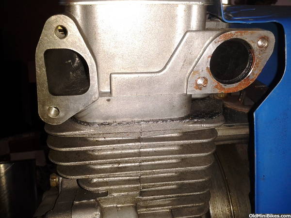

Just got this one used looks like its in decent shape would like any info and maybe a heads up on getting the right size gaskets for the intake and exhaust need 2 check OldMiniBikes still but any parts numbers would be helpful i know it shares a lot with the "powersport" OHV 6.5 that i also own

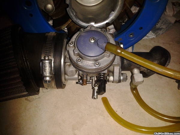

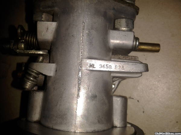

comes with the tillotson and a "homemade"??? intake

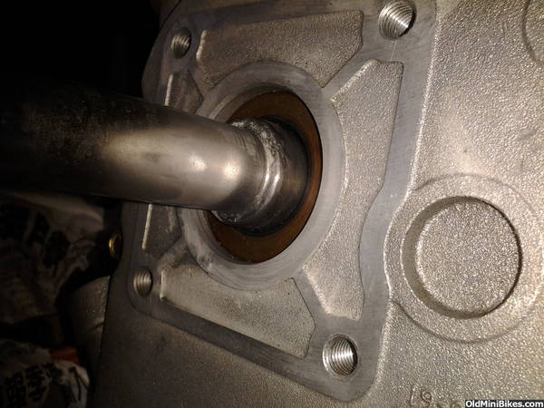

last but not least it looks like the ring around the base of the crankshaft is missing"oil seal"?? maybe??? the hs40 and powersport have that tannish sealat the base of the crankshaft

I have the flathead version and I am sure that OHV one would be stronger yet. The 365B is the same carb the H50 motorsports came with and is a good carb for performance. The engine should also have a billet rod in it as well. That is a oil seal in there why do you think it is missing. You could post on Bob's 4 cycle for more info, Jeff Clements was head of the Tecumseh motorsports group for a while and knows all about them.

Those are great little engines. I used to run them back in the day. They had a ball bearing on clutch side, unlike most all OHH engines. It should have a billet rod with insert bearings, upgraded springs, a better than stock cam. The factory part number was SBH-9999. You can do a search for that number online and find a breakdown of the parts for it. All of the numbers ending in "K" are Tecumseh Motorsports specific parts, and none of that stuff is available anymore unless you get lucky. All of the gaskets, etc are standard and are readily available. I hope this helps.
