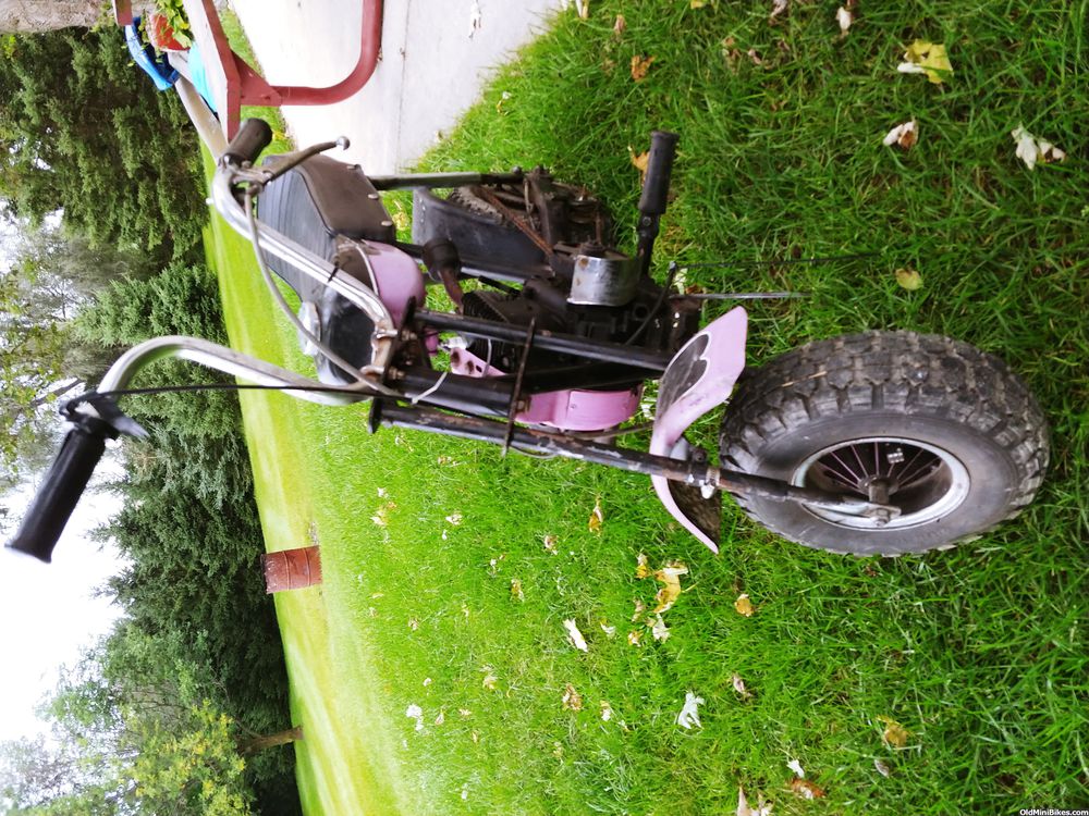

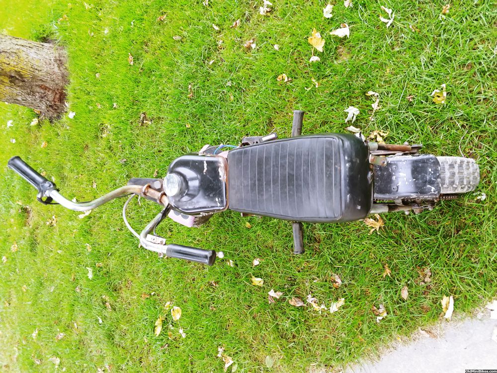

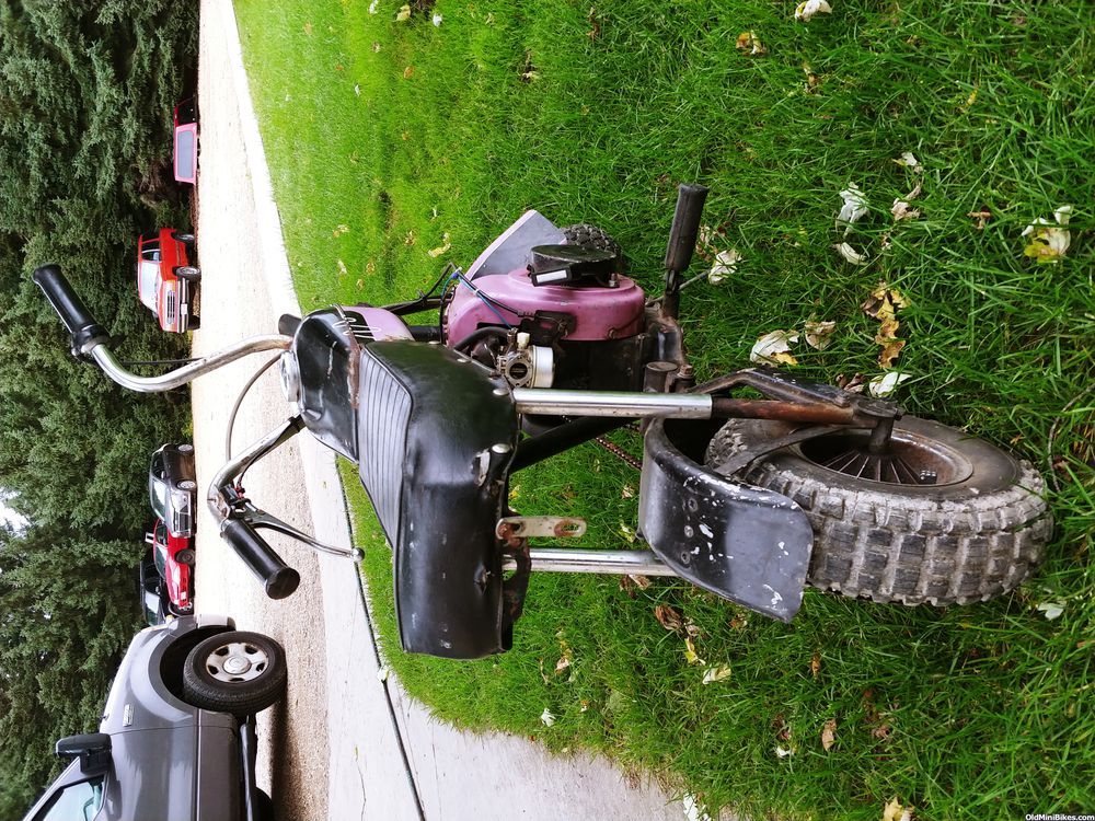

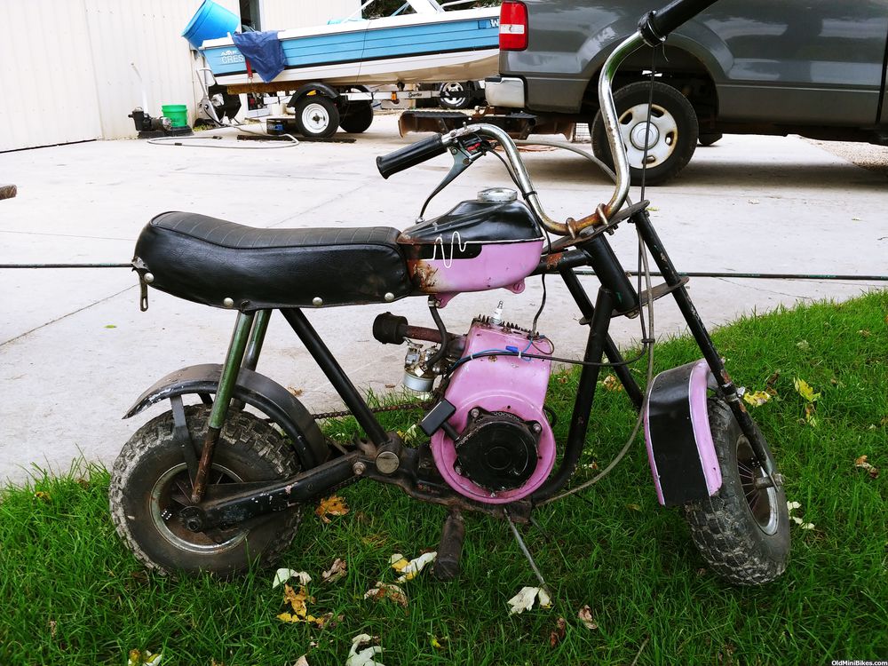

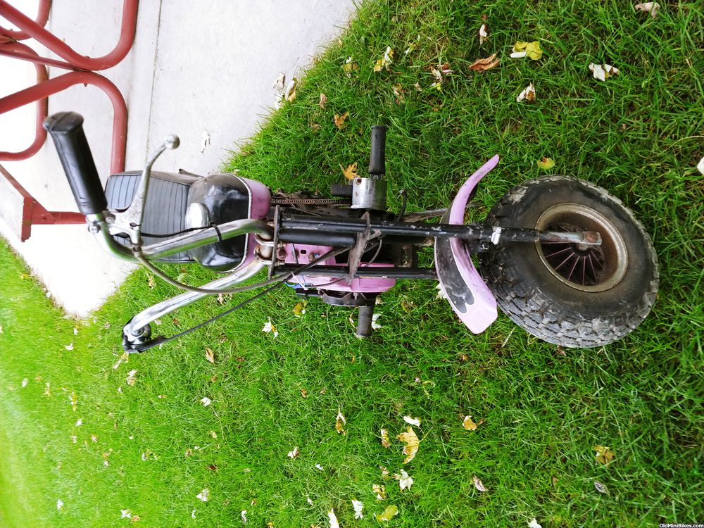

It is early but the way things been going i better get to building this bike. It is a 1970 Rupp Sprint
Randy(gumpit) gave me a deal on it and Jeff Mihalko heard about it and purchased the bike for the raffle. Thank you Randy and Jeff. Jeff looked it over and all the hard parts to find were there including the metal chrome clutch cover which is not in the pictures. Karen (Manchester1) is doing the seat for this one. I will be asking a few questions as i go. Decals , grips, correct cables and kill switch who or were can i get them or if anyone wants to donate parts or money to this they are more than welcome. Thank you in advance Rick.

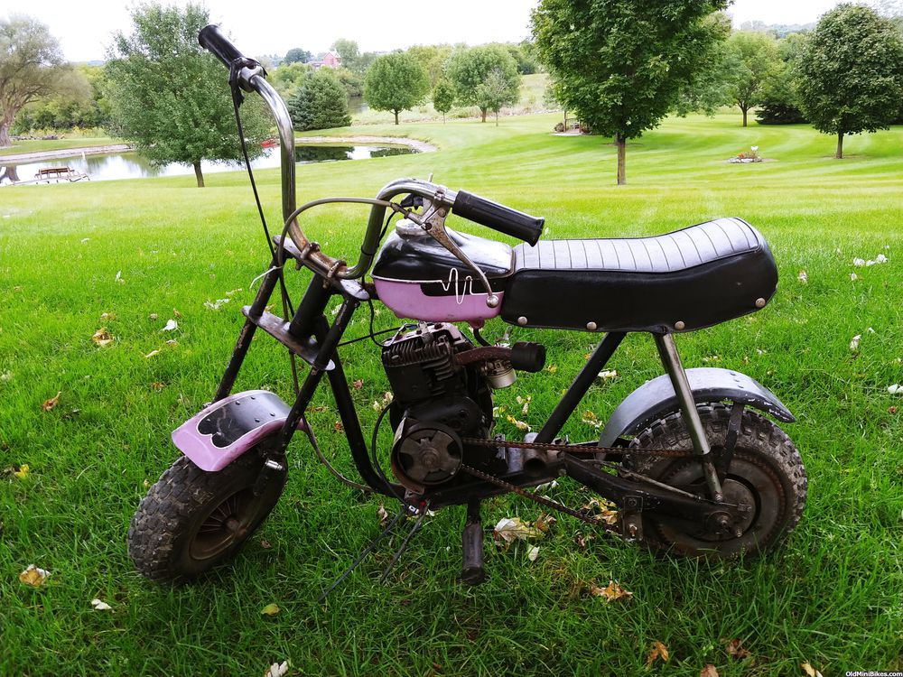

heres the bike, Kept it as low budget as we could, with hopes of finding chrome bits that needed recromed or repalaced as they come up, but "finished" and rideable.
Best of luck with it :thumbsup:
