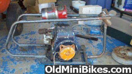

For a while now I have been watching Scottesy's Rupp Dart Cycle thread with envy...while his bike was getting the royal treatment in his mini bike "salon" ....my poor old Dart Cycle hung on the wall in a dark corner in the back of my garage . A previous owner had tweaked the neck on the bike and messed with the down tube...it was kind of discouraging because even with measurements and photos I knew it would be near impossible to get it perfect again.

So my Dart made it out there....and now there are three original Dart Cycles housed under one roof ! Maybe some kind of record .:scooter::scooter::scooter:

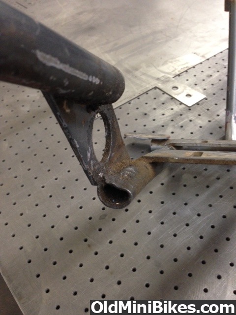

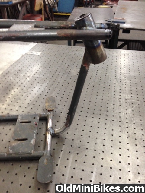

First order of business was to repair the neck.
The Previous owner had laid the neck back to increase the rake, and added an extension to the lower part of the single downtube.
Unfortuately whoever it was did some job of welding it back on...!!:doah:
This was the next update I got...
:eek:hmy:

Oh my!! That was quite the rake they had on there!! Looks factory now!! :thumbsup:

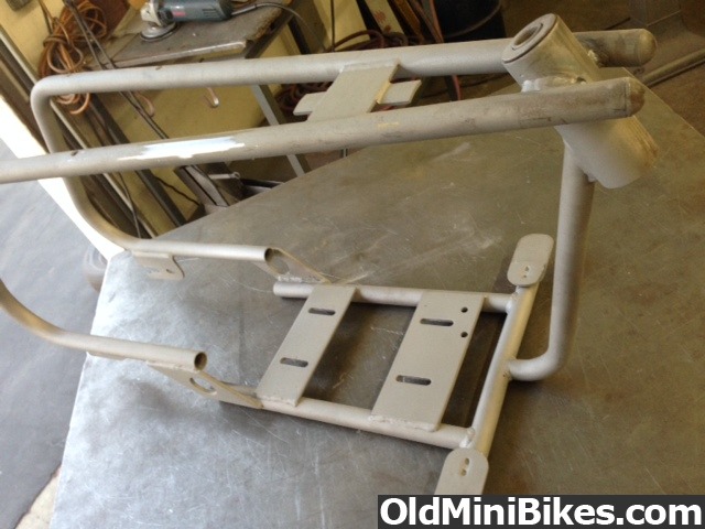

Cozied up next to the other two, he was able to transfer the measurements and massage the front end back to perfection.!!

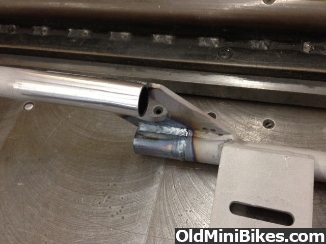

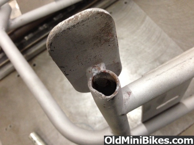

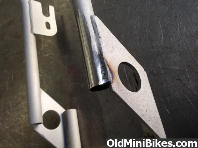

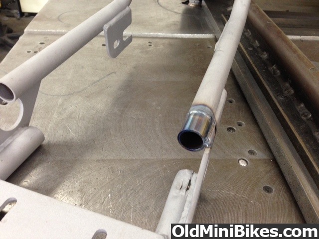

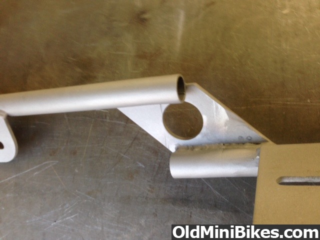

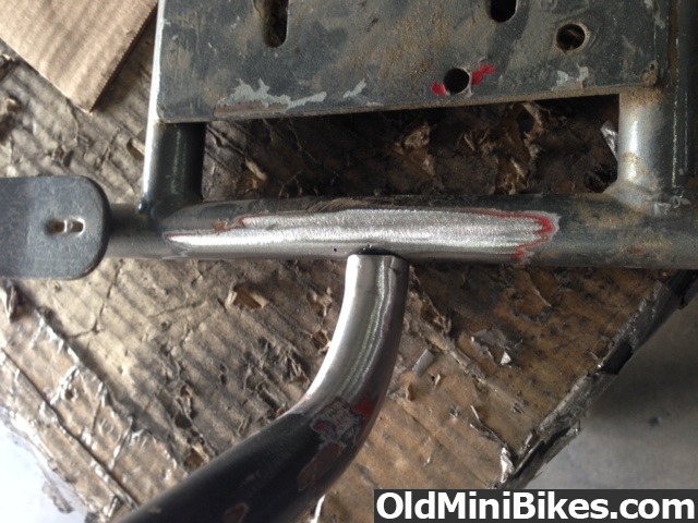

He next found a couple short sections of tubing where the frame is "Z-d".....that looked like it had purposely been flattened to allow for chain or jackshaft sprocket clearance:
He spliced in some short sections of new tubing to repair them:

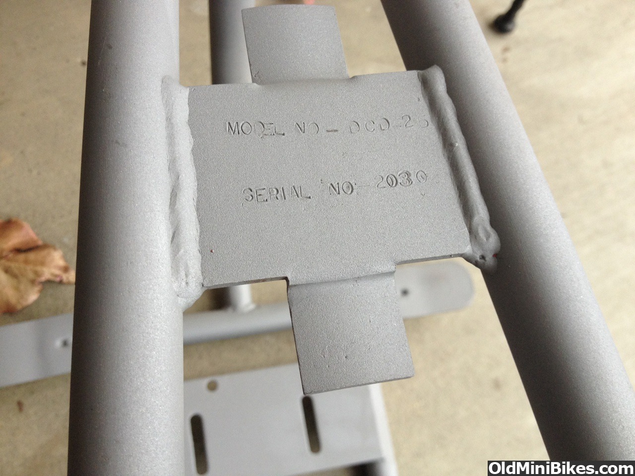

Finished sandblasting the frame...
Found a cool surpise hiding under the paint :detective:
Model DCD 25 (Dart Cycle Deluxe_ 2-1/2 HP)
Serial No 2030

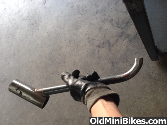

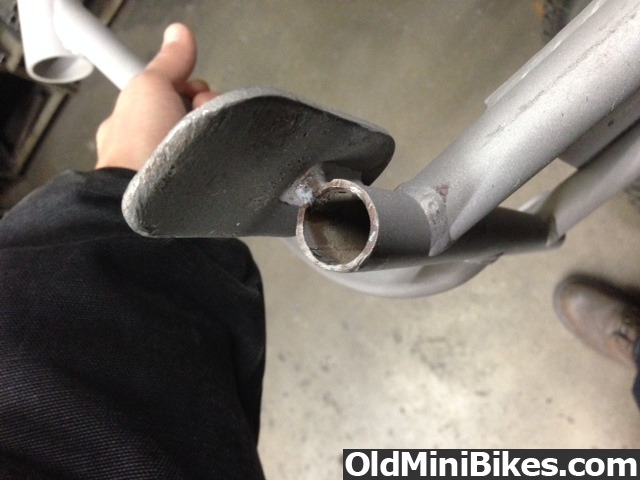

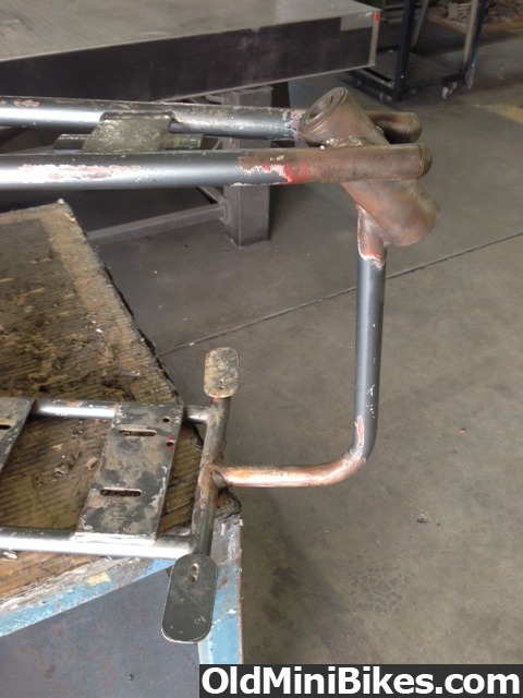

Next up...bent and crushed footpeg:
Presto..
Like new :smile:

Scott, I get how you bent the whole bar back in the vice, but how did you fix the end if the pipe...Did you massage the metal back somehow, or splice a new piece in:confused:

Gerry, there is no doubt that we would not have got this far on restoring Dart Cycles without the help of JMBmini, Ratfink, Hounddog, Karterman, and BAB. These guys have been amazing with all their knowledge, brochures, specs, and sharing. It's been a great team effort. :thumbsup:
Mark- I just tapped it back in shape. First with a smaller rod from a side angle, then I brought it back to round with a larger rod that I sanded a taper on the end and tapped it straight in.
