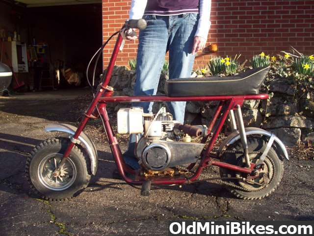

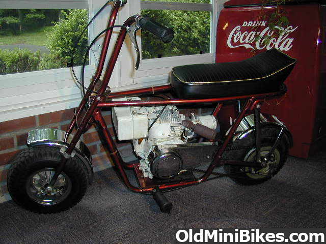

I have a RUPP Continental sold by Sears which I bought from the original owner. It has no RUPP badging or branding on it...even the back of the seat was left blank. It had a Sears decal on the shroud but her knucklehead brother spray painted the motor to "make it look better" :doah:.... I could still faintly see it....
The owner, a woman now about my age, said she and her father went to the local Sears and Roebuck in Tennessee where she lived every weekend where she pestered him to buy it for her...
1st picture is her holding the bike when I bought it..
2nd pic is what it looks like after I cleaned it up...
buckeye
